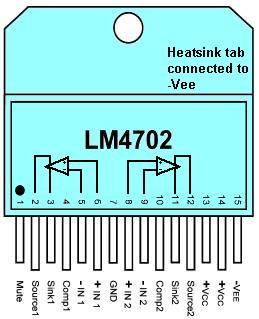

STK350-530 = LM4702?
Another revelation regarding the STK350-530 devices I have. While perusing the audio knowledge universe, I came across the very interesting LM4702 high-voltage stereo driver IC. I then realized it has the exact same pin-out as my STK350-530 ICs that I’d like to experiment with.
So, is Sanyo making their own version of LM4702? Does National Semiconductor make a thick-film/metal substrate version of the LM4702 and package it for Sanyo with the in-house P/N STK350-530? I might post this information on National’s FAQ site and see if they respond (and hope I don’t start any copyright infringement battles between National and Sanyo).
It also turns out what I thought was a + current-source lead is most likely the mute pin. Based on the connection and resistor value, the Sony amp is using the R/C connection to the mute pin as a turn-on/mute delay circuit. Again, this assumes the devices are the same, but considering the devices’ use, specs, and pin-outs, it’s a pretty safe bet.
Attached is National’s drawing.
Again, any comments, inside information, or technical wisdom from the illustrious forum members is much appreciated.

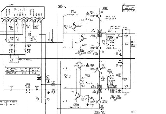

UPC2581 pin equivalent of LM4702
NEC's UPC2581 is exactly same pin-out of LM4702, and is found in many older sony stereo/ 5-channel receivers. These chips are older than LM4702. I guess national is following these ideas to create a chip that handles all the front-end of an high performance amplifier and leave the output devices to build different amplifier configurations. I know UPC4581 is pin-equivalent of LM4702 but not directly replaceable as it has different package type.
