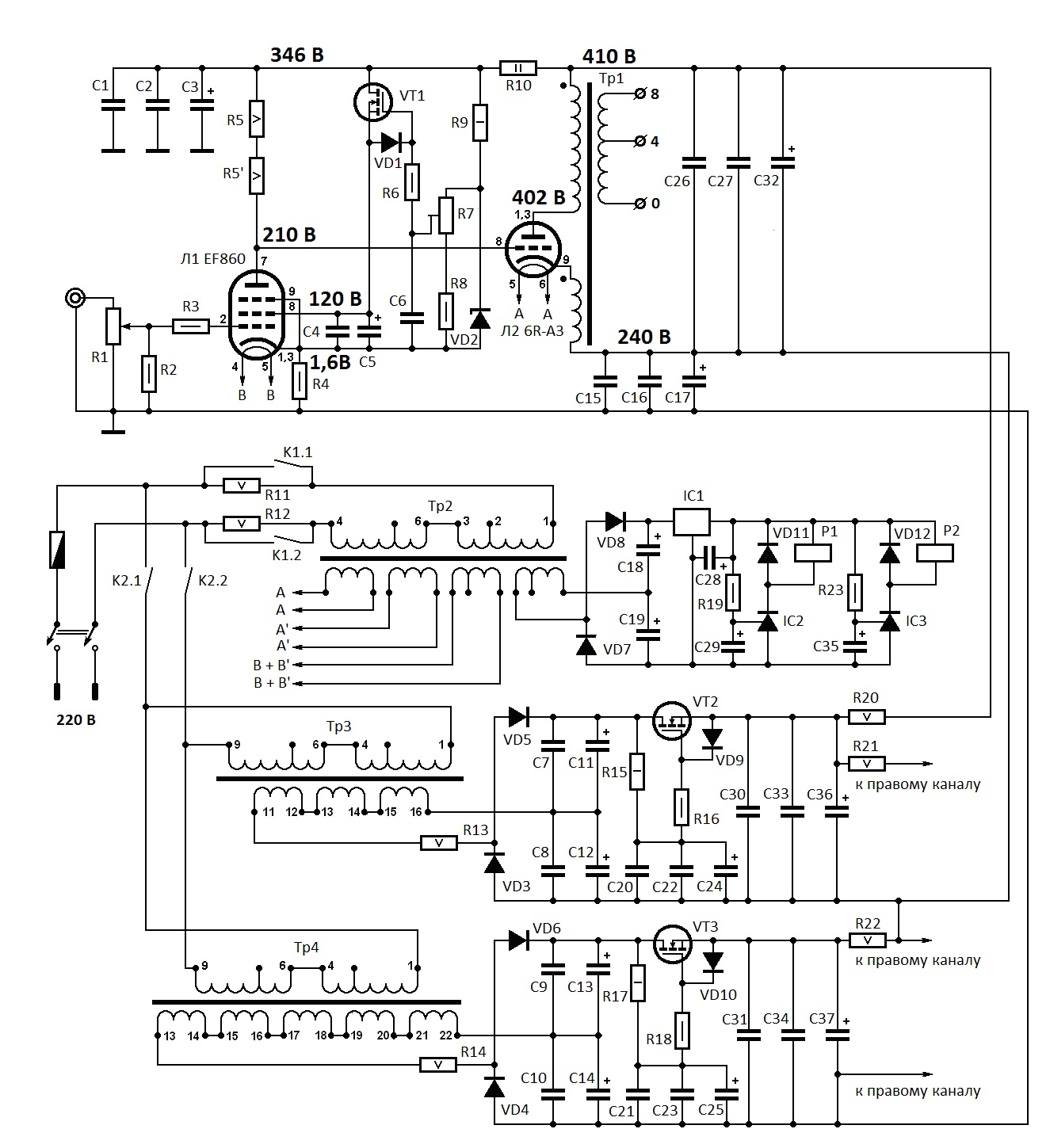

The circuit uses the output transformer to the cathode winding. Transformer can be used without it.
The amplifier has a very good sound. Instead 6R-A3 can be used 6S19P, but the sound will be a little worse.
