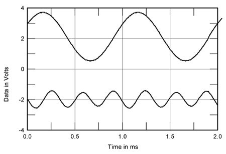

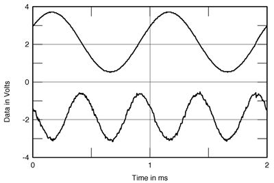

are describe various darTZeel clone versions but the diagram of the original models NHB-108 in fig 7 for distortion and noise waveform with fundamental notched out in the review under
https://www.stereophile.com/content/dartzeel-nhb-108-model-two-power-amplifier-measurements
so as the model NHB-468 in Fig. 9 under
https://www.stereophile.com/content/dartzeel-nhb-468-monoblock-power-amplifier-measurements
show an odd character of the distortion wave form;
only the lower half-wave has a sinusoidal character, while the upper half-wave is more like a triangular character (both mentioned diagrams also to see in the attached files No 1+2).
Every second half wave has the tip flattened (NHB-108) or rounded (NHB-468) in the upper area. Same diagram of attachment No 3-5 for the power amps Halcro DM38, Graaf GM200 and Pass Labs Aleph 4 don't show such an effect - lower and upper half-wave show identical character (clean H2 resp. H3 on Halcro's DM38).

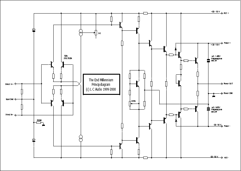

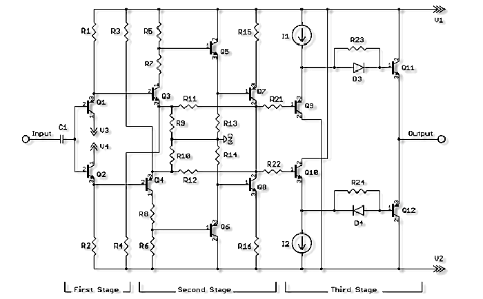

I haven't heard the models NHB-108 and NHB-468 from darTZeel, but - as long as it is not a measurement error on the equipment from Stereophile - there is anywhere a deficiency in the circuit design which is also audible - so I think (go to the simplified schematic from attached file No 6 resp. to https://6moons.com/audioreviews/dartzeel/108.html) so as to to the various other schematics from attachment, which have a certain similarity in terms of the input stages and due the fact, that only local (serial) feedback (and no global NFB) exists regarded the "End Millenium" from LC-Audio (go for the circuit description to
https://www.octave-electronics.com/lcaudio/temil.shtml)
Where is to find a circuit description in detail for this topology from darTZeel ?

I have done some measurements on my clones, and as soon as I move the distortion measurement to the 'driver side' of the outputs base resistors, there is basically no distortion, so my conclusion is that almost all the distortion is generated by the output transistors.
In simulation, the diodes across these resistors rarely conduct, only at extreme currents.
Rather weird if there is much common behaviour between the original 108 and the subsequent amps. The original consisted of a NFB voltage amp followed by a pretty standard diamond buffer, the rest were all simple EFs with a slightly different front end. All of them with really high distortion.
The strange shape implies that the output transistors are having difficulty turning off. The base resistors are very large, 27 ohms from the schematic referenced in post #2. There are no emitter resistors. I am putting this design in the "bad" category.

By "the original" i meant the 108. It is the only one based on a diamond buffer, all subsequent Dartzeel amps (to the best of my knowledge) have been simple push pull followers with a Vbe multiplier. Not even an EF2.
I find it unlikely very dissimilar output stages to have an almost identical distortion quirk.
