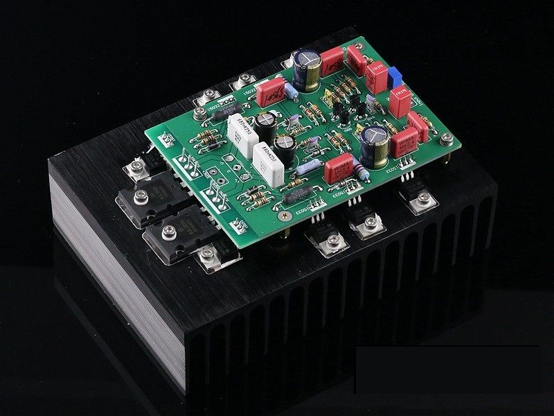

Anybody have information/have made this kit? Post here, please:
2 Sets Assembled No Global Feedback Audio Power Amplifier Kit Based on NHB 108 | eBay
Regards

I've bought this two output pair version, they have been mounted to my heatsink and tested, I am getting all of my tapedecks into working order and building a plinth for my Lenco before I get my amp projects finished off:
A Pair DC 35V 55V 470uF 100V 200W 200W Superpower Amplifier Board vs Dartzeel | eBay
Mine will be using an old Bel 1001 amplifier case/transformer/heatsink so 40V rails, I have read the design has low PSRR so will probably add LM1083 regs as opposed to the massive amount of filtering per rail used on the original design (66mF per channel per rail)

Low PSRR, high output impedance and poor damping factor. The Stereophile test measurements did not look great. I'd be really interested to hear what you can squeeze from these.
These criticisms do not relate to the sound quality...... cf. a Single Ended Triode has appalling figures but the sound is out of the world.

Compared AB to LM3875, it sound wider, more open, vocal sounds clearer and much more bass. But SCNP upgrade capacitor does not work properly. Unable to set output voltage to zero. I think its due unmatched transistors. All transistors PNP NPN pairs need to be perfectly matched.

That pcb contains two DC servos, almost the same circuit is the one in Salas DCG3 preamp.

The seller claims that transistors are picked up with an accuracy of 1%.
It is the truth or deception?
Somebody bought this kit of dartzeel?
Прямо к карлик dartzeel NHB 108 пост усилитель купить на AliExpress
What exactly are you asking? If someone has bought the boards, desoldered all the transistors and tested them? 🙂
The seller could have published at least distortion data, or given some information about the transistor selection: what parameter and under what conditions. Why don't you ask them?
My clone was built with random transistors from Mouser. Measured THD was almost double the figures in the Stereophile test.

The seller assures that he selects transistors, but does not want to send a photo.
In the photo it would be visible transistors are signed or not and thus to check the words of the seller.
Therefore I also ask whether dealt who with this kit\seller.
Seller from aliexpress matching transistors to sell with the kit, it is something unheard-of and in my experience quite laughable assumption. Particularly, when seller not providing any information on what exactly is matching, and how did he do it. I simply wouldn't pay attention to such claims.The seller assures that he selects transistors, but does not want to send a photo.
