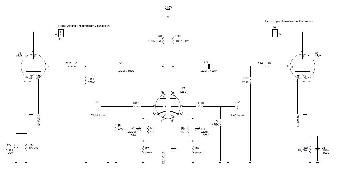

I know that changing coupling caps can make/break the sound. What resistors/caps can i upgrade to improve the sound on this circuit. Thanks.
replace C1 and C2 with 1Uf 630V Solen or 1uf 400V Musicap. Stay away from Wima's.
Heater supply is very important to adress. take the heater supply, do not directly ground it. instead, take a .1uf cap and go from heater ground to dc ground. never use a laptop power supply as this will induce its noise on the heater which in turn will be amplified in all tube stages. I never really use the dc heater method other than circuits that are battery powered. of course it wouldn't be hard to make a charging circuit for a battery then the unit is off and then run the heaters off of a battery.
