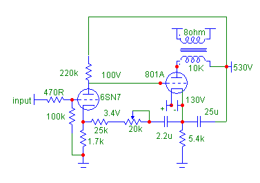

I think this is not far from optimum (with my present components)with a 6SN7 and 801A. The factor is about 5. It's on the margin for a 2VRMS input, but would work fine with my source.
I ordered some wire for the transformers. Now have to rig up an old sewing machine for winding.
Sheldon

Sheldon,
What's the voltage rating of the 2.2uF cap?
TIA,
-- josé k.

Chb voltage rating
Originally #46 posted by Sheldon
It's at the cathode potential of the 801, so about 130V. I would use something rated at least 200V.
Sheldon
Hi Sheldon
:att'n: Pull the 6SN7 and measure the voltage drop at the cathode resistor of the output triode.
This is the minimum voltage rating for Chb.
Make sure that the resistor is able to handle the power dissipation.
Kind regards,
Darius

Thanks Darius
Ah, right. I could do that safely with the resistors I have for the project (5x5W 27k in parallel), but I see your point. C2 needs to be rated nearly the full B+ for full protection (or, the compensation resistors become fuses).

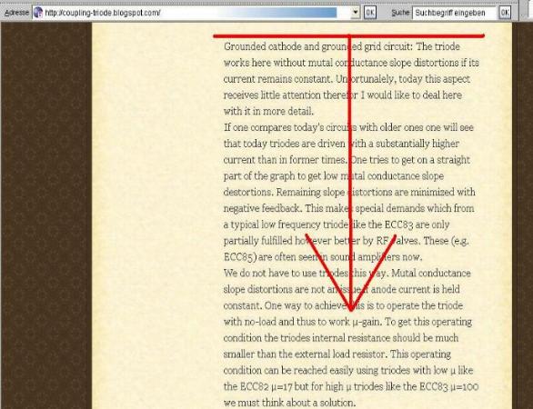

triode self linearize factor
Hello,
please read this text :
http://coupling-triode.blogspot.com/
Grounded cathode and grounded grid circuit: The triode works here without mutal conductance slope distortions if ... By this methode the triode can be operated linearly without applying negative feedback and this is the way that I have designed the RIAA 2007.
This important aspect is covered by the formula, too.
It is a "self linearize" factor for a triode stage.
Kind regards,
Darius

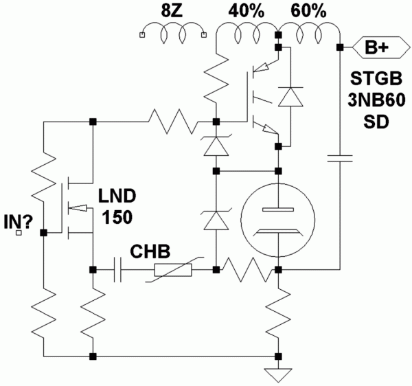

IGBT " Mu Starver" may provide a near linear gain for
Mu, but the Vacuum Diode transfer function gives us
Triode law X^1.5 "Plate Resistance". Last I read, the
Vacuum Diode was still considered a Tube? My symbol
for Vacuum Diode may not have been legible as such.
There was none in LT-Spice, I drew the best I could.
This stage with the real plate is the only gain stage.
My depletion MOSFET in the input stage? OK, you got
me there. No tube, but it was only intended to have a
unity gain with low impedance, once all resistors have
been scaled accordingly. Call it an inverting follower...
Unity gain followers are nothing new in this thread.
Without this very low (or at least very stable) driving
impedance, the Mu Starver in the next stage may not
be as accurate.
CHB you say is not relevant due to the MOSFET? But
my circuit has full anode feedback, should respond to
power supply noise at the anode, just as-if a Triode.
Not the high impedance PSRR of the usual FET Drain.
Same theory of operation as O.H. Schade (RCA 1938)
6L6 (Screen not strapped to Plate) Triode emulation.
With a PSRR no better than an emulated triode with
Mu=1, CHB seems very relevant here. Have I missed
something?
Your Triodelington does indeed look interesting, and
might be the simpler circuit. For one or both stages...
But relies perhaps too much on the thermal stability
of Beta... Any local feedback to stabilize the Beta also
messes with the behavior of the Triode... IGBT might
be more stable and linear substitute than BJT here.
Might still need to rely on an unbypassed cathode
resistor to sample a voltage for the gate.
Not yet sure how I would take feedback from the OPT
to linearize my iron with the Triodelington?
