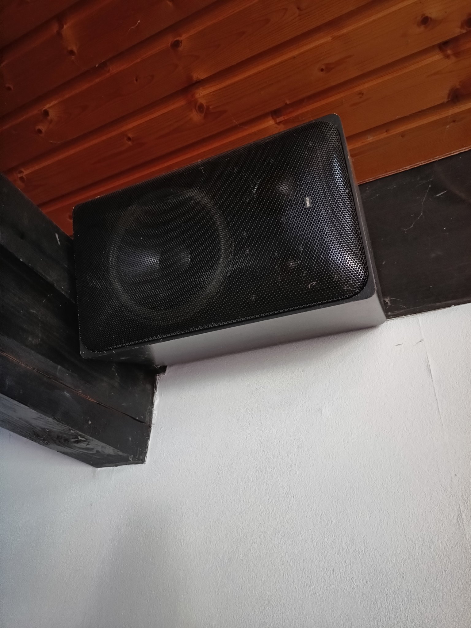

The midrange dome has some kind of protection, I think a light bulb heating up and a fuse. Not sure which model had what. Also, for the large speaker the middome was build differently from the smaller models. They knew the limitations of their products all too well.
I knew all these rich peoples Braun speaker quite well in their time, not one of them impressed me. Not even with some of the strongest Japanese amps of that time.
I still use a modified pair SM1003 for rear speaker (horizontaly, tilted, high at the wall, like often seen in studios). They just lack the kind of life dynamic you get from any well made 1"+6" two way today. You can turn them louder, but they still stay boring, some call it "neutral". To bad their is no neutral music, only test tones are. I try to stay objective, even with things I own or build. Really no desireable speaker, except for the clean design.
These are the Studio version, which are a black. coarse finish. Inside identical to the consumer version. Previously owned by the music director of a German FM station (Radio Bremen).

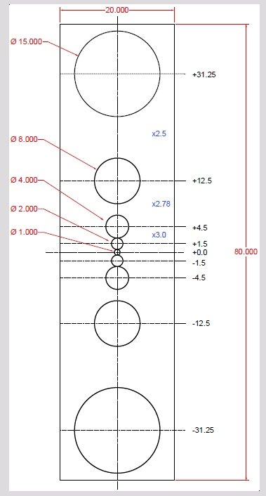

If 137mm C to T: Putting a 160mm OD midrange and butt against a 60mm OD tweeter would result in 90mm distance or about 65% of the xf wavelength.
To make it 1/3 requires 45mm distance center to center. Obviously not possible, would result in a 60mm midrange OD and 30mm tweeter OD.
you could use a small fullrange driver as "tweeter", crossed over low. that would allow a max mid-to-mid center spacing of 2/3 crossover wavelength as claimed for an actual d'appolito configuration.
