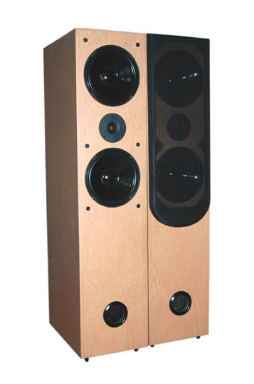

D'Appolito theory
Minimum spacing
The highest crossover frequency you can use when lambda <= 13520/ crossover frequency.
Therefore if you choose 2000 hz as your crossover point then the maximum separation between tweeters centre to eithers woofer centre is 6.7 inches.
Keep the distance from one woofer to tweeter equal and same goes for the other.
Check out my design, it shall give you some insights
good luck

Oh yes. I have seen FRD and ZMA files when I was checking out Speaker Workshop. But to get the impedance plot as a text file, I will have to measure the driver, right? I will ask Corrson if they have it. That will make things a lot easier.
About the distance, I want to crossover at 2500Hz. So that will need about six inches (which is what I plan to keep) between the centre of the woofer to the centre of the tweeter.
Vivek
I have calculated a centre to centre distance of 5.2 inches corresponding to 2600Hz, which is the crossover frequency for my MTM projec. Now, I have to move the tweeter about 5cm to the side so that the 5.2 inch criterion can be met. Is this okay?
Vivek
Can anyone tell me how low the Vifa D27TG-05-06 can go. I was suggested an XO by a friend and he suggests 2100Hz as the crossover frequency. Can the D27 go this low? I am making an MTM system with the D27 and Vifa TC18WG48.
Thanks,
Vivek
