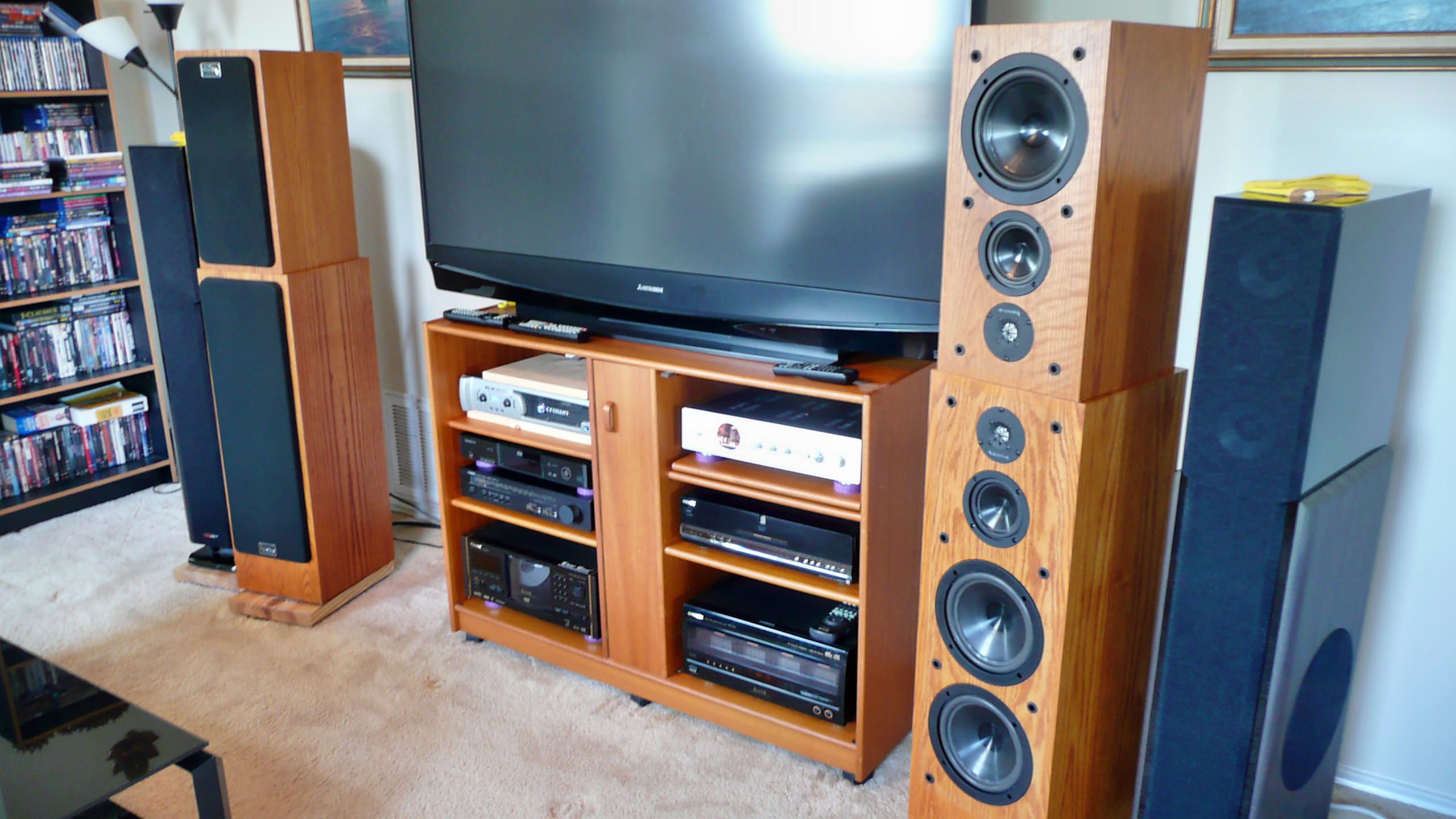

Here's a pic of my contraption. The reason it's NOT a D'Appolito array is that there's no tweeter in the center.

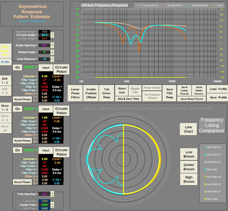

D'Appolito arrays use a specific combination of center-to-center spacing, crossover slope, and crossover frequency to create a forward lobe. Basically it does a crude approximation of a single point source speaker with directivity above the crossover point. About an octave below the crossover point, the directivity disappears, and the speaker is completely omnipolar. This may explain why D'Appolito arrays are well-known for delivering "thunderous bass." The mid and high frequencies have directivity, and the lows do not, so the low frequency response is highly affected by room dimensions and placement.
Here's a simulation. In the midrange octave, response falls by as much as TWENTY dB as you move above or below the speaker. This isn't a subtle difference; it's like reducing the amplifier power by as much as 99%! So this is a huuuuuuge null in the midrange.

Above are a few simulations of the speaker. In the sims, we can see the following:
  • In the top pic above, I've simmed the off-axis response in five degree increments. It confirms what Smith said - it's within 1dB. (It *does* fall off above 15khz, due to the tweeters directivity.)
  • In the pic below that, I've modeled the Snell using the same parameters as the D'Appolito array. We can see that they both have suckouts in the midrange, but the Snell doesn't vary as much with angle, and it's much gentler.
  • The thing that I *really* like about the snell is that it's at least 3dB down at 30 degrees off axis across the board. It doesn't take a lot of directivity to reduce off-axis reflections, so even a 3dB reduction is VERY audible. I didn't bother modeling the eights, but Smith uses them to control directivity down into the midbass. If anyone would like to model that, the crossover points, slopes, spacing, and diameters are all in the Stereophile article.
  • The very last pic is Stereophile's measured response. It's 100% consistent with what our sims show us. There's a dip at 2khz, and the tweeter's response is narrowing rapidly above 15khz. This is a nice confirmation of the power of the FRD simulator.

Compare this simulation that I did with the measured response of David's speaker:
See how closely they conform? (Note the narrowing of the polar response at 2khz in both graphs, and the droop at high frequency?)
It's definitely an array. Even better, the FRD tools do a nice job simulating this.
I think the most interesting part of the data is that it demonstrates that you need VERY tight spacing to get a proper wavefront. If possible, you'd want to get the drivers within one half to one quarter wavelength at the crossover point.

Experimenting with my Infinity Crescendos, I have found this to be really good sounding. Better than either one solo. They are 9' apart and I sit 9' from them, but it still sounds great three rooms away.
