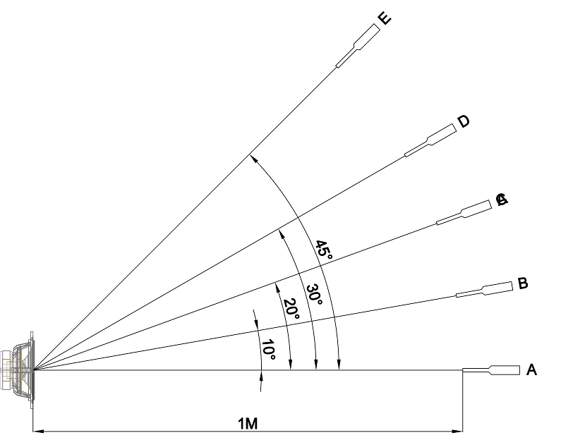

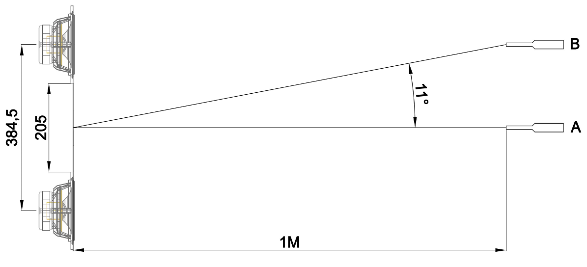

Next Step was to find Out how an MTM Measurement looks like Vertical and Horizontal.
For the first Approach i used my build 2 Way Speaker and put them together:

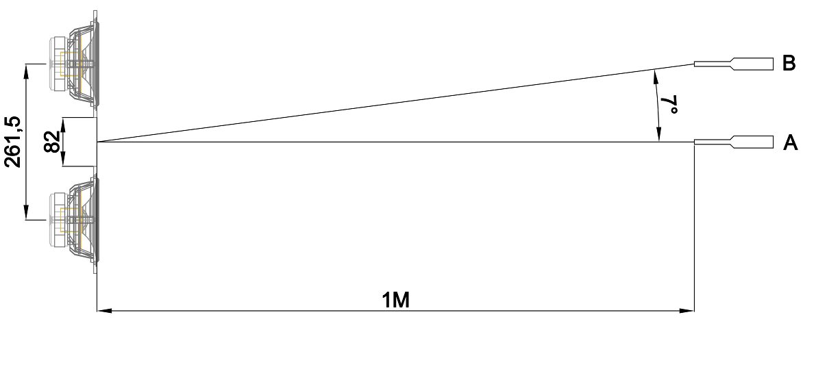

The Distance between the Middriver here is around 261mm Center to Center

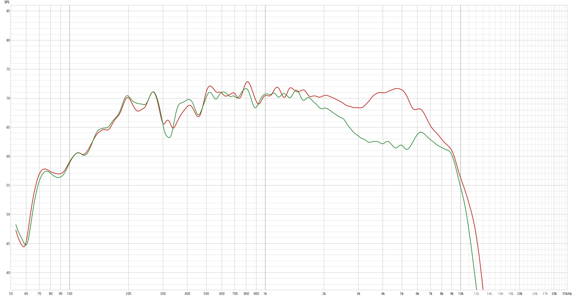

Vertical i Measures This Way:
And here how it looks (Red line Microphone @ Point A, Green @ Point B):

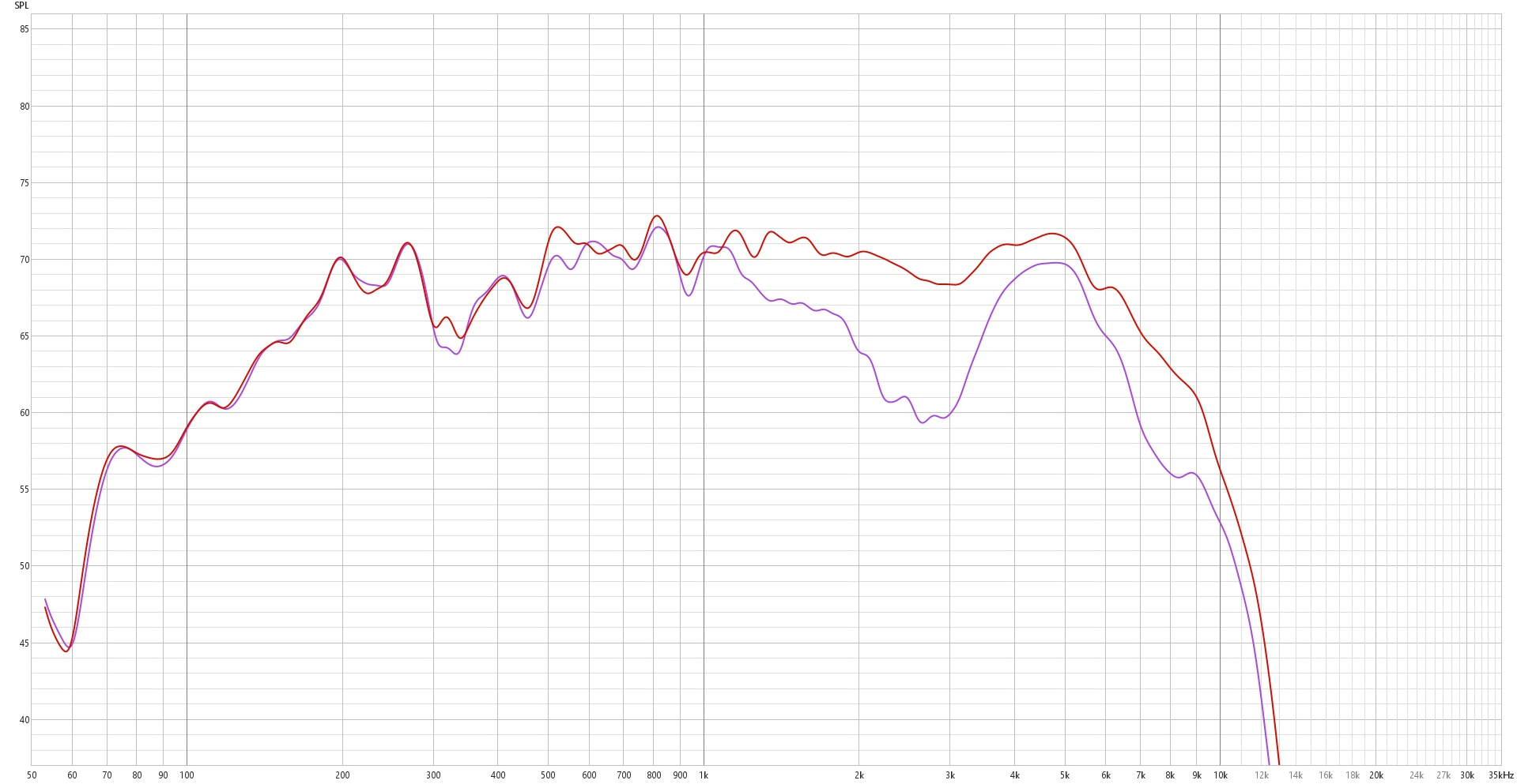

Here the same Measurement with an greater Distance between the Middriver:
And the Measurments (Red line Microphone @ Point A, violet @ Point B):
Verticaly it is bettter to have the Driver Close togther, spcialy for an Corsoverpoint of 1800 to 2000Hz! I would say.

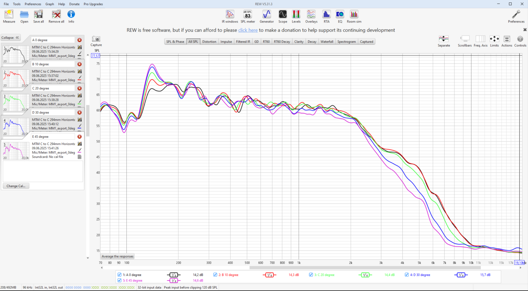

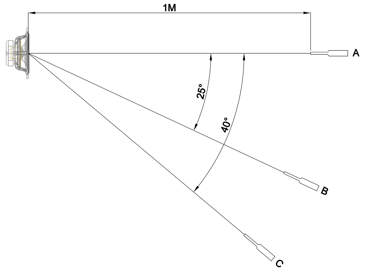

How i measured it Horizonta (Distance MTM 384mm Center to Center for worsed case scenario):
Here you cac see the Horizontal Measurings magenta 0degree, red 25degree and black 40degree:
So i would say Horizotal i could easy use an 2 kHz Crossoverpoint, Verticaly its more difficulty.

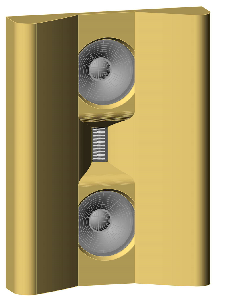

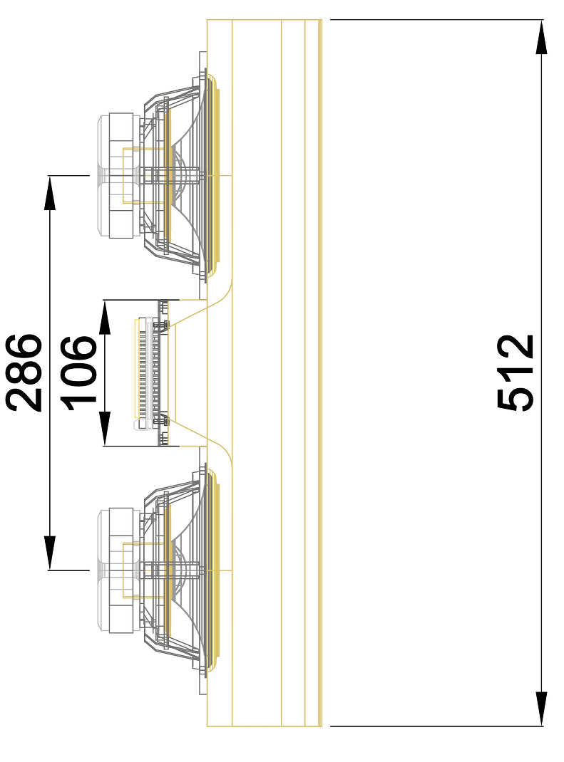

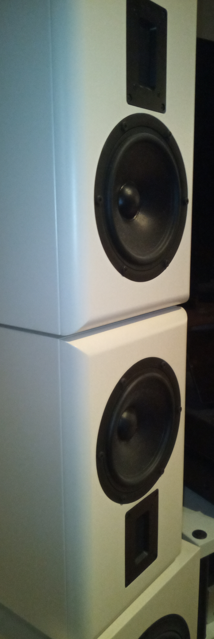

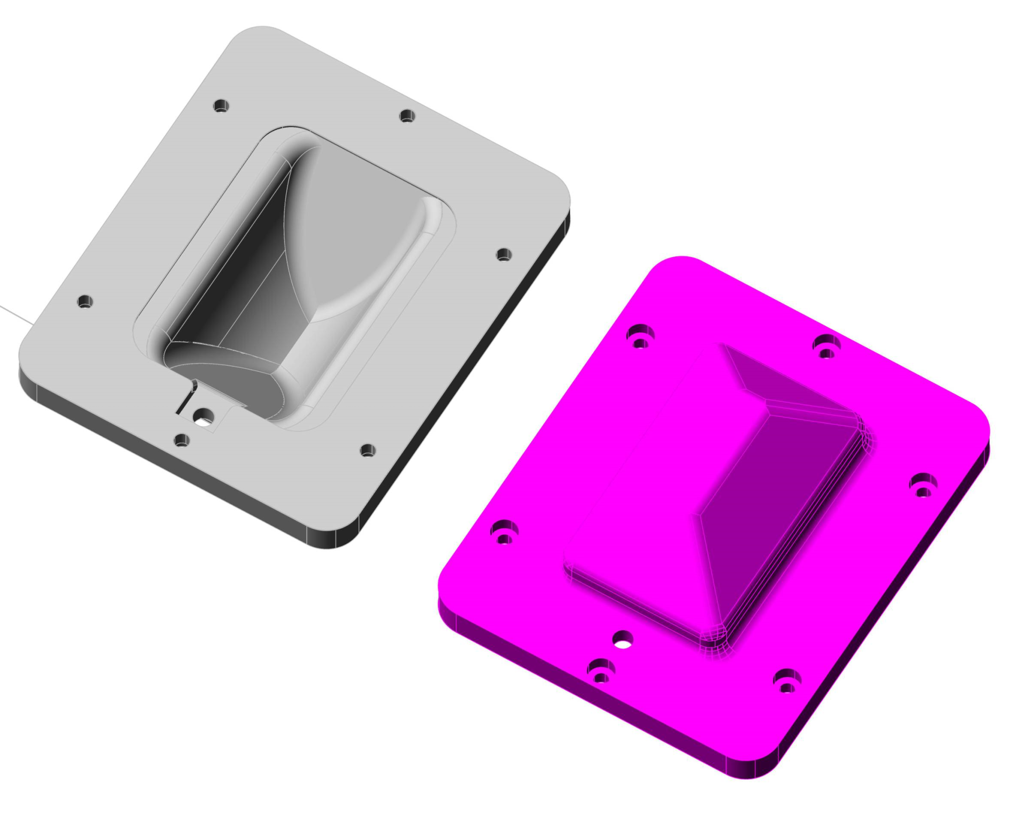

My Design aproach goes this direction:
How wide the Window off that Waveguide would be on the Middriver i need to check. thats only an guess on the Picture!
I will 3D Print that shape off that Waveguide and test it on one Middriver for first Aproach.
The Distnaces between this Middriver on that Picture:
Not to Far i would say 😉

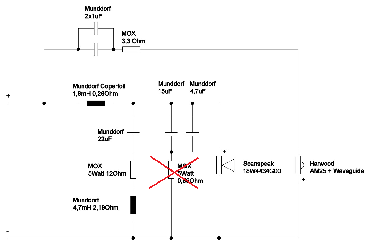

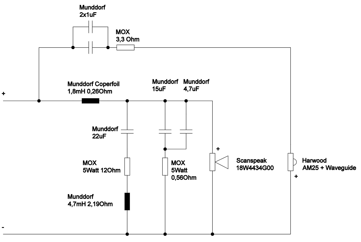

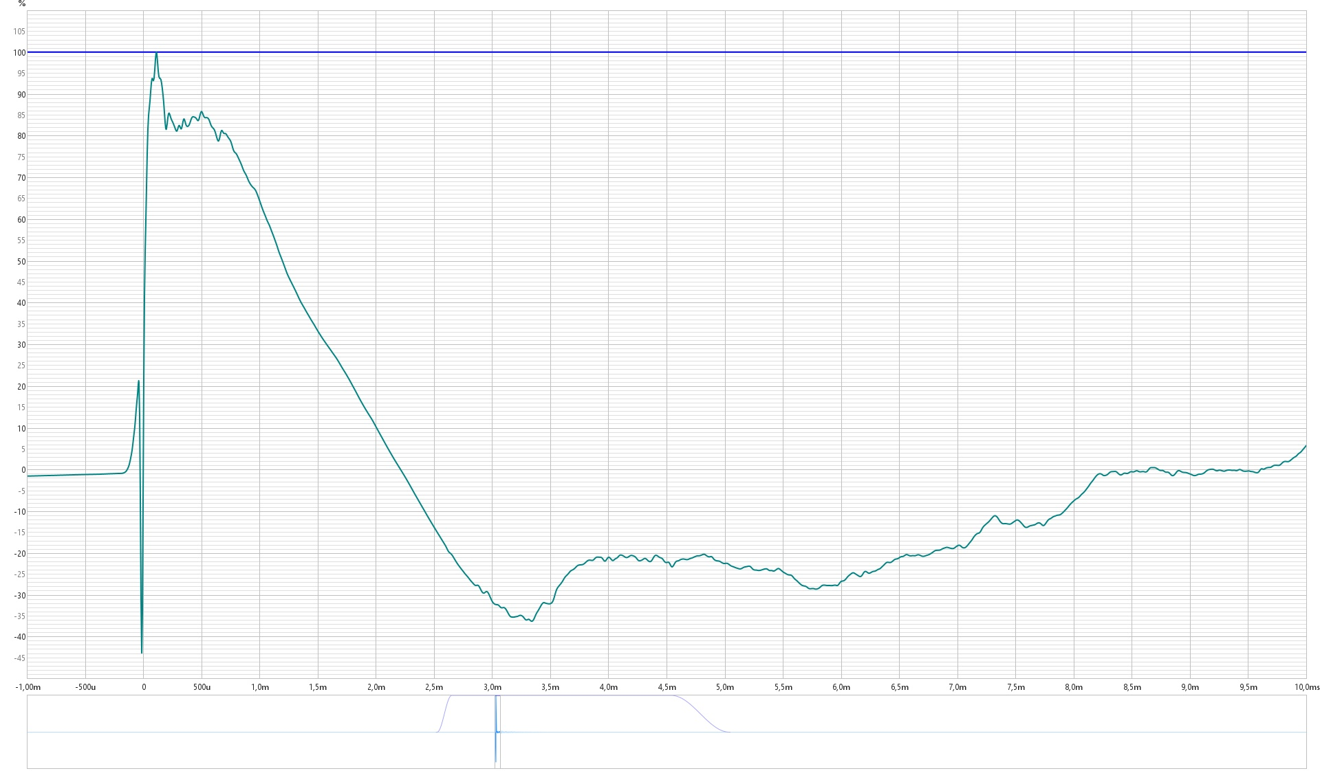

Yesterday i made an better passive Crossover for an 2 Way Speaker with my Waveguide and the 18W4434g00!
Measuring 1M Distance, 1,1M from Ground:
Stepresponse:
Crossover:

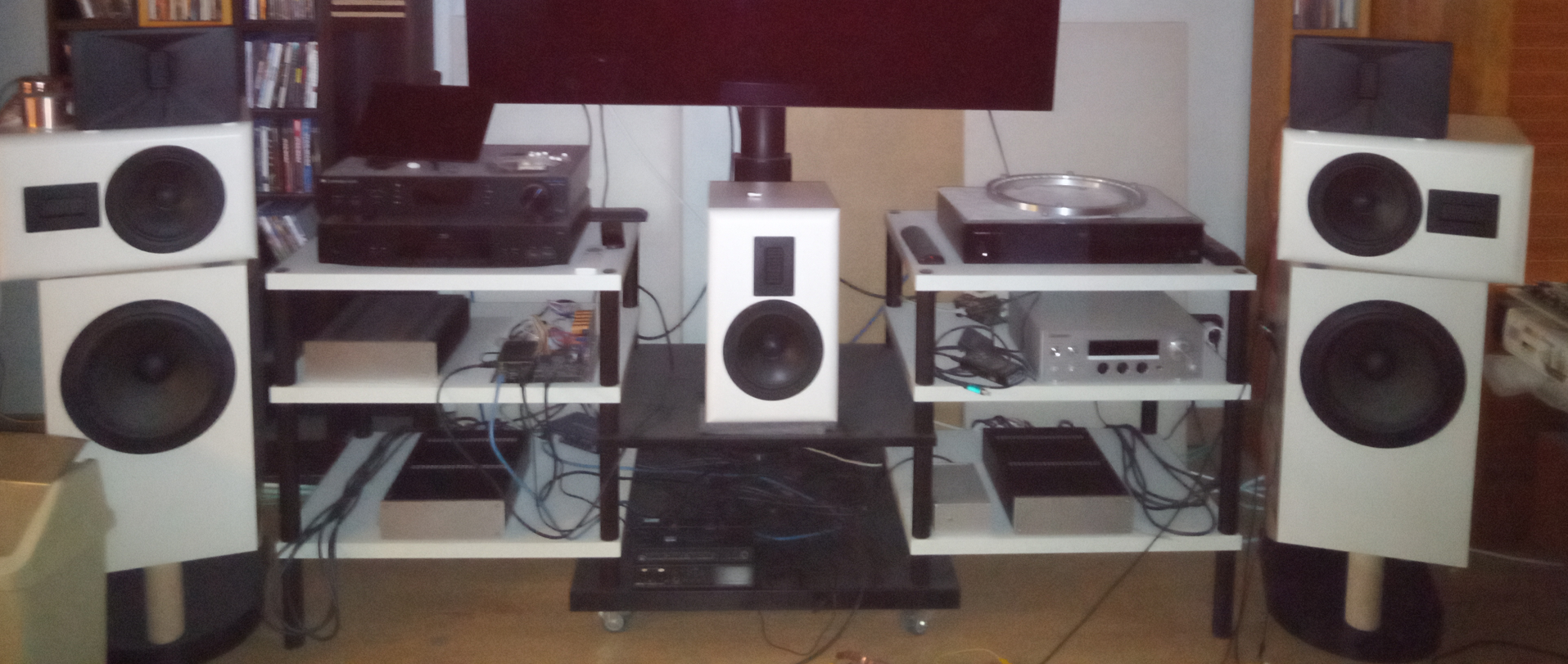

By the Way, my second Waveguide is done and i did last Afternon a lot off Listening with this Crossover and i was realy blown away how good it is.
Used my Old DENON POA800 and it was already not that bad.
I need to reinstall all my CamillaDSP stuff, so no aktive listening for now, did the mistaker to update the Raspberry to last UBUNTU and now my both Aplication (CamillaDSP and Squeezelight wont work 🙁 ) Need to go into it again LOL
So i could use my HYPEX NCP Amps with MOTU Ultralight MK5
Subwoover wasn't aktiv while Listening!
My Brother in Law was listening to day and he was also blown away, how open it was also much Room and fast Timing on Percusions and Drums.
And never aggressive or Cold!

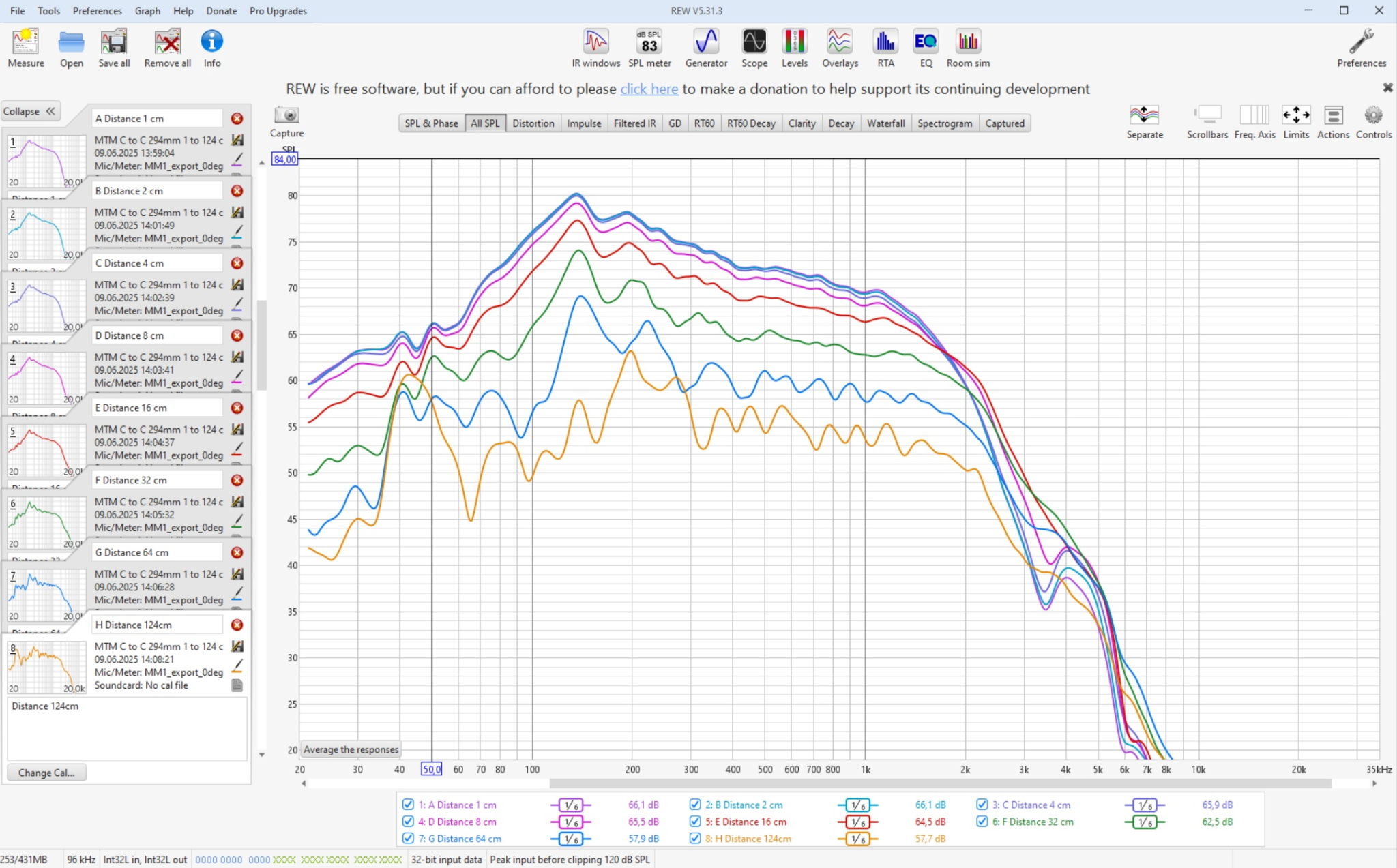

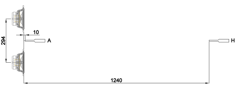

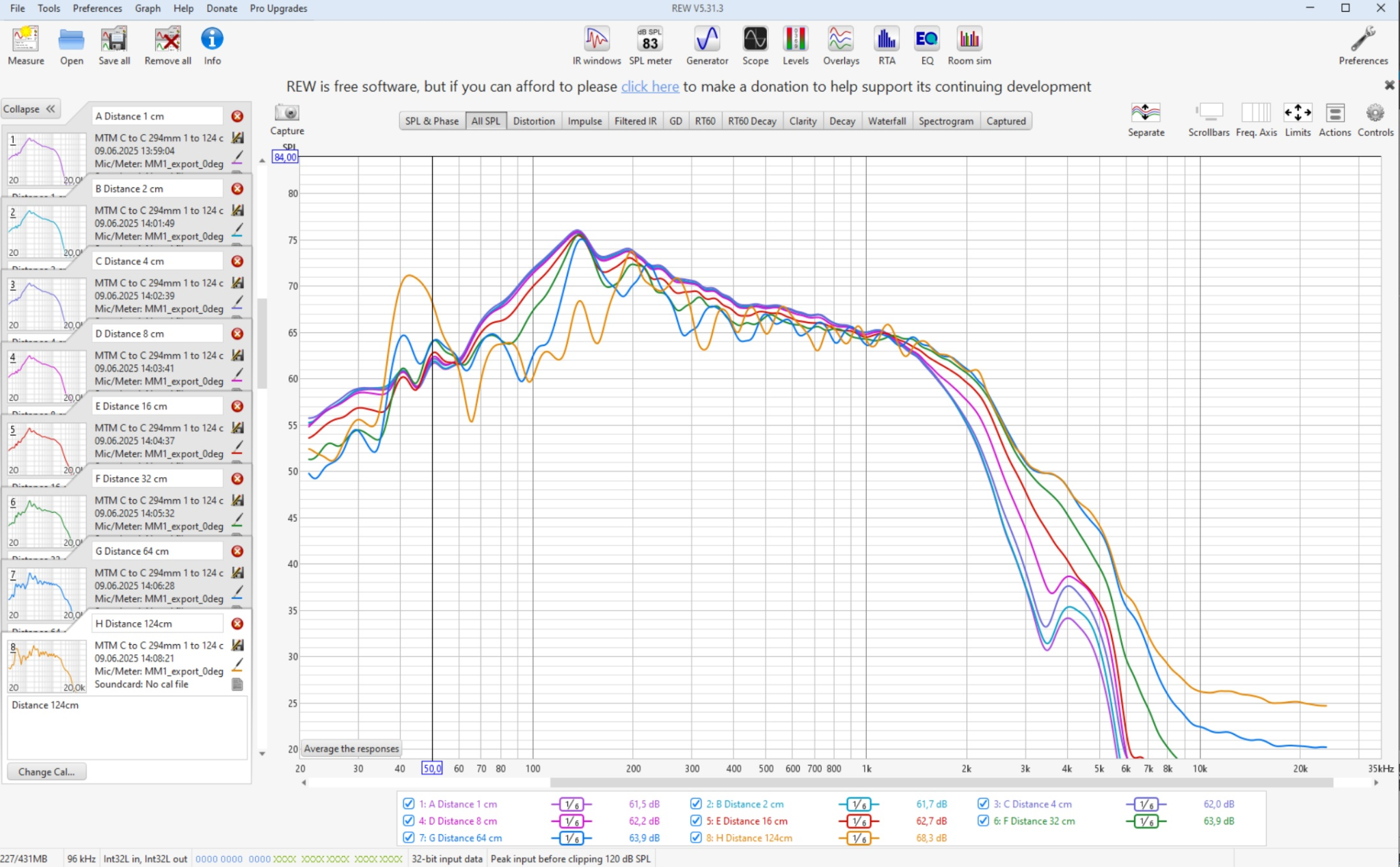

So did my next Measurments, Crossover apllied and Distance changed from 1 to 124cm, Center 1,1M over Ground.
Crossover got an little change, i guess this Resistor didn't do much so i removed it.

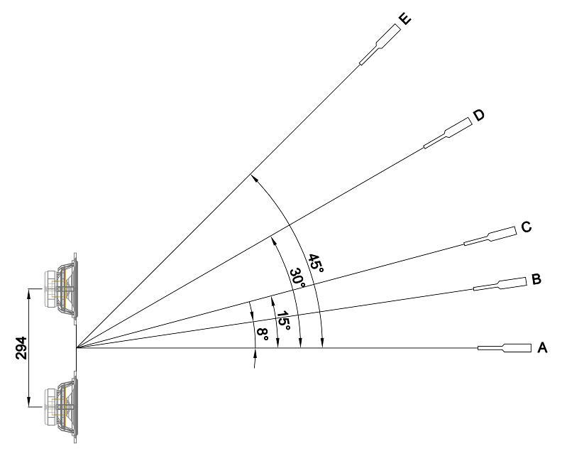

Moved the Center's of the Middriver to 294mm, thats +6 mm from my targed design:
Measurment, SPL not Aligned:
And measurments SPL Aligned:

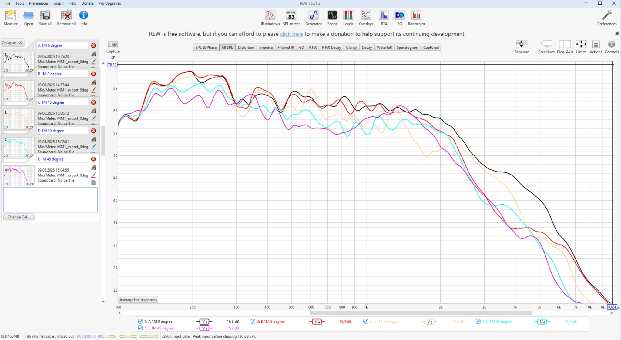

Horizontal Measurments 0 to 45 degree with Crossover @ 2kHz (12dB Passiv):
And the Results:
I would say thats not Bad @ all and would work very good with passive Crossovers as well.
But the Crossover point is moved a bit, up to 2,3 kHz -6dB in MTM Configuration.
And the Results:

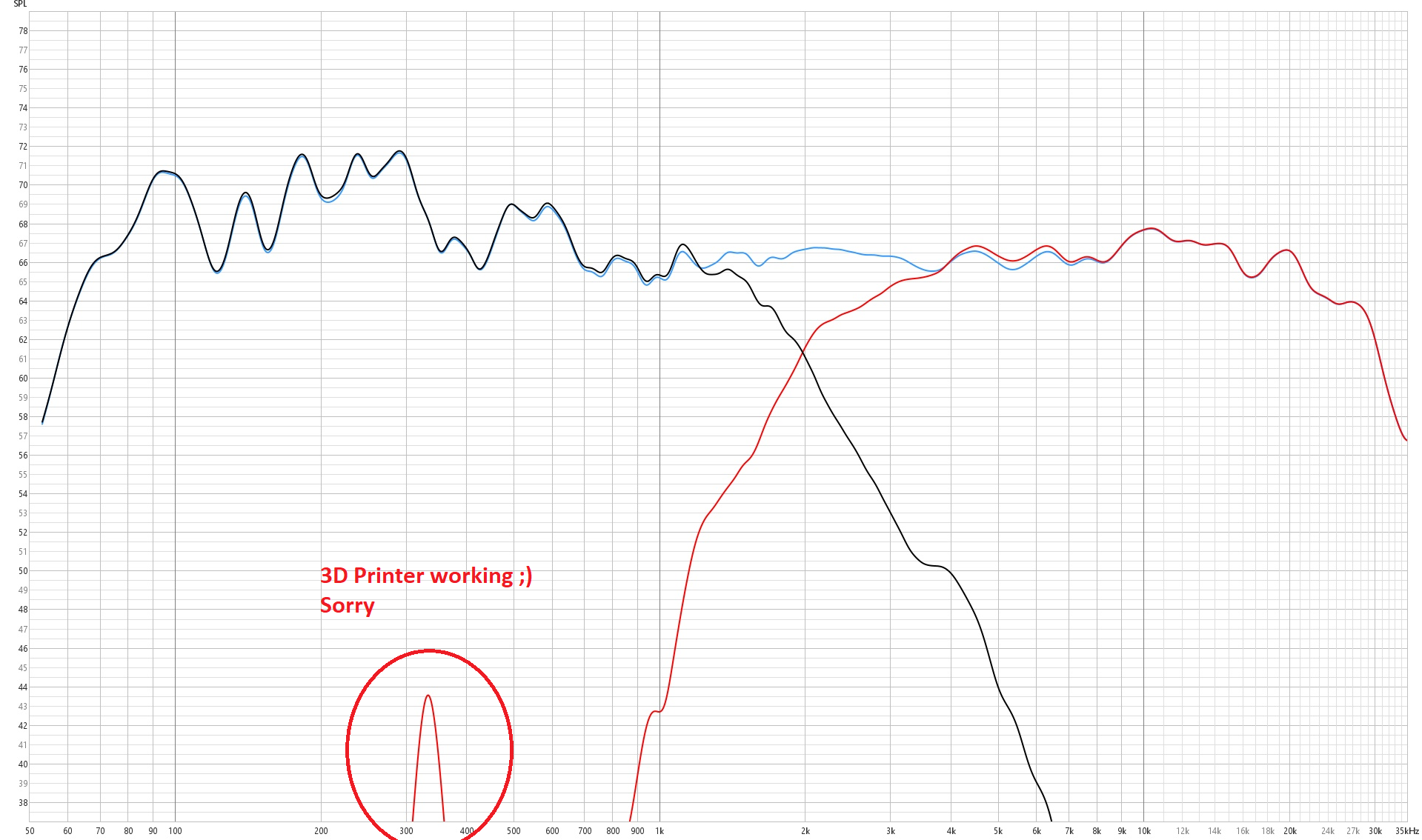

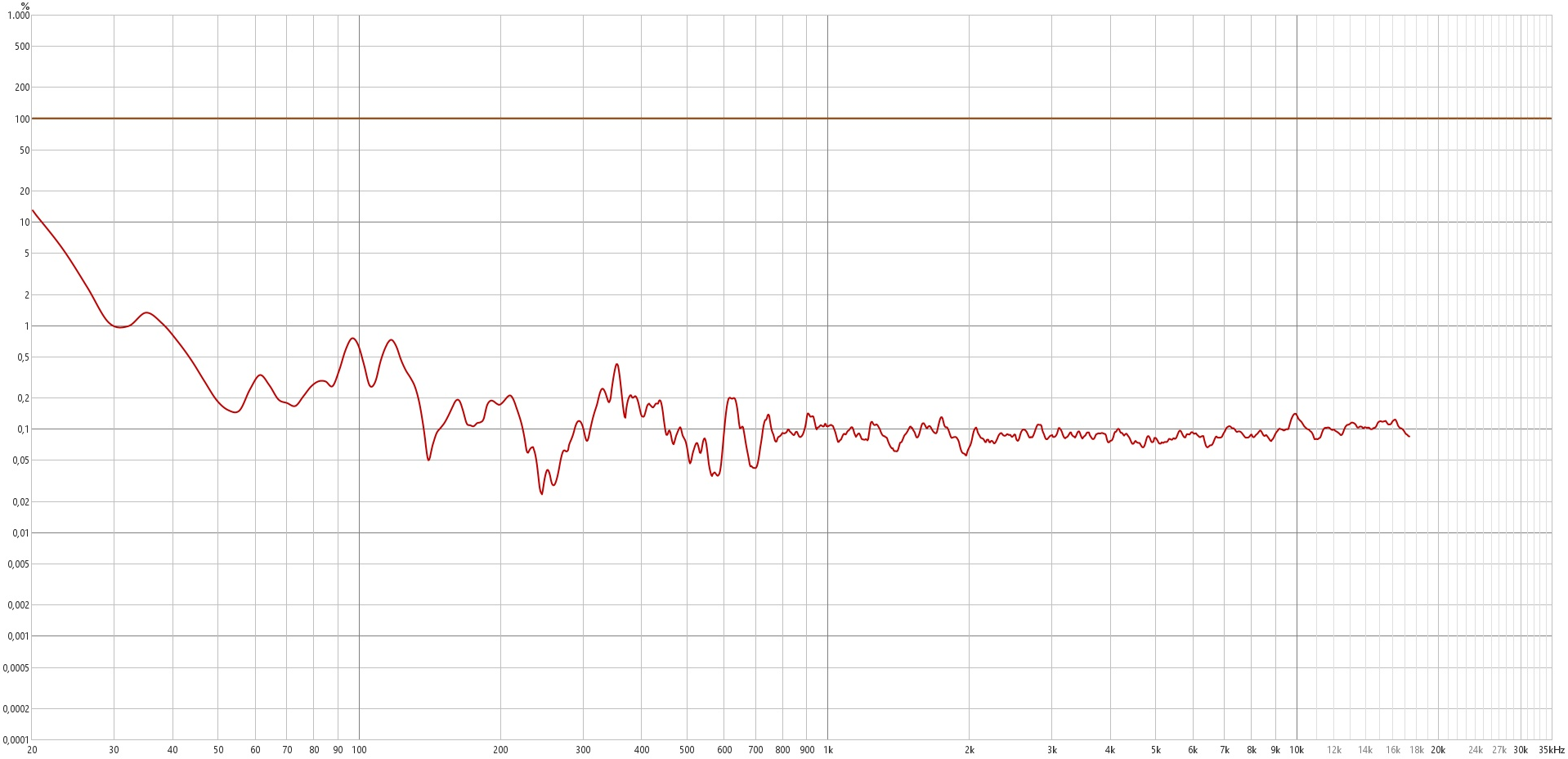

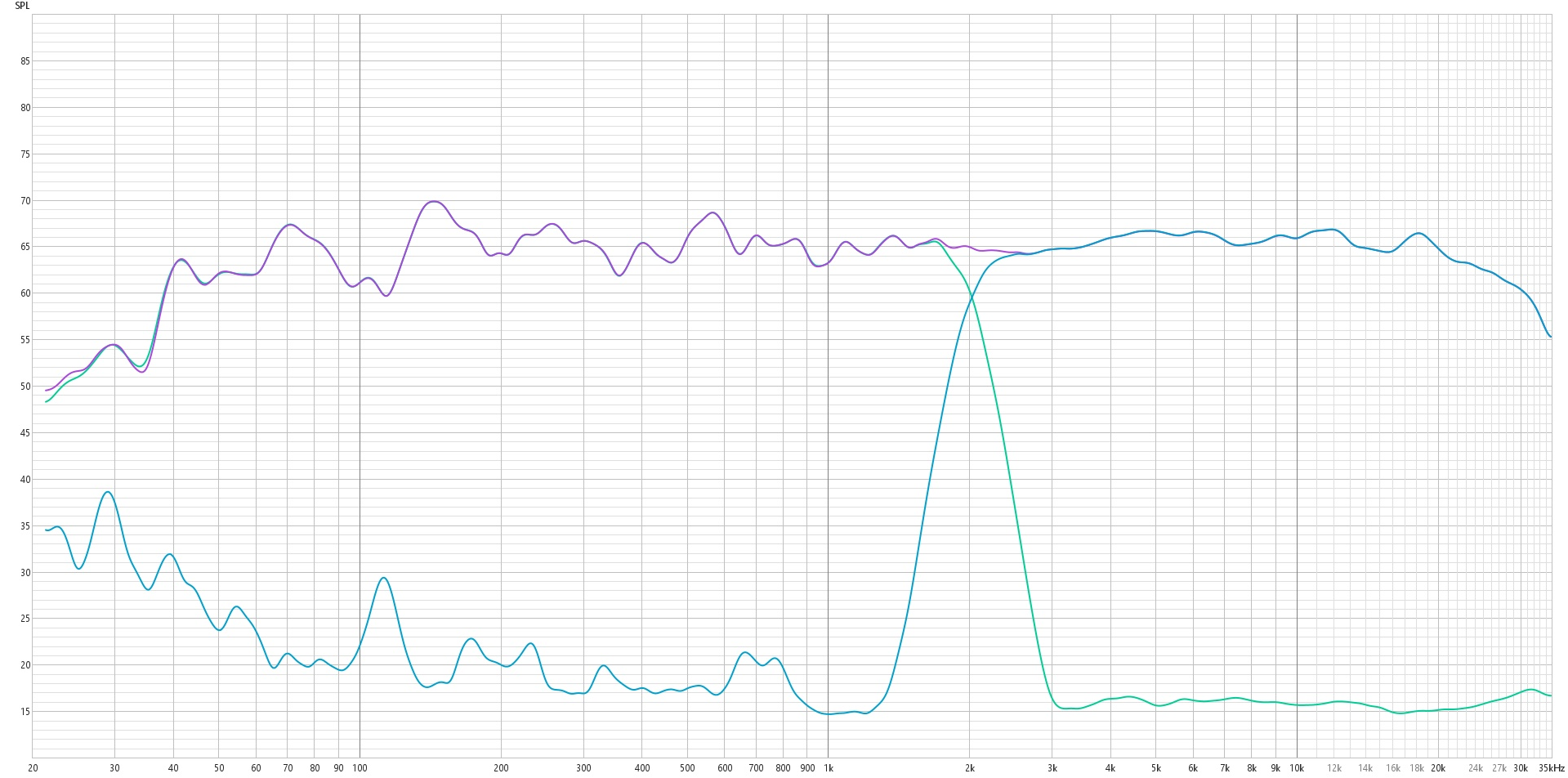

The last day i could reinstall my CamillaDSP System and this day i could listening my 2 Way System with Waveguide full aktiv with Hypex NCP Amp's
Measuring quick and dirty 😉 (not perfekt):
The noisefloure is -50 db around Crossover point to signal, so i guess i could easely go to 1800Hz Xover, still away from 1 kHz Resonance with the AM25
FIR Filter LR 96dB !!!
The sound was much Cleaner and i hear deteils in my Musik i never heard befor i guess 🙂
I am satisfied by sure 😉
Distortions down to 700Hz also much better, than the Middriver and my Room kicks inn LOL:

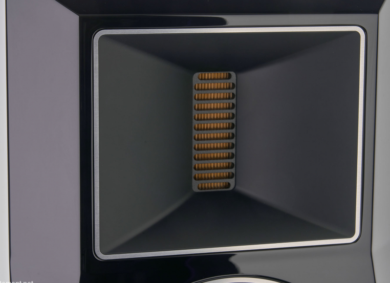

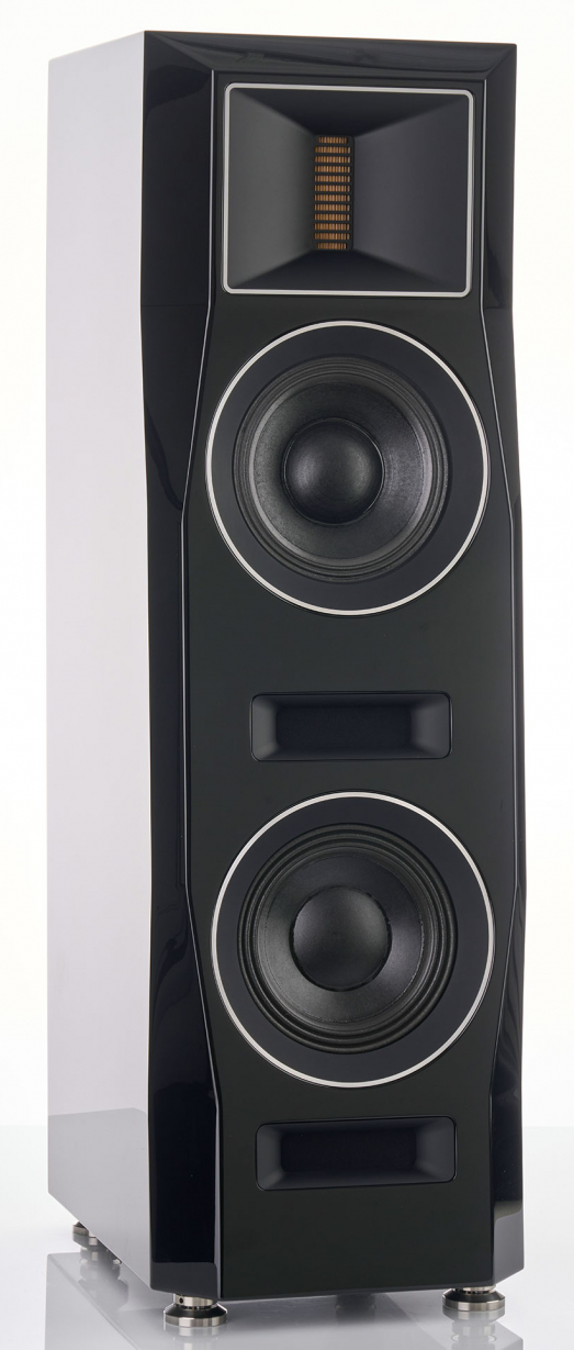

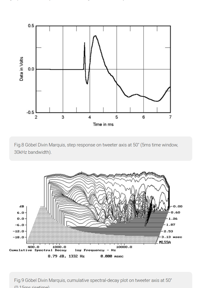

Found out the Company Göbel use also an big Waveguide on an AMT:
https://www.stereophile.com/content/göbel-high-end-divin-marquis-loudspeaker-measurements
For an 89000€ Speaker i didn't find this realy sport on:
But Stepresponse looks like normal 3 Way Passiv Speaker i would say.
Spectral decay i don't like also much 🙁 think about the Price!!!

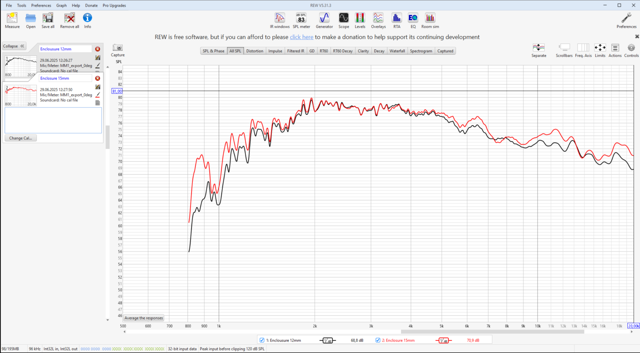

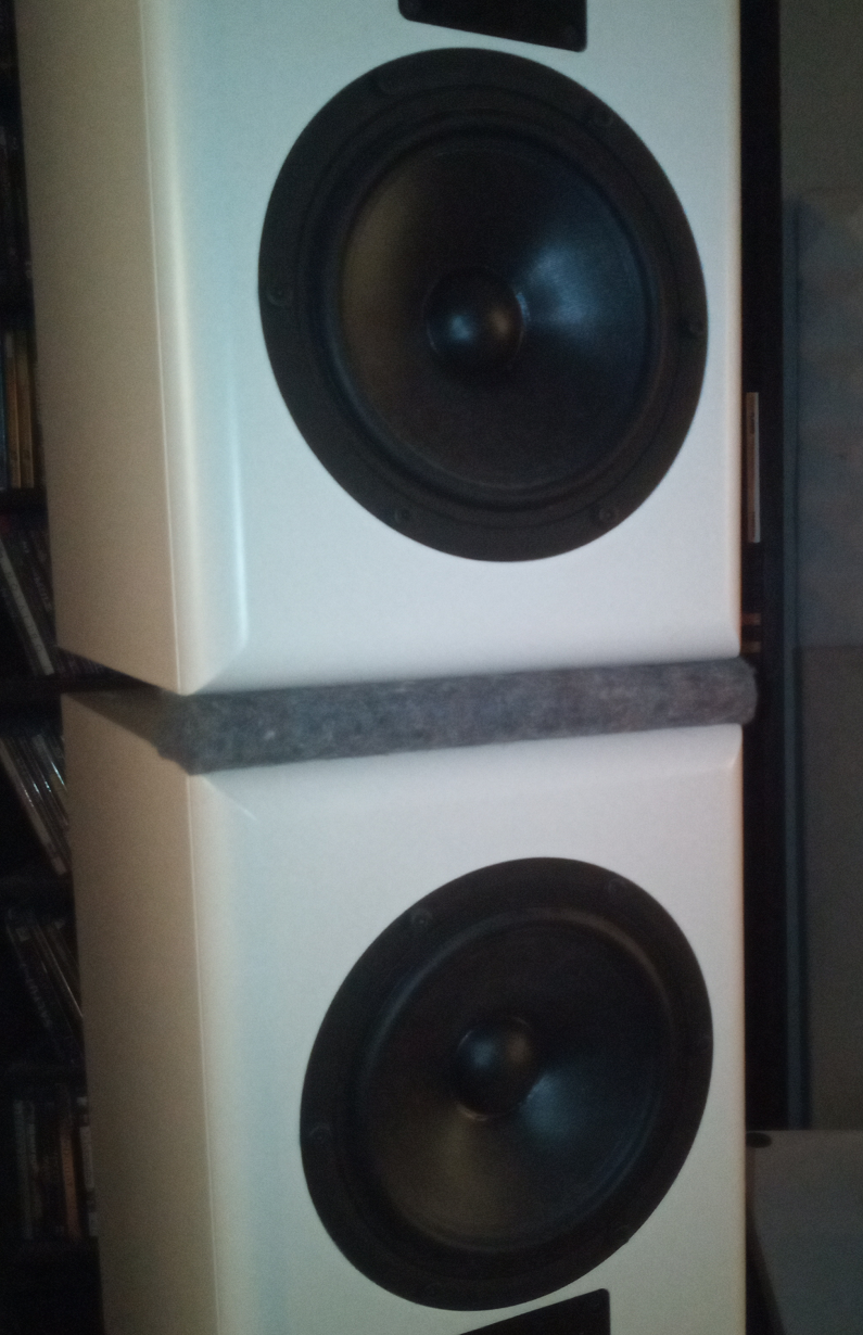

Did one more Test with my Waveguide build and an biger Enclousure 15mm Deep.
Compared 12mm to 15mm deep Enclousures on AM25 with Waveguide fillet completly with Felt:
I would say better to stick with the 12mm Enclousures on the AM25 Waveguide!
15mm would makes more Problems around Resonancefrequencie.
The Measurement shows two different AM 25 in the Same two seperate Waveguides for each, with 12 and 15mm deep Enclousures.
And i was Replacing the Speaker for Measuring so that why i guess there some diferencies between the two AM 25 around 6,5 and 11,5kHz
