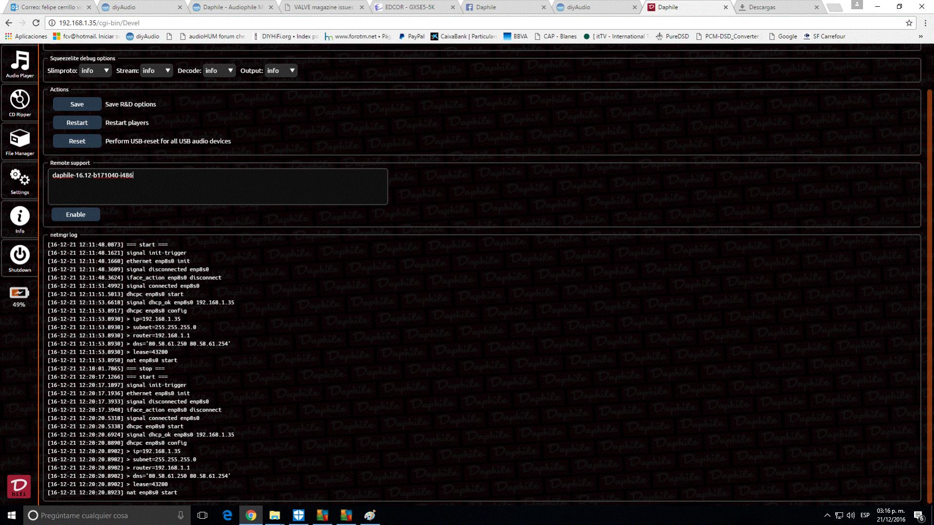

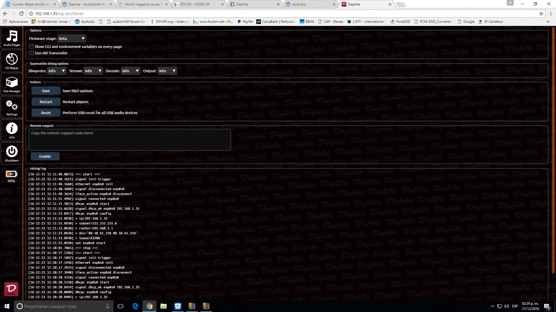

I have problems with USB 2.0, I'm using the latest 32 bits firmware but when write http://192.168.1.35//daphile/cgi-bin/Devel the answer is "404 Not Found: daphile/cgi-bin/Devel"
The devel directory would be 192.168.1.35/cgi-bin/DevelI have problems with USB 2.0, I'm using the latest 32 bits firmware but when write http://192.168.1.35//daphile/cgi-bin/Devel the answer is "404 Not Found: daphile/cgi-bin/Devel"
What's the required ISO?
Is this one: daphile-16.12-b171040-i486 ?
If your system supports 64 bit then download the last one on the beta page ..
http://www.daphile.com/firmware/private-beta/daphile-16.12-b171040-x86_64.iso
When you load the Devel page you should see an Install option under actions. I don't know why this is missing on your screen shot.
