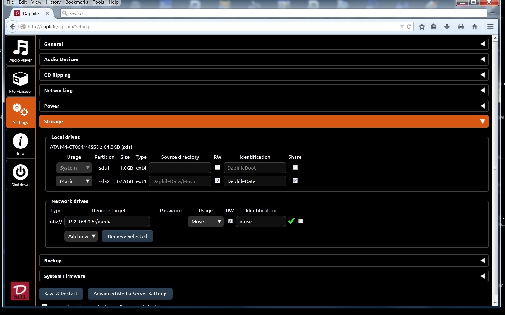

Hello joelha, I'm not an expert but I will try and direct you in the right direction in case you haven't got it working yet.
1. open Synology Assistant and it will show the i.p. address, note it down.
2. in Daphile Network Drive setup, you select nfs. and enter your i.p address followed by colon slash and the root directory your music is in. (example - 192.168.0.9:/media) The identification area I have 'music'.
My music is on a Netgear NAS, main directory is 'media' with 'music' directory inside.
I am attaching a screenshot of my setup... Dave
Dave,
Sorry for the very long delay in replying.
For some reason, I'm not getting notified of new messages on this thread even though I keep subscribing.
Thanks very much for your help.
I'm up and running now.
Joel
