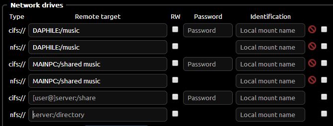

Network Drive Mapping
I am running Windows 7 Pro and have shared music files (see attached photos). Daphile also shows up and I can copy files to and from it's drive.
Also have a MAC that sees both the shared music files and Daphile. So I feel like the network is working.
Problem is, I cannot figure out the correct way to access the file share from Daphile. I have tried every combination I can think of and still get do not get the green check mark.
Can someone with a similar setup look at the attached photos (Daphile and my network share) and tell me the correct syntax for mapping my share in Daphile?

I did finally get Daphile mapped to my FreeNAS drive but never my PC shared drive. Turns out I had to use the IP address in the share name. I suspect this has something to do with how my "Workgroup" is configured.
