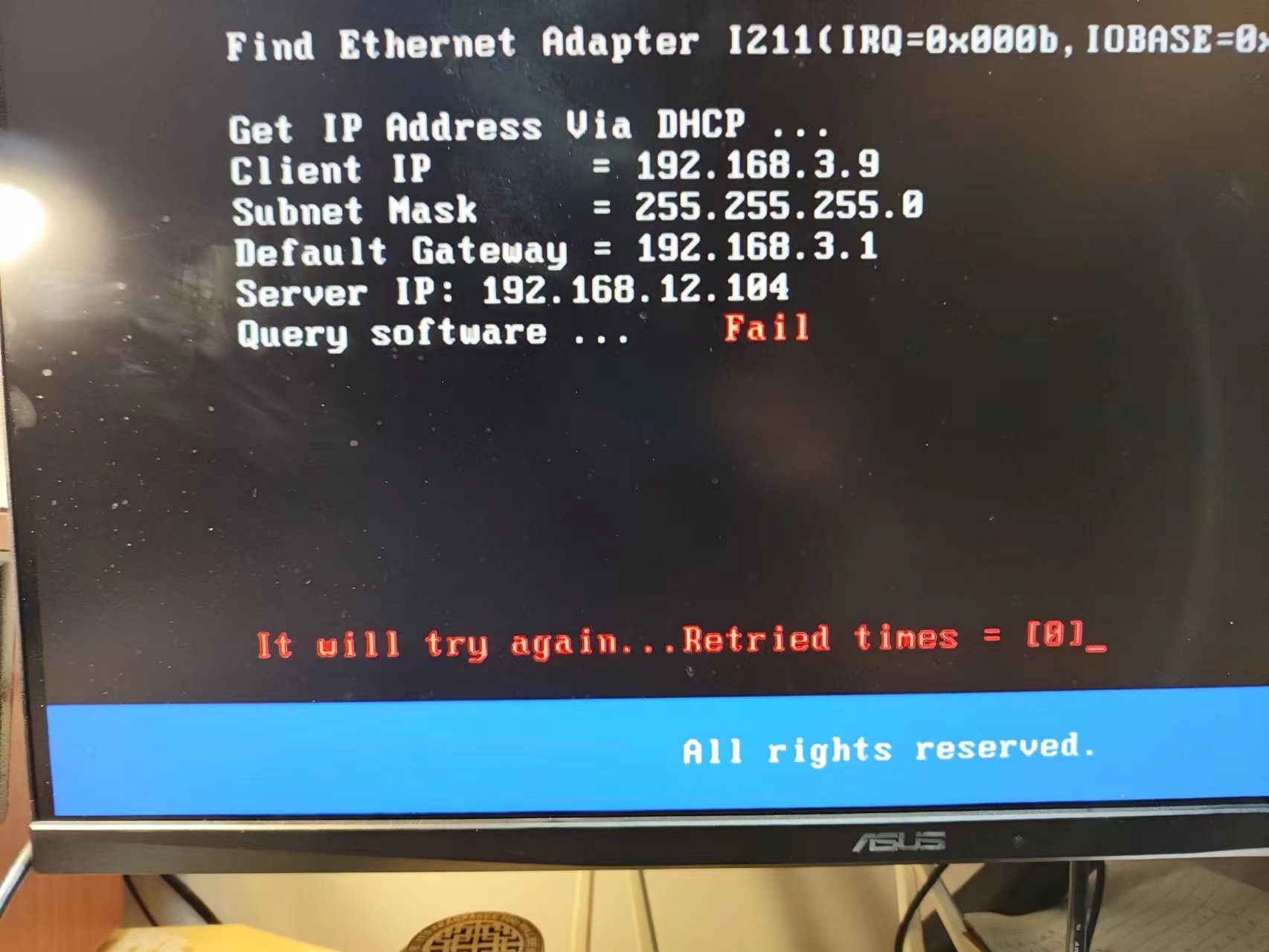

Has the web-interface address changed from the older 192.168.128.1 when accessing from hotspot? I can connect to the hotspot, but the web-interface no longer appears using this address.
The connected monitor is displaying 'waiting for network connection and is stuck in this mode. Earlier it would give us a message to use the hotspot, but that is no longer the case.

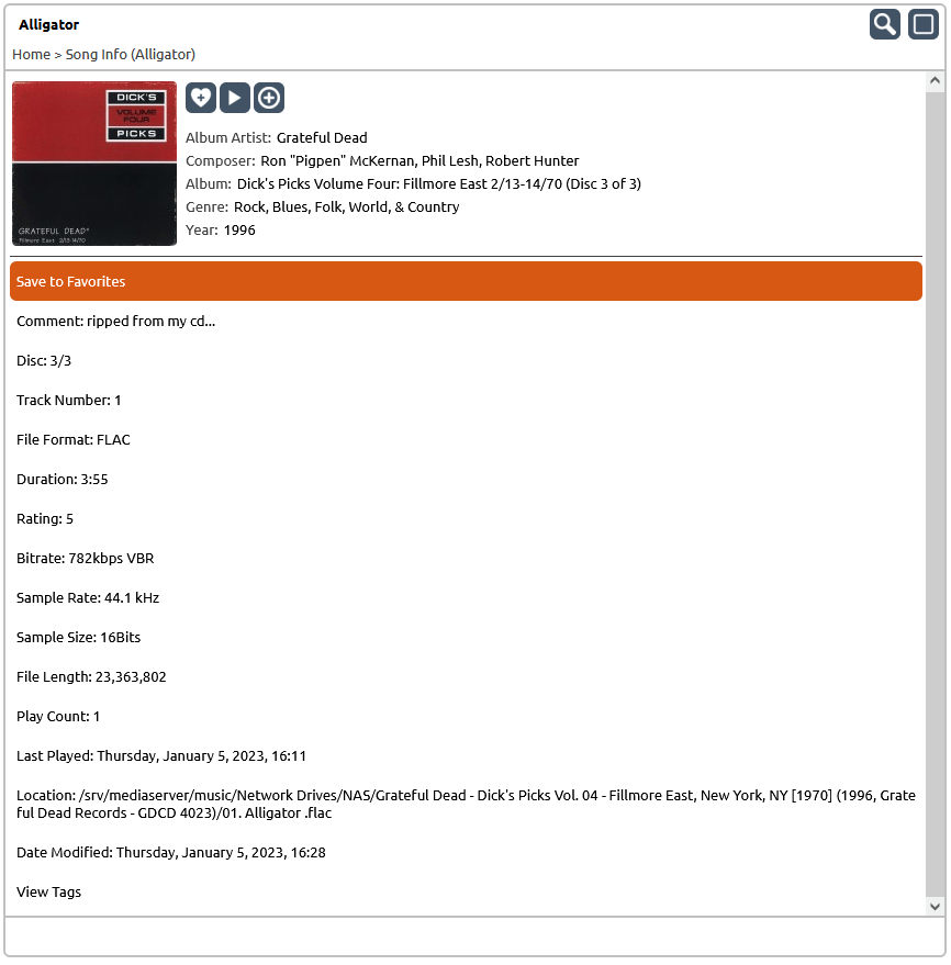

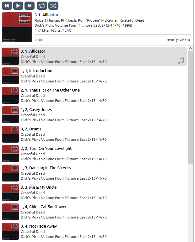

Hi everybody,
I'm not able to sort multi disc album (like Dick's Picks) with the proper sequence in Daphile 21.01.
Please refer to attached pics.
Always listed in alphabetical order, overriding disc number resulting in scrambled play order!
The same library is displayed (and played!) fine in latest Volumio.
Tagging was made with Mp3Tag v. 3.18, from discogs.com entries.

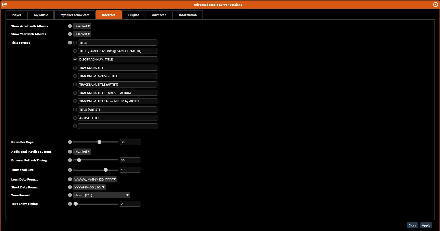

Already fiddled with "Treat multi-disc set as single/multiple albums" in MyMusic without luck.
Am I missing some preference in Daphile?
Should improve my tagging?
The only thing I don't want to perform is a library name change of files, of course, since I feel it can be done via tag/preference like in Volumio.

Isn't 21.01 an ancient build? If there isn't a reason for not updating, I'd do that first (a new stable build was released 2 days ago).Hi everybody,
Later, thanks
That said my install is sorting multidisc in order - I don't think I even needed to change the default settings, but I also name my files according to disc/track number too.
Any chance you could upload a file. Without being able to see exactly what tags are written, its hard to troubleshoot
