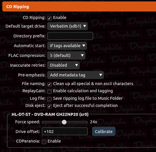

If you are experiencing ripping errors...especially near disc end then have you used the Daphile calibration option to calibrate your ripping drive ? and are you ripping to your local Daphile then transferring to your NAS ? Do you then remove any local copies from the local Daphile drive?

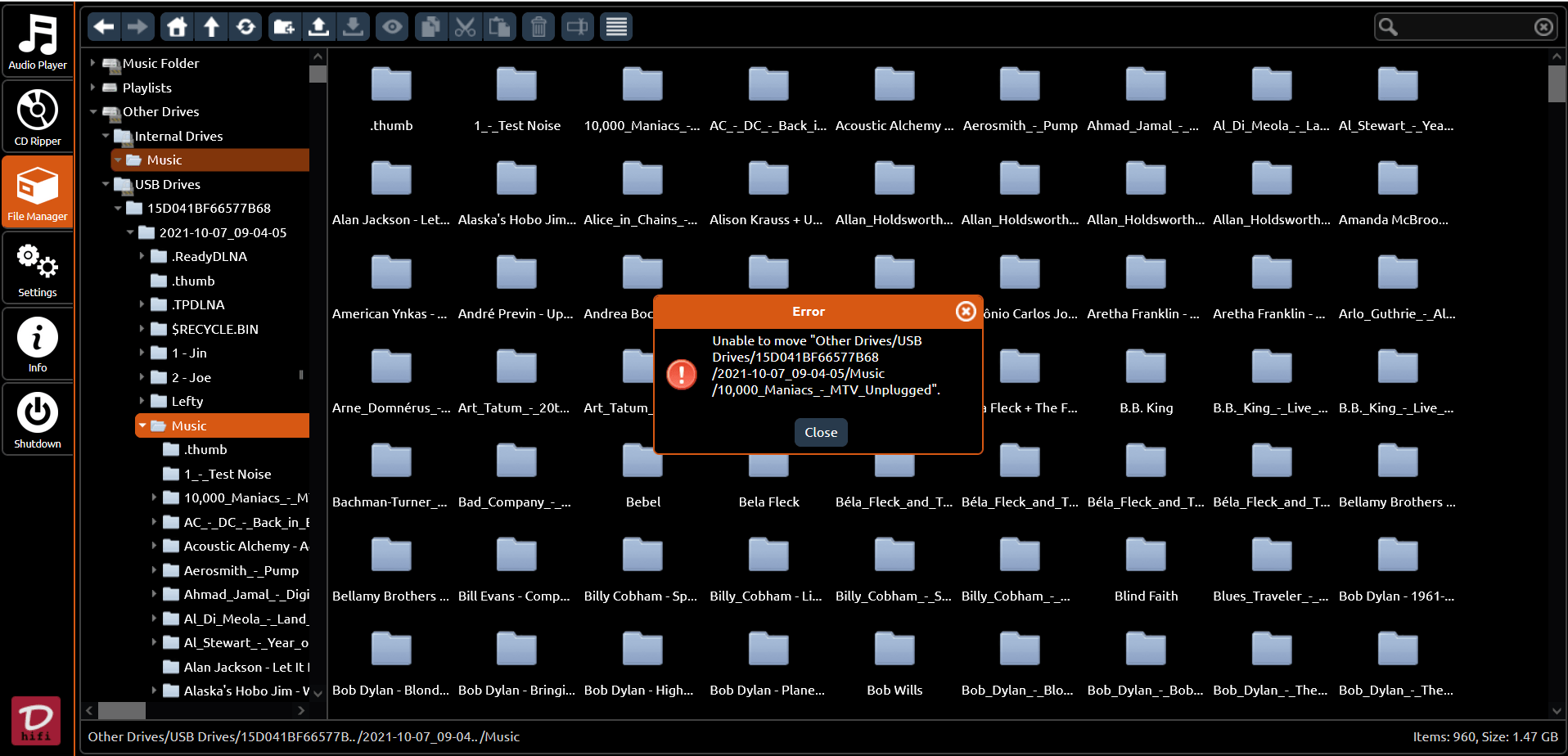

I've built a new Daphile system, using a 500G HDD. (I figure having a backup of the backup of my NAS music files cant hurt). When I try to use the file manager to copy from a USB connected drive to Daphile's "Music" folder, it says I cannot - no matter what I try. What's the trick?
All the files I'd like to copy arent locked. I've set the Music directory and the same on the USB drive to "Other" (assuming general use by the system); I've turned off "sharing" - and still. I've yet to use a file manager so picayune about what you're able to do. One would think by default you can copy stuff back and forth, in and out of that Music directory as you would expect, given your experience (it just works...) with any other computer system.
Thanks for any help with this!
I can get the copy to work when I have the "share" attribute checked on the USB connected drive. Next up, most of the artist directories have a .thumbs subdirectory, which causes Daphile to yak up an error and not copy the whole thing. Any artist sub without a .thumbs, copies successfully. Funny, the presence of the .thumbs sub doesnt seems to bother Daphile on the connected NAS; they are seen and play just fine from there...I've built a new Daphile system, using a 500G HDD. (I figure having a backup of the backup of my NAS music files cant hurt). When I try to use the file manager to copy from a USB connected drive to Daphile's "Music" folder, it says I cannot - no matter what I try. What's the trick?
Looks like it's going to be a lot of work deleting all those .thumbs subs, the copying each artist sub, one at a time X 1000...

So I had to pull the drive and hang it from a USB dongle off a MXLinux system. Using GParted, I could see the partitions labeled DaphileBoot and DaphileData. Of course, DaphileBoot was the one that mounted automatically, as if to underscore its usefulness regarding what I wanted to do. I Googled and found the Linux hieroglyphics to mount the second partition (sudo mount -t auto -o rw /dev/sdc2 /mnt -v) and lucky I was able to remember my User password, versus the Root password I needed to run GParted...
Once mounted, I was able to copy the USB drive copy of my NAS audio directories to it directly, in a normal way (cntl A, drag over across the windows...) That took a couple hours. Waking around 2:30 AM, I dismounted everything using GParted, shut down and put the drive back into the fanless Atom PC. It booted and started scanning all the media, which I'm able to play now in the same way as when I had it mapped using cifs to the NAS; .thumbs directories and all -
Why did I do all this? Backup of the backup and someone here said you get better SQ with a local copy, than transporting the audio data over the network. Makes no sense to me, but as long as I had the drive just sitting in a drawer, might as well give it a try. Just wish it wasnt such a kick the ball, drag Fred of a process. I think I'll give that "Spin Down HDD" checkbox a try and see how much trouble that causes.
Two ext4 partitions; one mounts, the other doesnt - I'll never understand. The one that mounted had a "boot" flag set; I could see no flag that would tell the OS to mount the DaphileData one. So too bad; when I plugged the drive into the NAS, it also only recognized the DaphileBoot partition as well. If it recognized both, I could have easily copied the content directly from the NAS via its own UI system.
