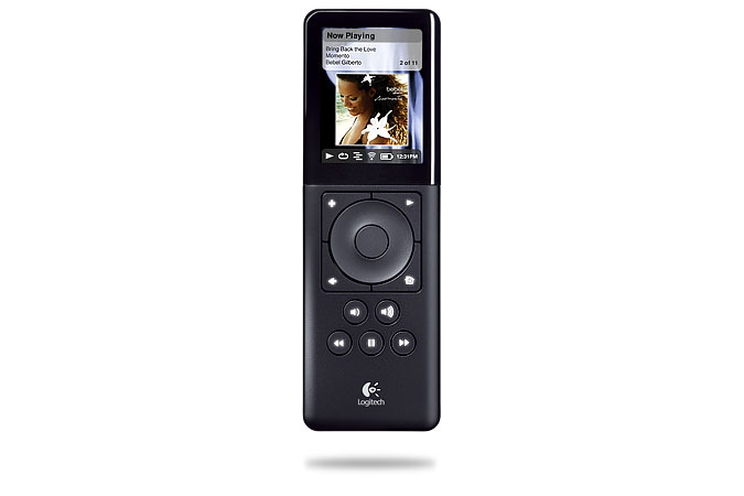

Daphile control...
I forgot to mention that the Logitech Duet handset works fine with Daphile as long as both can connect to your wi-fi network. Unfortunately, the Duet was discontinued a couple years ago but you will find many on E-bay....Dave

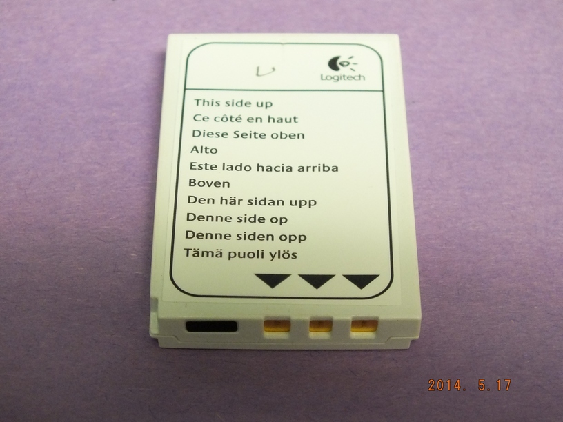

Hell JuanV,
Since this pertains to controlling your Daphile software/server I think it would be Ok to discuss your battery problem here.
There are 4 possibilities that come to mind;
1. The battery is installed wrong. Highly unlikely though.
2. The battery is defective or not compatible with the Duet. Possible.
3. The charger is defective. Possible.
4. The Duet Controller is defective. Possible.
Below are pics of a Duet battery, one showing the terminals. The second pic shows the battery specs. The left terminal (toward black bar) measures 4.1 volts DC. The other two terminals seem to be common. Battery is fully charged.
Measure the contacts in the charger base. Mine measures about 5.1 volts DC.
Your battery should be equivalent to L-LU18. If not then I would obtain one that is.
If you remove the battery and re-install it then place the Duet in the charger, all the duet buttons should light up. I hope this helps you find the problem...Dave
