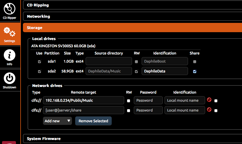

Hello
I can not set Daphile to work with my Western Digital external hard MyCloud 2T.
In the "storage" cifs :/ / typed 192.168.0.234/Public and does not work.
What is wrong?
You should define the "Identification" field. It may be almost anything you want, eg. MyMusicLib.
