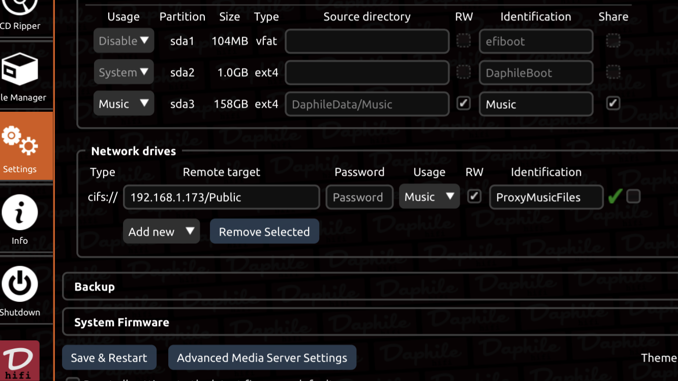

Daphile and WDMyCloud network settings
For those who desired to use the low cost WDMyCloud as music server but can’t manage to get it run for Daphile, attach is a screen shot showing an example of successful network settings to share.
