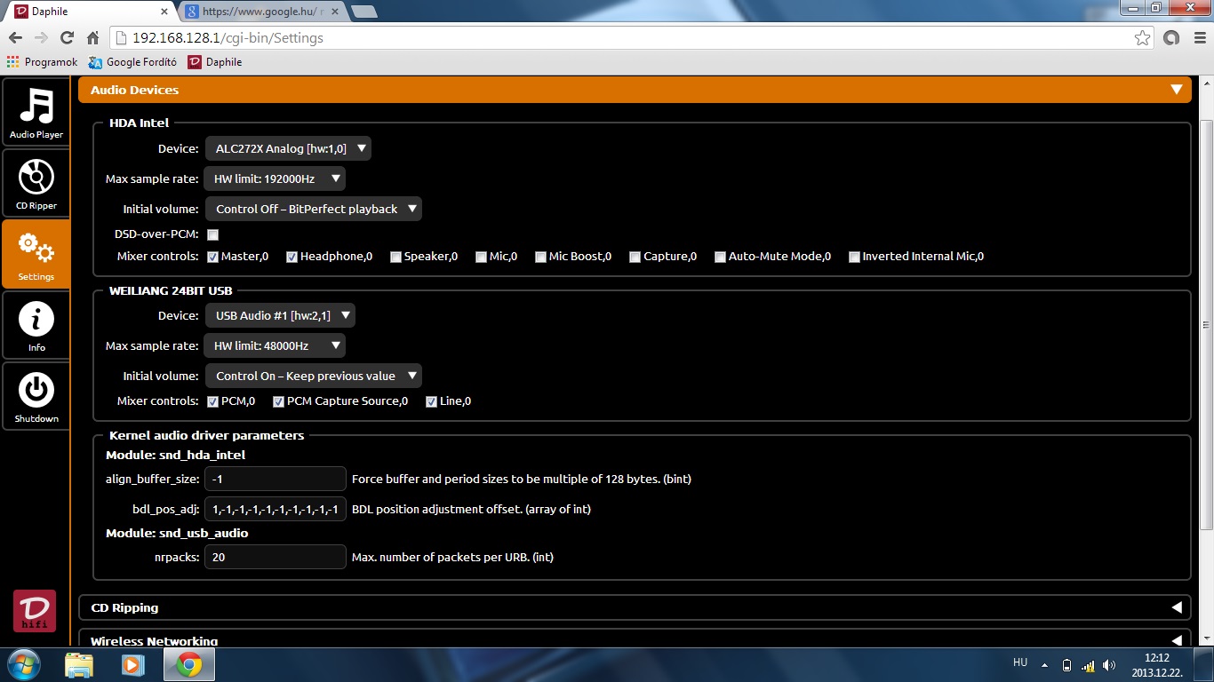

Here is the second one.
By both device I can set the max sample rate to only 48Khz.
By the HDA Intel device I can set many kind of sample rate.
Tyimo
I think you have found a bug from the web UI. It picks up the max rate from device 1 for both of them and that's why it is shown wrong for the Device 0.
However if you have selected "HW limit: 48000Hz" option the player does not limit the rate (it lets then the HW to determine what's the limit) and you should be able play 96000kHz files with the Device 0.
I'll fix this bug in some future release.

Thanks!However if you have selected "HW limit: 48000Hz" option the player does not limit the rate (it lets then the HW to determine what's the limit) and you should be able play 96000kHz files with the Device 0.
