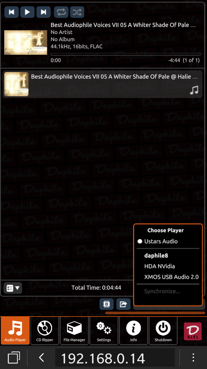

More problem, installed ok, able to rip CD no problem. Hook up the DAC, Tried 2 types(one at the time), XMOS and Cmedia based, the Daphile was able to detect both DAC under the Audio device setting. Play a track, it seems to play alright, the problem is NO sound output from either device.
Any suggestions?
Check the bottom right corner.

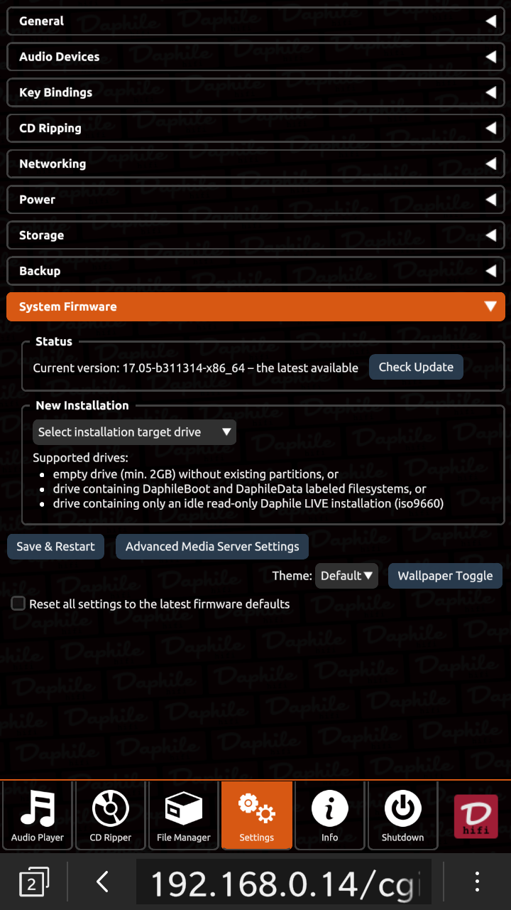

1. When down the Daphile laptop and power it back, on booting it up it shows network connection of hotspot not the a fixed IP address? why?
Did you click on "Save and Restart"?
2. when I powered down the Daphile laptop and powered it back, why I now cannot find the CD I ripped last time. It's not there, is it because I didn't save it?
If it is ripped, it will be there. If the CD artist is unrecognised, it may be under "Unknown Artist". In that case, you should use MP3Tag on a Windows PC to open the folder and insert and save some metadata to the files/folder and rename it too.
You need another USB drive. Load under new installation.. Boot from this new USB drive. Then the save button will let you save..... Download the installation pdf file on daphile site and read

I am not sure what you mean, I did a fresh install and log into Daphile from remote tablet, under setting and system firmware, the button to restart does not contain save sign that should come with it, can you explain what I have done wrong?
So how can save and restart?
