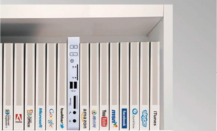

foxconn nt-535 atom d525 1.8ghz(80$ used) ALC888 ,8gb ram,hybrid 750gb sata 8gb ssd, cheap ethernet cat6 and bnc coaxial cable 75ohm from blue jeans cables, pc is conected to router by wifi and transporter by ethernet to pc, transporter can be connected to wifi and bridge ethernet to connect pc behind too,
Logitech media center 7.8.1
the nanopc has optical spdif but i soldered a coaxial rca cable directly, so i can use jriver or foobar or squezelite direct to dac.
and daphile installed on sdcard... etc
very versatile little pcl
View attachment 602897 pc is conected to router by wifi and transporter by ethernet to pc
