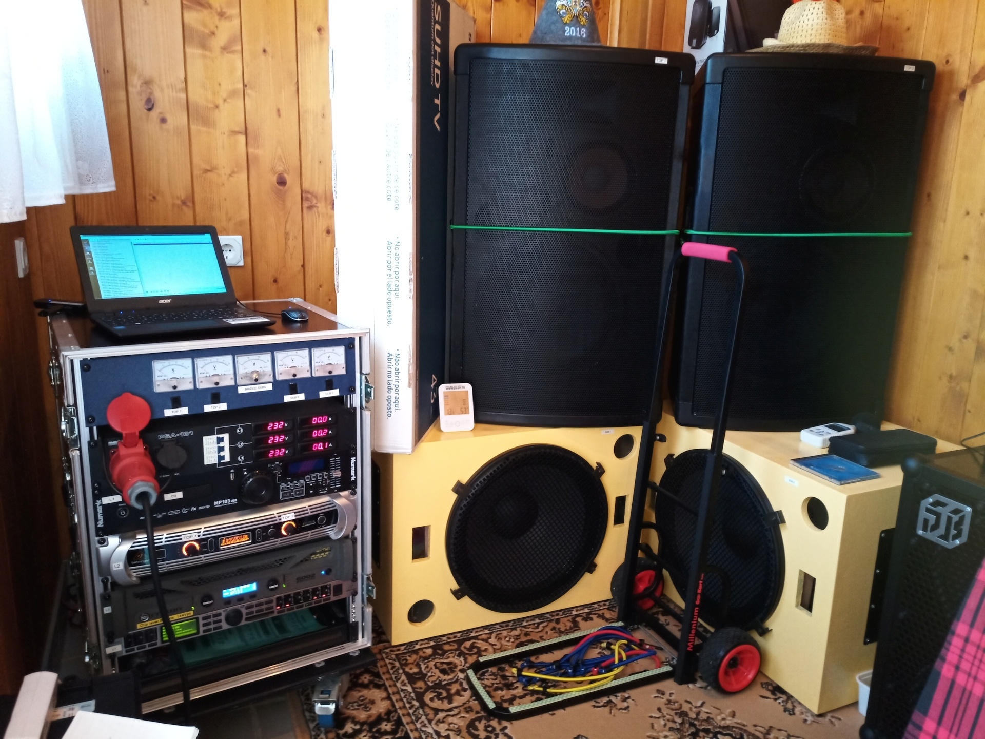

Currently I have:
1) A soundboks 2 - portable, easy setup, but SPL-wise not even enough for the occasional flash mob party outside, since the bass is DISAPPEARING after a few meters!!
2) A 4 way system 2 x 18", 2 x 15", 2 x 8", 2 x CD - sounds nice, but needs AC power and is definitely NOT portable (~180kg total).
Guess what I want?
I want the portability / setup easiness of the Soundboks 2 and the output of the 4 way system combined in one system!!

So that is what I have (see attached foto):
Per side: 18NLW9400 (40 - 110Hz - tuned to 45Hz), Beyma 15MI100 (110 - 400Hz - tuned to 60Hz), RCF L8L750 (400 - 3750Hz), RCF 1" mylar voice coil horn tweeter (3750Hz+)
Question: If we don't talk about cheapskating $$$, if I even give up the 40Hz LF BW for some - say - omg that compromise is really hurting - 50Hz:
-> Is there ANY technical chance on earth to get equal SPL using 1 x 15", 1 x 12" plus 1 x compression driver per side (powred by T604) at a total half the physical system volume / half the system weight???
(Remember, I can already save big time space and weight replacing the amp rack by 1 x T604 - so the speakers need not be half physical volume in order to reach the goal of having the whole system's weight and volume halved).

It looks to me like those 18"s are rather short on port area, so you might not be realising their full potential anyway. To give you an idea, the ones I'm running have a port area around 1/4x Sd (at the narrowest point - they're tapered in the middle), and show around 2dB of compression when you drop a 1KW sine tone at the 40Hz tuning frequency.
Given that, I'd expect a good 15" to keep up just fine.
If you're using 1x 15", you could use a 10"/1" main speaker. FWIW, the Faital Pro 10HX230 is pretty good. I've had 125dB sine tones from 100Hz upwards out of mine, although distortion was starting to rise.
You could spend less money by re-using one of your existing 18"s in a box that's tuned higher.
Chris
So I could not fing any "decent looking" 15" sub at Thomann.
What you think about 1 x Lambda Labs MF-15 powered by 2 channels of T604, in bridge mode?
1 x high end 15" instead of my DIY 2 x 18" (which are series wired for 16Ohms total, on bridged XTI6002)
Sensitivity of 1 x MF 15 is "only" 98 dB, but it can survive quite some amp power.
The 18"s are already tuned high (45Hz). Due to the high tuning, the port area needn t be that big. But I admit, there may be some "port compression".
I think you might be surprised.
So that 400USD 10" coax speaker should do what my big 15-3 s do? Guess you re kidding.. The better, in case you are really right...
I don't know what your 15" 3-ways can do, but I can say that the 10" coaxial was putting out 125dB@1m sine tones. Distortion was rising, particularly in the treble where some compression was showing up in the 10-20kHz range. I had to do short sweeps to ensure nothing burnt out - power levels were around double the rated power handling, and being delivered as sine tones. No rest for the wicked. :hot:
The 10HX230 is a good driver, and I'd expect it to keep up with older model 15"s reasonably well.
My point is simply that if you're using 15" subs, the 15" 3-way top will have a very easy time - the subs will be the limiting factor by far.
In order to balance the system a little more, you could use smaller main speakers and run them harder. A 10" top over a 15" sub is a decent balance.

Looks to me like it'll be an expensive sub. Why not DIY?
Chris
The 10 inch coax is available for Eur 225if I buy 2. Add the wood and I d have 2 speakers for say... 600EUR. I used to say what sounds too good to be true - is most likely a pipe dream. Anyway - at that cost I can build that speakers just 4 fun. So the 125dB was unweighted I guess? At what drive voltage?
About the Lambda 15 inch hybrid I think it won t be too expensive if it enables me to go with ONE sub.
