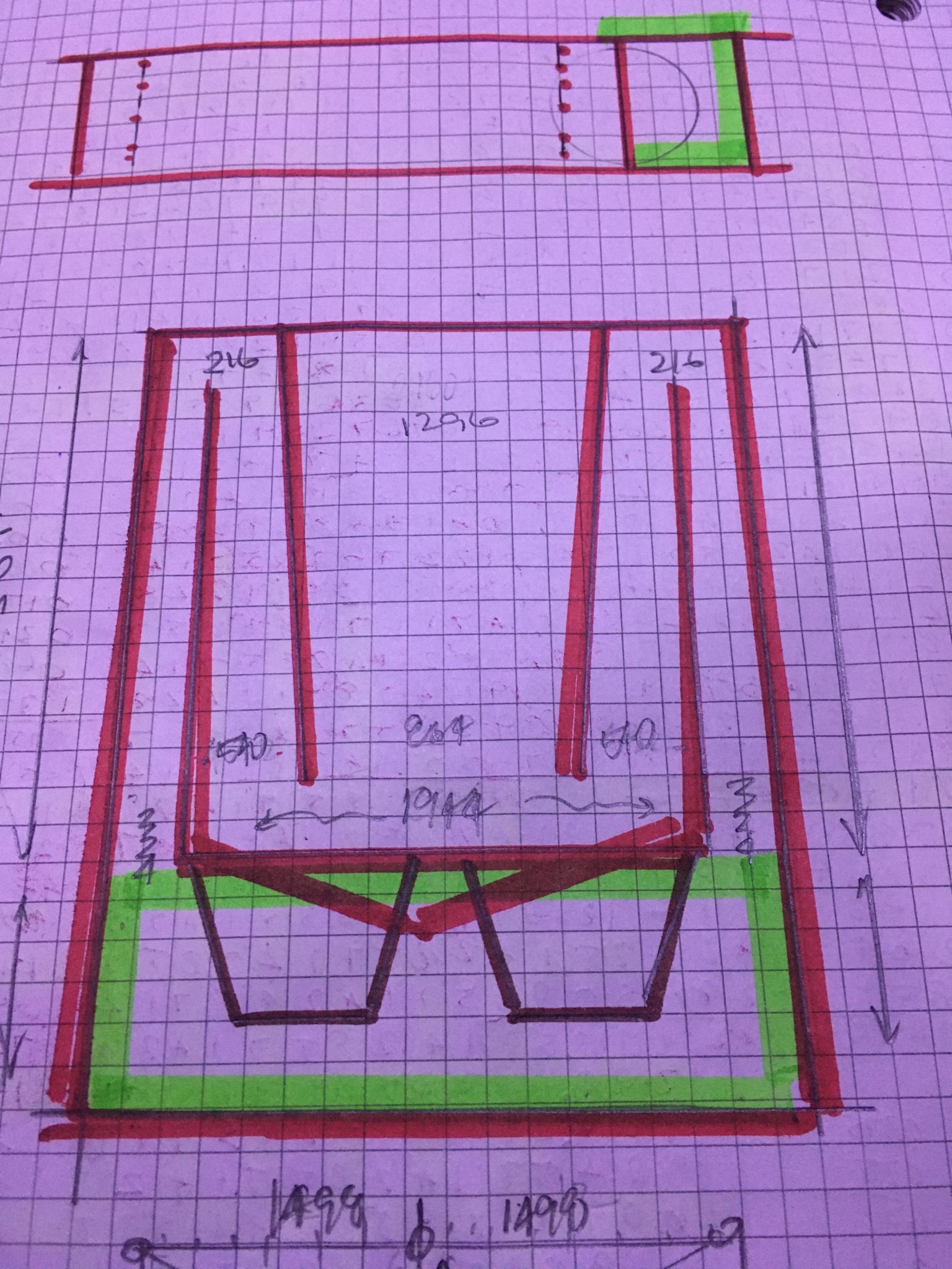

It's not for only car audio duty. It's also for a small DJ system that can be transported in, and powered by, the car. The intent here is to get the most efficient use out of subwoofer drivers in a box that can fit in the trunk.
I know that the TH28 is tuned a bit high, hence my idea of making the box a bit larger to see if that can move the Fb down to around 40 Hz.

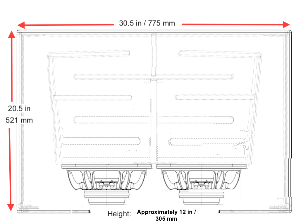

To get the Fb down to 40 Hz in the DSL TH-28 form factor would require one more fold than the original, the attachment shows an example with the extra path length fit into the same size, other than the extra height required for the 10" drivers, which are shown slightly undersized- my scaling is off...
The extra path length may reduce the usable upper bandwidth a bit, though that could be "cheated" making a "<>" shaped exit. I have not shown the exit shape in the 2x10" attachment.
The TH-28 has two user configurable exit choices, I'd suspect the 20" tall set up would have a bit more forward gain than the "stair step" choice, though DSL did not indicate which configuration was used in the 8/11/2005 measurement.

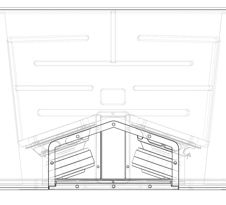

Thanks for that info, Art. The "redesign" I'm thinking of is actually widening the box, which should increase the path length a bit, and the narrow paths might actually be a better match for "car audio" type subwoofers with their smaller box requirements. The TH pictures seem to show the drivers mounted at an angle, rather than on a flat baffle board - is the diagram a simplified diagram of the actual layout? I suspect that it's not going to make that much of a difference anyway.
Looks like I'm going to be pretty busy over the next few days, but as soon as I have a chance, I'm going to try to BOXPLAN the layout.

I can’t ever decide whether to just go with this Driver entry as it promotes the more beneficial fold affectively. Or the fact that it requires a tilted baffle half the time to fit The driver and CSA found in HR. Either way it helps promote the slightly longer length that you need on the initial length from the closed end.

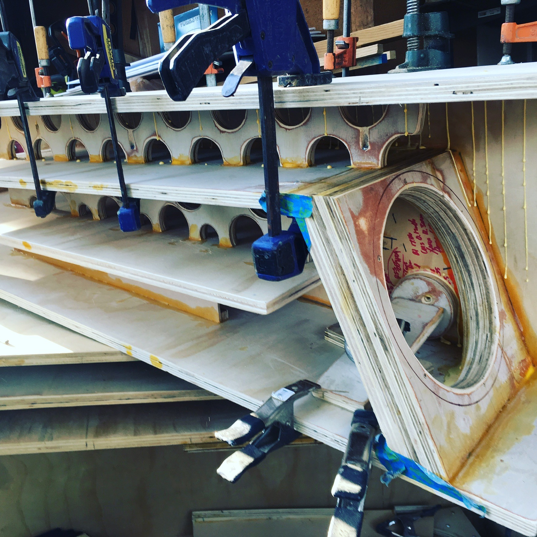

–2x this ?
Thats the rss265/ho4. But worked so good the next is for the Dayton audio UM18 going in my SUV underneath a compound/roar morph tuned at 40 hz?
Beautiful Disaster 😝 I don’t know yet?
