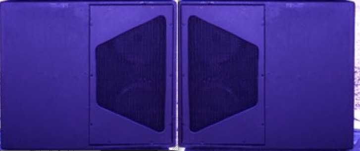

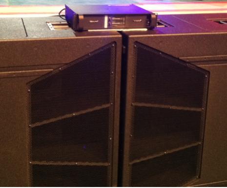

I think DSL may use a different throat arrangement than my sketch in post #10, without pulling a speaker it would be impossible to know.Art, this driver is an example of a driver that drops its minimum impedance under high power. Btw most modern 21"or larger do give a different impedance plot between low current measurements and high current measurements. Any idea what throat opening he is using in this cab?
My guess is the throat arrangement on the TH-812 (and DTS-10, IIRC) shows a preference of a “V” shape which may also be incorporated in the TH-221, that shape has some interesting features, it is not used for supposed push pull benefits as is the assumption of some.
The “V” throat shape does not require multiple speakers to be effective.
Then again, my Keystone 18” sub design works well at very high power with a fold pattern similar to my sketch in post #10, though the huge TH-221 allows an additional fold and much longer path length, a requirement for a TH to reach down to the 20 Hz range.
By the way, DSL released a FLH with a keystone shaped exit sometime after my design was posted, for those of you that think obvious visible design features for some reason should not be duplicated.
Regarding the OP, my opinion is the Gjallerhorn would be a better design to pursue for home use, or portable PA use for that matter) unless he has a listening room the size of a 747 airplane hanger.
If one Gjallerhorn was not enough, another could be added and multiple locations could be used, splitting up subs can often provide more even response than a single location.

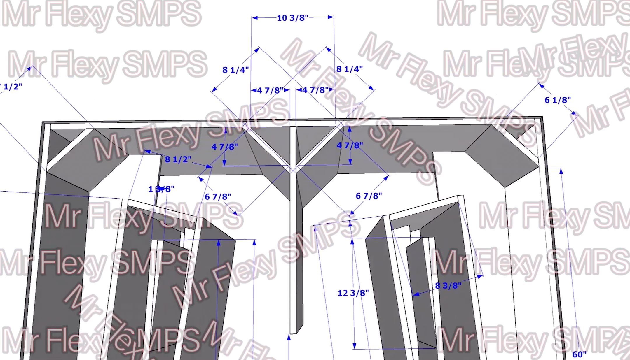

Keystoning a FLH mouth has none of the effect that you use it for methinks. I would guess the situation is similar to the TH50 where the internal path borders the mouth and determines the shape. One could say the TH50 was before your TH and therefor you are the one stepping on toes.
Been so long since I looked at the Hornresp horn part descriptions, had to look them up 😱.The V is to get the compression up @ S2.
S1 (or A1) is area at the throat end.
S2 (or A2) is the area at the midpoint of the rear (throat side) of the driver.
The compression ratio at S2 can be the same without using a “V” angle at S2.
The “V” creates a larger volume at S1, that air volume stub may tend to equalize cone pressure as well as smooth upper response peaks.
I don’t know if you will see those effects in Hornresp, you could try making S1 volume double or triple S2 and post results with a design you are familiar with.
Art

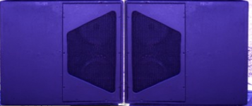

RE 812:
Um, S3 gets bigger when S2 gets smaller with the V, S1 isn't really big the woofer is in there.
Vader has a funny tapered mouth because the woofers are mounted there, see the hatches.

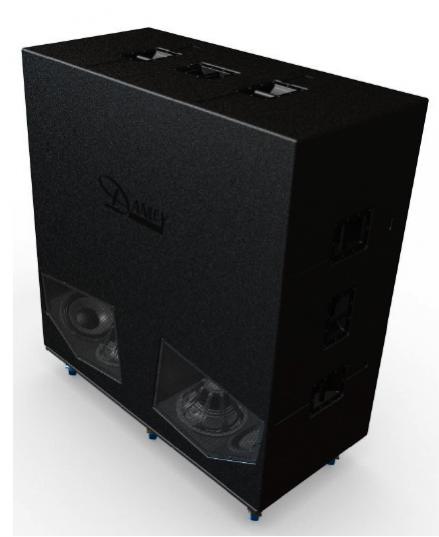

The internal path of the DSL DBH-218-LC may border the mouth and determine the shape, hard to tell from the picture.Keystoning a FLH mouth has none of the effect that you use it for methinks. I would guess the situation is similar to the TH50 where the internal path borders the mouth and determines the shape. One could say the TH50 was before your TH and therefor you are the one stepping on toes.
I certainly did not copy the DBH-218-LC (still no specs or pictures on DSL’s website) I saw no pictures until after 6/19/2011 when I saw it here:
New Danley sub
At any rate, Tom Danley and I get along fine, we don’t step on each other’s toes, but it was a surprise to find his new FLH cabinet exit looking so much like my 2x10" Keystone after discussing the Keystone design vs his TH-118 with him previously.

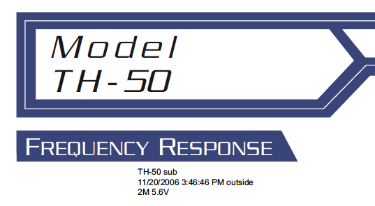

By the way, the TH-50 was tested at 2 meters, the distance I usually test at, some things are just coincidental😉.

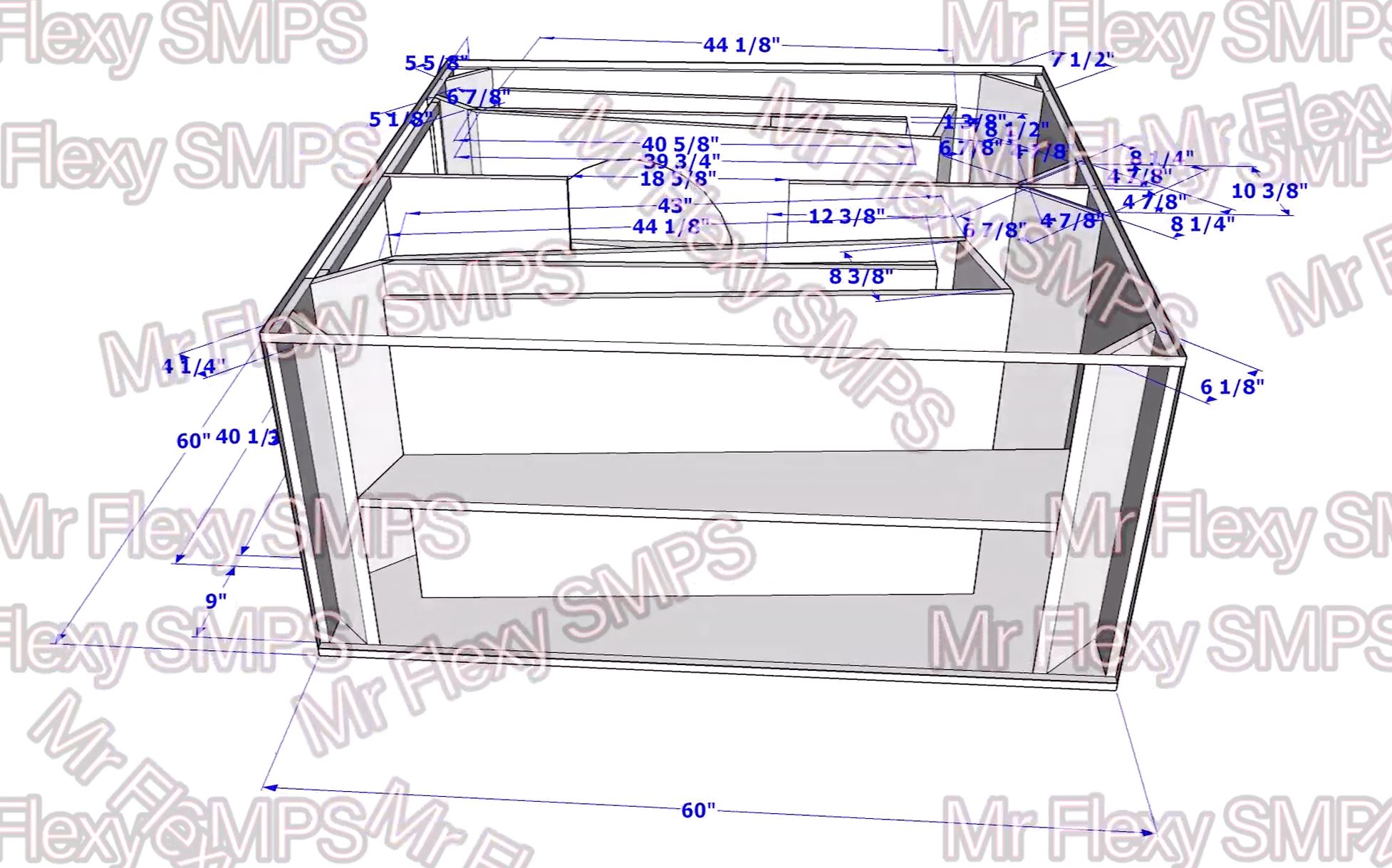

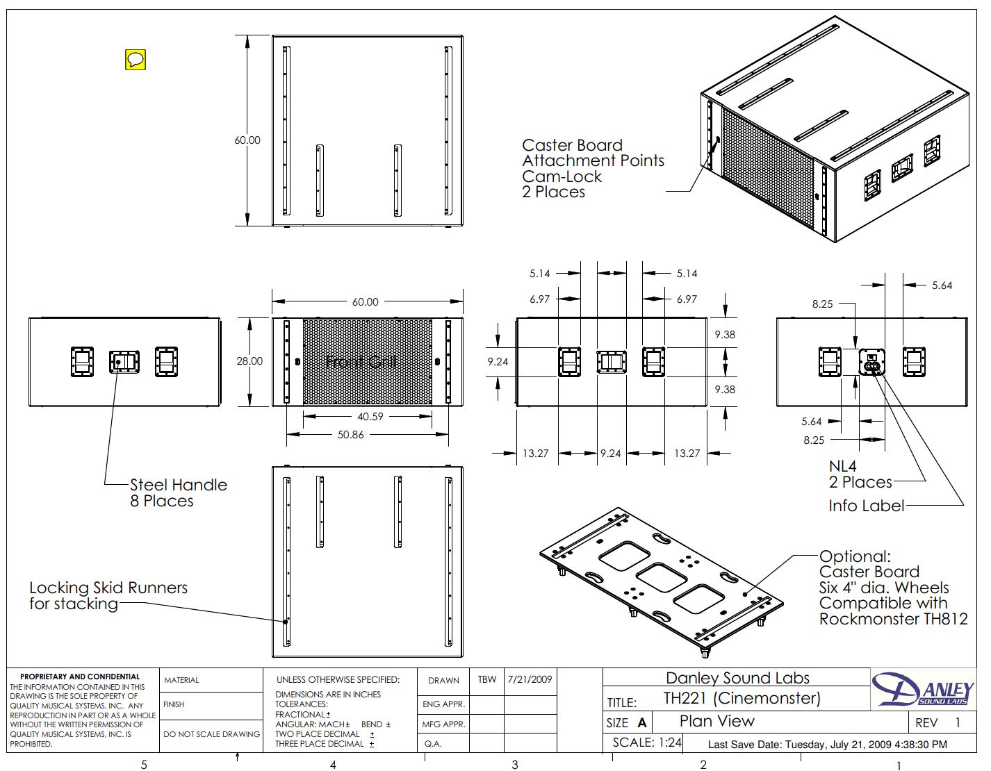

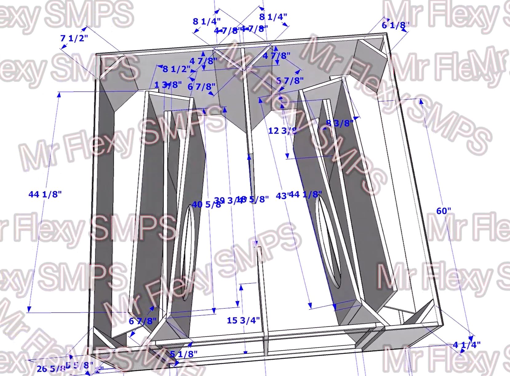

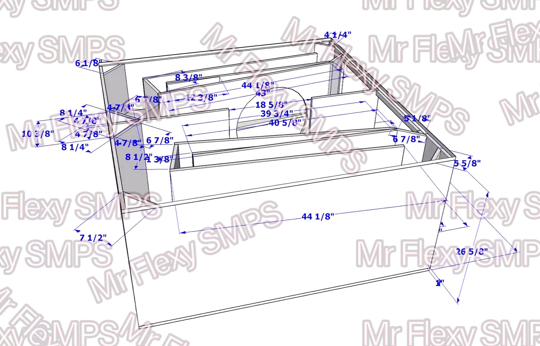

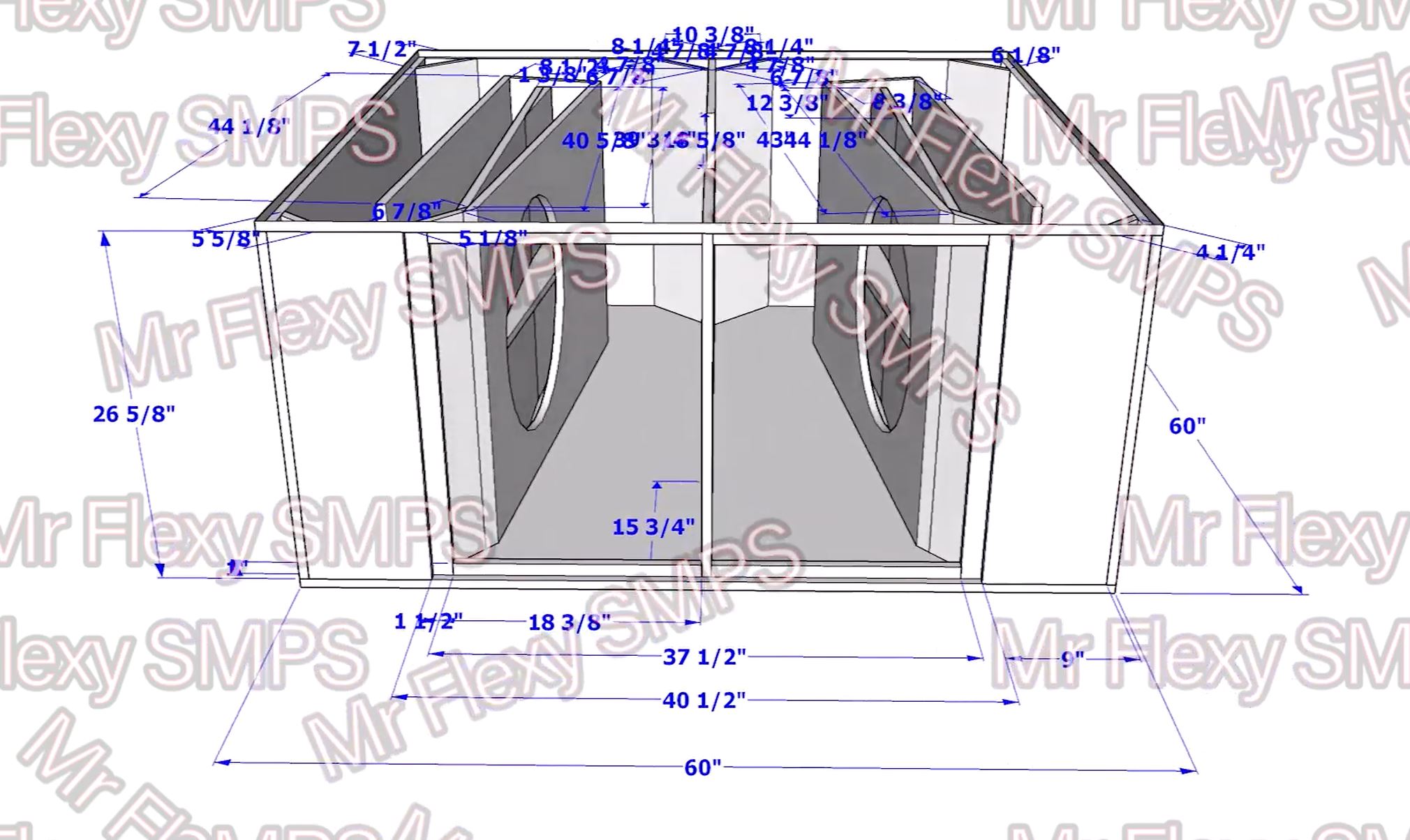

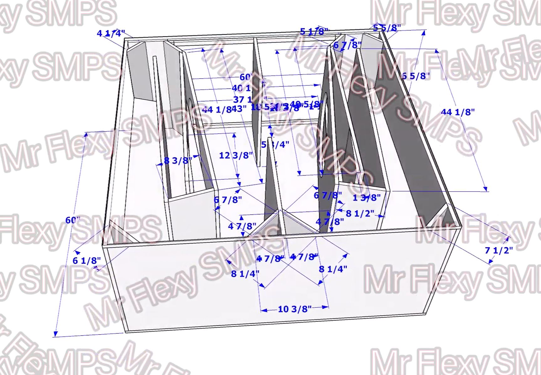

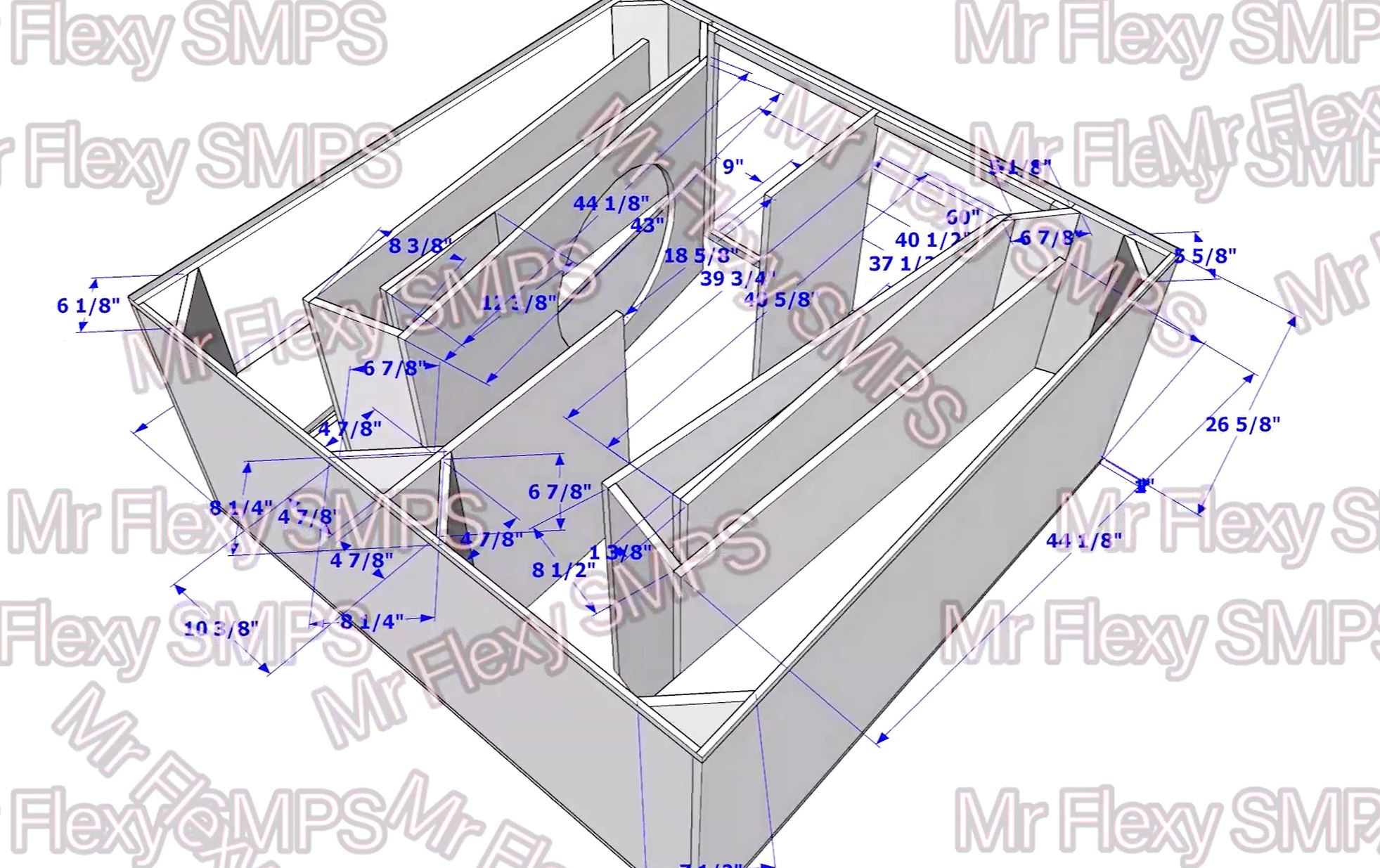

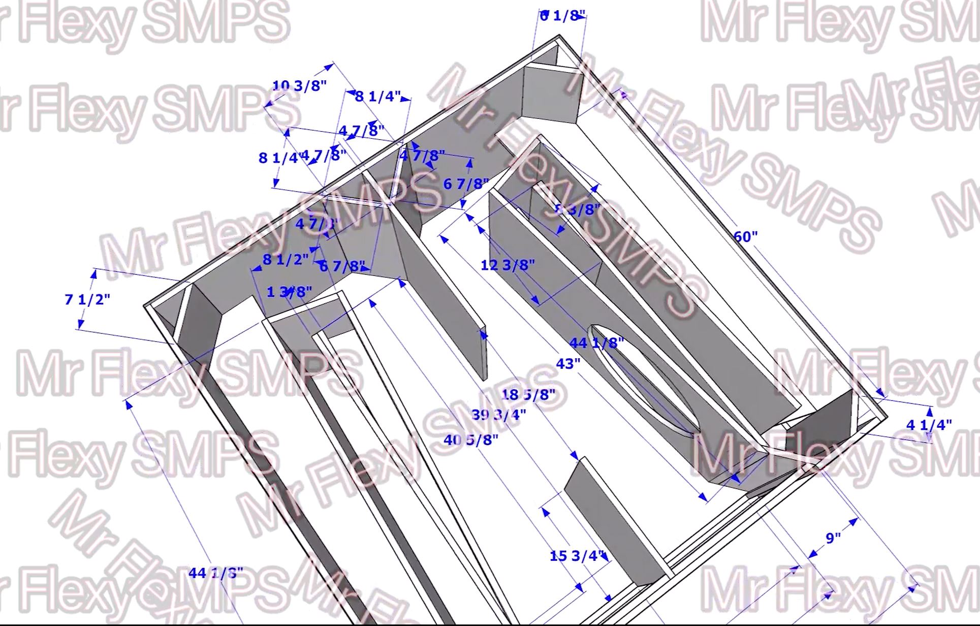

Found TH-221 drawings on YouTube
There is a YouTube video by "MrFlexy SMPS" that shows TH-221 internals with dimensions. I have screen captured some images and attached to this post. Would be good if someone can take this info and create detailed cut sheet drawings
