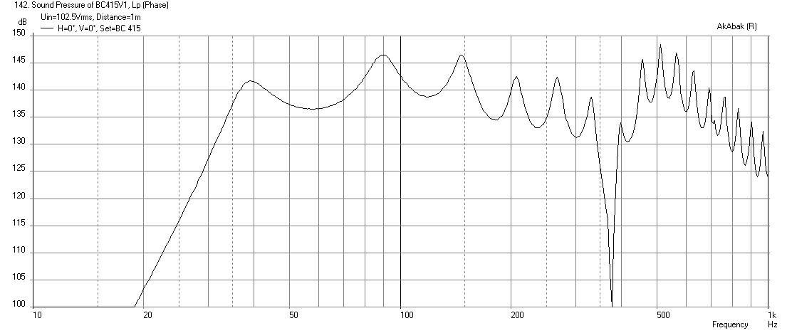

My sim of the guess of what a BC415 may look like assumes a B&C 15SW115 driver. I was able to hit 142dB xmax limited in 4-parallel drivers at 1600 watts a piece. The response max SPL and peaks at 38Hz, 92Hz, and 190Hz kind of look like the response for the BC415 shown by DSL. Given the max power rating specified by DSL as 1700watts ea, I think I might be very close. My peak power also ended up at 87Hz - the same value as the peak power spec for the BC415. I think it is probably 85% certain that the B&C 15SW115 is the correct driver.
Here is my sim at xmax again:

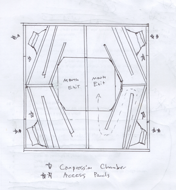

The fold scheme is quite simple actually - see guess made by Weltersys - provides the path length needed.
The cost of the drivers is not the issue ($2000), it's where do you keep a 60x60x26 in box that weighs 500lbs?
I have so many carcasses in my shed that I could fit one in there if I got rid of the 3 other cabinets that need to go. 3" casters and no problems. For me its more of a money thing. Not saying that I could use the 18 Sound 18LW2500 but they are about 700 for me for a pair. SO easier for me to deal with budget wise verse four 15's albeit more SPL.

Having moved around single large cabinets and four small cabinets equal to the size, on smooth terrain moving the single large cabinet requires less effort- one trip from the truck to stage is a lot easier than four.Ok, I'll bite - what makes this better than four folded horns, one for each of the driver indicated? I'm going to guess that four separate horns are a lot easier to move around than that behemoth.
A single cabinet uses less wood, so is lighter than four cabinets of the same enclosed volume.
At any rate, multiple driver BC (or any type of folded horn) designs can be made as single or multiple driver cabinets to fit various transportation and storage requirements. Presently, as a small time operator, the flexibility two or four cabinets provide is an advantage, though when I was working on a large scale (over 100 sub drivers) quad loaded cabinets were preferable.

Xrk91's recent simulation shows good correlation to the BC415 measured results.
Other than some throat details I suspect are employed not shown in my simple sketch, I think building from it, using BC15SW115 drivers would result in a cabinet with response very similar to the DSL BC415.

I had to add 16in to the length of the horn to get it to match Danley's measured response based on an 88in path length derived from Weltersys' guess of the internals. If the internal path somehow squeezed another 16in (could be possible), then I did not need to add the 16in. The 16in, btw, is equal to 60% of the mouth dia.
I have tried to sim the "bubble" as a very wide and short horn with a throat equal to the mouth aperture and the horn exit equal to the baffle size of 60x60 inches and a small path length of 1in, which is flat for all intents and purposes. It did not change the bass extension, but it does change the amplitude - so in effect, may be considered shifting the extension if you normalize with respect to the amplitude without the wide bubble horn fudging horn that I added. This fudging bubble horn, btw, is very sensitive to length. You get quite a bit of gain for a 4 inch long vs a 1 in long "bubble horn". Just food for thought.
You don't necessarily need length to get lower tuning. Like I said before there's a few tweaks you could make to get the sim to match better without adding length. Things that are entirely possible based on what we know about the cab (only a picture of the front of the box is all we really know, in other words mouth details). A different flare rate starting with a larger throat should tune a bit lower and not add any length. I'm not sure what throat size you used, but Danley doesn't usually go too much higher than 2:1 compression ratio (which is unusually low for designs around here) so it's entirely possible your simulated throat is too small. Also, as Weltersys just mentioned, it's possible and probably even likely that the beginning of the line is flared out like the TH-SPUD, so that S1 is much larger than S2.
Changing the flare rate and adding 6 inches for the mouth bubble (not 18 for the boundary bubble) should get you just about where you need to be.
The rear chamber size might need a bit of tweaking too, maybe not. I didn't want to get into the "match the measurement better by tweaking the inputs" game because it may or may not accurately reflect the internals of the actual box, but at the same time since we don't know it's worth looking into what might be in there.
