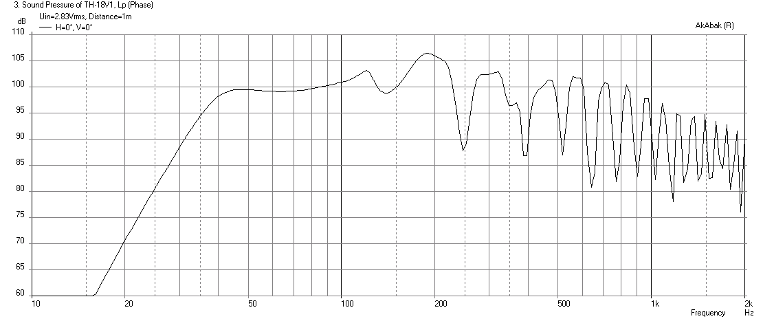

Designing a good TH is not trivial - and sometimes it is best to use a well-accepted design as a reference. Take the TH-18 (http://www.diyaudio.com/forums/subwoofers/190635-th-18-flat-35hz-xoc1s-design.html), which has had many successful builds and I believe is one of the better designs out there for a larger TH given how much iteration, refinement, and work went into it. If you want to back up your rather grand claim of:
See if you can make a straight walled TL with performance that will beat the TH-18 for the same volume and power, and maintain a flat bandwidth from 37Hz to 120Hz with 99.5dB (+/- 3dB) at 2.83v/1m.
Here is the performance of the TH-18 with an 18 Sound LW2400 driver at 2.83v:

I found this data in the thread you linked to, so i simmed it with another driver.
I hope this is right. I used B&C 18NW100 instead. I need some Bl if i am going to make it work.
The whole basis for this thread is still this:
If you try to get a high power density from powerful (low Qes, High Bl, high mms) drivers like B&C 12NW100 in a tapped horn you get a very high compression or a very deep depression in the middle of the passband

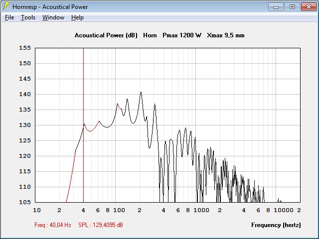

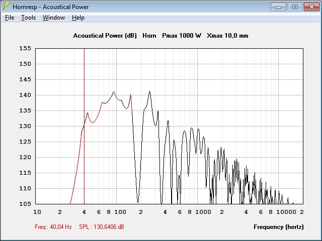

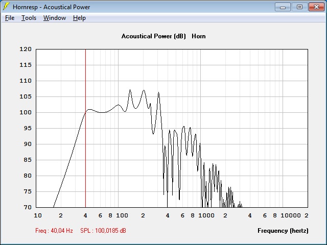

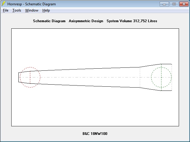

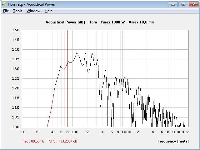

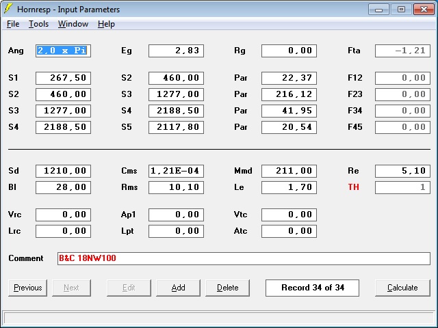

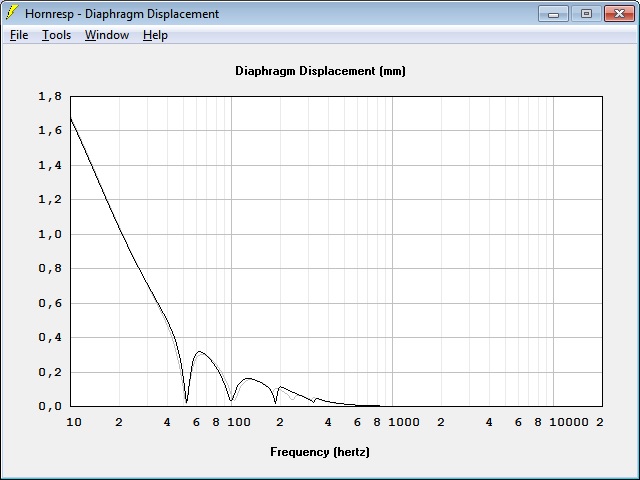

Not really what you asked for, but here is a smaller box with a total Sd of 1062 cm2 instead of 1225 cm2 (86,69%), and a xmax of 10 mm instead of 9,5 (105,26%) playing almost 10 dB louder at 80 - 100 Hz. I would say the 18SOUND 18LW2400 is a more powerful driver then 2 B&C 12NW100, except for the thermal power rating of the voicecoil.
The THBD is 4,46 liter smaller. Probably compensated for by the volume the drivers occupy.
Even though the 18Sound has more radiating surface and almost the same xmax (a total larger ability to move air) the THDB will play substantially louder in the very important frequencys around 70 - 120 Hz.
I have not worked a lot at this simulation. It took me about 15 minutes.
I have no idea if i could get it better than this, but i can not see why.
I know this is not a fair comparison, but i have seen that this kind of strange box does not work well with to weak drivers. The Ipal18 is the only 18 inch driver that is effective. It is most powerdense with really strong and efficient drivers like the B&C12NW100, IPAL18, Faital Pro 10HP1020 etc...
I will try more later on.
This was just a fast rough draft..
Johannes

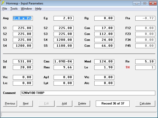

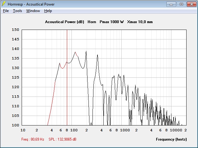

Hi all!
I have been trying to figure out the Danley BC line of subbs.
This is what i think is going on:
If you try to get a high power density from powerful (low Qes, High Bl, high mms) drivers like B&C 12NW100 in a tapped horn you get a very high compression or a very deep depression in the middle of the passband, like i show below:
http://oi59.tinypic.com/14mzaxv.jpg
I have two more posts to make, please wait until i have posted them before you reply.
Johannes

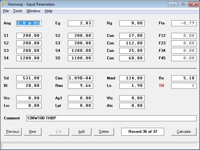

If this method is not useful for an 18 inch driver why did you use that driver in post 3 to describe this process?
Tell me which post contains the sim that you would like me to look at with the 12NW100 and I'll take a look.
But what you are showing is a stepped horn with two steps. We see this all the time, but without the steps, the basic shape is shown below. This shape is very common and it does the same thing, it boosts the frequencies at the top of the passband.
If you would like to take a look at this sim, i would be grateful.

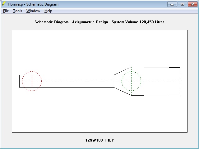

I have learned a lot during this thread. I started out with 12NW100 and faital Pro 10HP1020, and i thought it would work just as good with powerful 18 inch drivers. Now i have seen that this is not the case. IPAL18 is the only 18 inch driver strong enough.
It looks to me to be the same thing over again, like when Tom Danley developed the tapped horn to suit and take advantage of more powerful drives of the day. This happens once again with 12 inch drivers with a Bl of 28 or more. A guess a 18 inch driver with a Bl of 45 to 50 and a Mms of 300 grams should work well.
Johannes
I have to clarify.
This TH-hybrid works with almost any driver, but is more suited to very strong and powerful drivers. It does not seem to provide any real benefits in dB/dm3 (power density) with "normal" medium Bl, medium Qts and Mms drivers like the B&C 15TBX100 or 18TBX100.
The 12NW100 seems to be on the verge. I guess a 12 inch driver based on the IPAL18 motor would be a really good candidate.
I think this is a really exciting development. I believe drivers for basshorns will be more and more similar to compression drivers soon. A steel cone with a huge neodymium magnet structure, lots and lots of xmax and Bl, all in a hugh package where you don´t even see the cone. Probably two magnets and two voice-coils, sort of like two drivers in isobaric..
Johannes

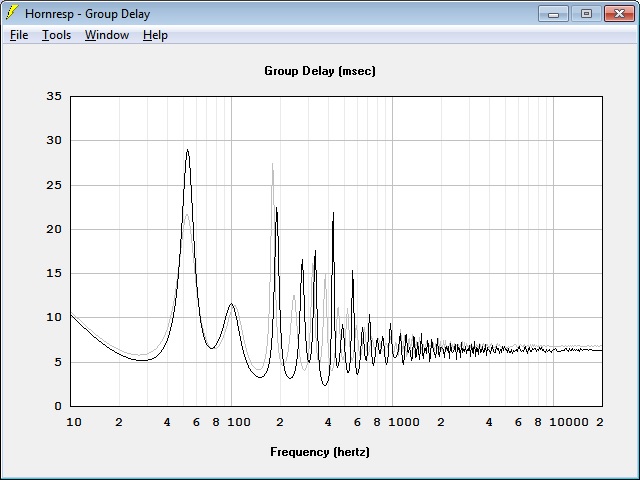

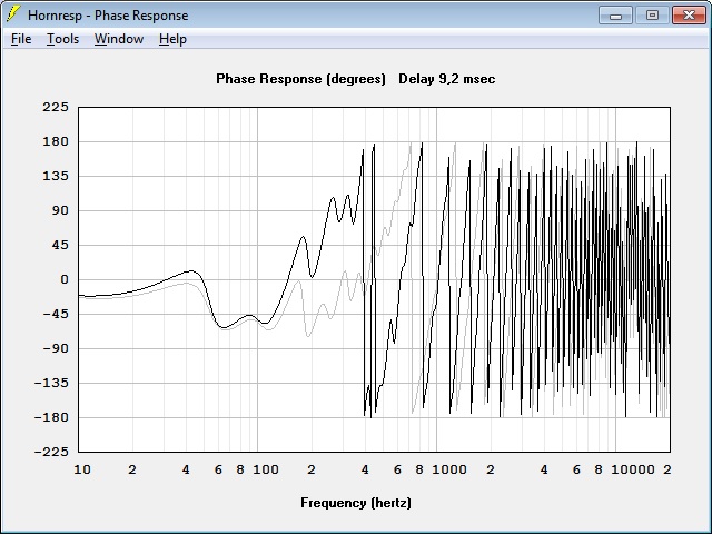

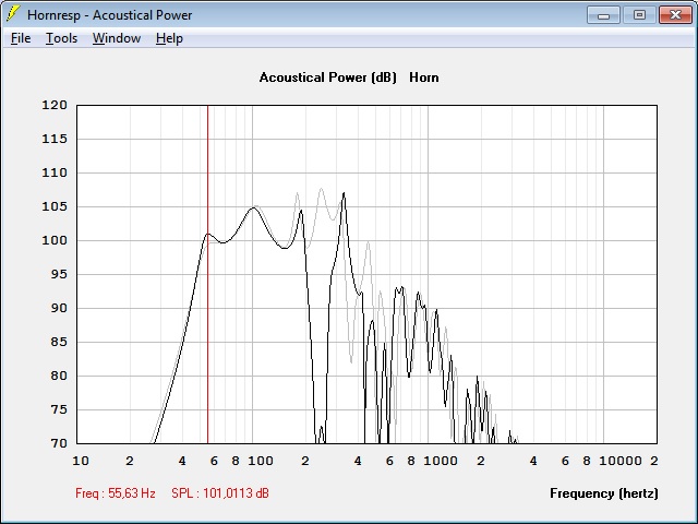

No problem.
This is just a game of playing with the flare shape to place the impedance peaks where you want them. I've been doing this for awhile so this didn't take more than 10 minutes.
First goal - keep my examples roughly the same size as yours (110.527 liters).
Goal 2 - keep S2 and S4 on auto (no more than 2 different flare rates).
Goal 3 - try to match your response curve, especially the low knee (can't beat it without using more space, so the goal was just to recreate what you had with different shapes of flare)
Comparison 1
Your design compared to a simple tapped horn. I couldn't get the peaks to match yours in position (frequency) in the size I was allowed so yours has a bit of advantage from 60 - 200 hz but the simple tapped horn has the advantage everywhere else, and it has more bandwidth too, with slightly less excursion. If I was allowed more degrees of freedom (S2 and S4 manual and or a few extra liters) I could match your response much more closely. Same power applied to each, same sensitivity, same size (mine is 1.5 liters larger).
Comparison 2
Like I said, a bowtie shape will get your the same response so the method of achieving it isn't very important. This is your design compared to a bowtie shape, same power applied, exactly the same sensitivity, almost the same size (bowtie is 11 liters larger than yours). S3 is a bit small but this is just an example to show how you can get just about whatever response curve shape you want, and you can do it with different flare shapes too.
I've said this a few times but it bears repeating. There is no magic design or alignment that produces more resonant output than others. For a given size they are all pretty similar.
You have a handful of impedance peaks to work with. The size of the enclosure (and boundary loading) determines max potential resonant output. The flare shape determines the spacing between the impedance peaks and how strong each of them individually will be.
If you space the impedance peaks close together you can get response peaks, or a sensitivity boost over a small passband (like a peaky 6th order bandpass). If the space the impedance peaks evenly you can get 3 octaves of resonant output but without the peaky response.
You might be surprised how far you can push this idea. I've simulated, built and measured a massively undersized front loaded horn (100 liters for a 6.5 inch driver, 30 hz low knee), it had almost ruler flat response (no rising response and peaks no bigger than a ripple) and high(ish) sensitivity for two octaves. I could have made it much smaller and maintained the flat response but without the sensitivity.

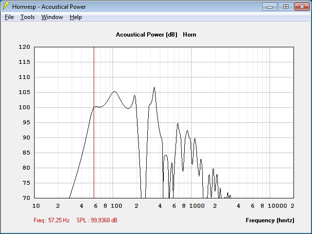

I forgot to include a schematic of the original design.
After a bit of refinement I recreated your response curve almost identically (with the exception of a greatly increased bandwidth) with a simple tapped horn. (See what I mean about getting the same response with different flare shapes?)
The simple tapped horn is 10 liters larger, same power applied to each.
One final example, a front loaded horn, same driver, same size enclosure compared to your design. Same power applied. The flh has much less excursion so given enough power it could go considerably louder within xmax. Compression ratio is a bit high, but again this is an example to show how the response curve shape of the original design is easily duplicated by entirely different designs.
I could probably get a better match if I spent a bit more time but this should show that regardless of the alignment - ported, tl, tapped horn, back loaded horn, front loaded horn - the resonant output is determined by the size of the enclosure.
Also, regardless of the alignment, adjusting the flare shape will give you just about any response curve shape you want.
I don't find the response curve shape of the original design to be very attractive but it doesn't really matter because anyone can have any curve shape they like with a little adjustment.
Thanks Just a Guy for taking the time and effort for some very interesting simulations and comparisons.
I let my THBP catch up on size to your last TH.
My basis for this thread was this:
"If you try to get a high power density from powerful (low Qes, High Bl, high mms) drivers like B&C 12NW100 in a tapped horn you get a very high compression or a very deep depression in the middle of the passband, like i show below"
And compression is something i take very serious in these kind of high power applications.
200 cm2 is the absolute highest compression i can accept in my design, but i really don´t like anything below 250 cm2 (S2). I had a Beyma 12LX60 in a tapped horn with 250 cm2 S2, and after about 5 seconds of some bass-heavy music driven by my bridged QSC RMX 1450 (not clipping) (800 watts into 8 ohm) the cone cracked and buckled. The B&C 12NW100 is a more powerful and more robust driver, but i still don´t like to much compression. I seems fine in Hornresp, but when driven hard, failure is just a matter of time or a dropped microphone away.
The deep depression above the intended passband is not a fault. It is an advantage. It will lower distortion substantially...
Again, Thanks for some very interesting simulations!
Johannes
