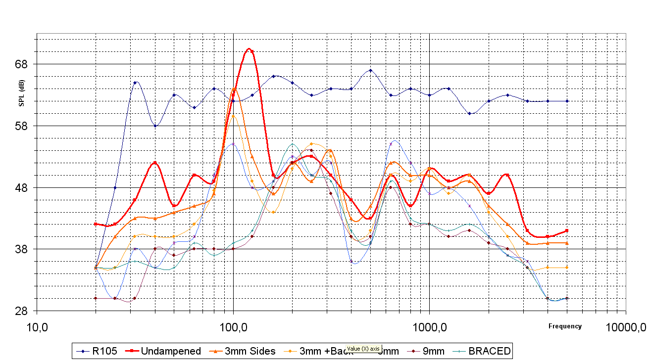

I made a test some years ago to test the effect of gluing bitumen sheets to the inside of a cabinet. Not constrained layer though.
To make the test, I built a 200lt cabinet using 20mm birch plywood and made a removable front baffle that had a 40lt subenclosure (cube) with the baffle sealed. A 12" woofer was mounted on the inside face of that cube, firing inside the 200lt cabinet (to the 160 or so liters remaining).
I made frequency response measurements using a warble tone generator and a measurement microphone located at 1m from the enclosure. All tests were done with the amplifier at the same settings.
On the graph attached, the first plot is of a KEF reference 105 speaker - for reference of the measurements (to show any room effects). You can see some of the effects, like a peak at 33Hz, another one at 500Hz, and so forth.
The second plot (as per the legend) is of the test enclosure without any layering. The levels (save for the resonance at 120Hz) are lower than the free firing R105 since the 12" woofer is totally enclosed in the 20mm cabinet. However, the levels aren't that low and I could clearly hear the tones.
Third plot is of the enclosure treated with a single layer of 3mm bitumen sheets fully covering the inside of the side panels only. Some resonances are tamed and the main resonance at 120Hz drops both in level (-6dB) and frequency (-20Hz).
Fourth plot is after applying a single layer to the back panel as well. There is still a noticeable drop in the main resonance as well as throughout the spectrum (useful spectrum that is, 20Hz ~ 300Hz).
Fifth plot is after applying a full second layer to the inner surfaces (except the front) and the next one after applying 3 layers.
Finally I braced the cabinet just below the middle of the height. That gave some effect but IMHO not that much. I must point out that at the third layer (9mm), I had issues doing the measurements and had to increase the level of the amplifier by 12dB (as measured with reference to the R105 I used) and then subtracted them from the plots. The level produced otherwise was so low the meter measured the sound of the leaves brushed by the wind outside through closed windows...
My next experiment will be to build an enclosure out of 4mm plywood alternated with 3mm bitumen sheets. It's a simple idea but I've already found several technical issues to construct - and I haven't even started the process yet.
I do agree that the thicker the wooden panels, the more the damping material needs to be for effect. And believe me the last layer of bitumen was applied with the cabinet resting on it's back on the floor. I could not lift it up on the bench by myself.
