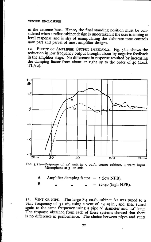

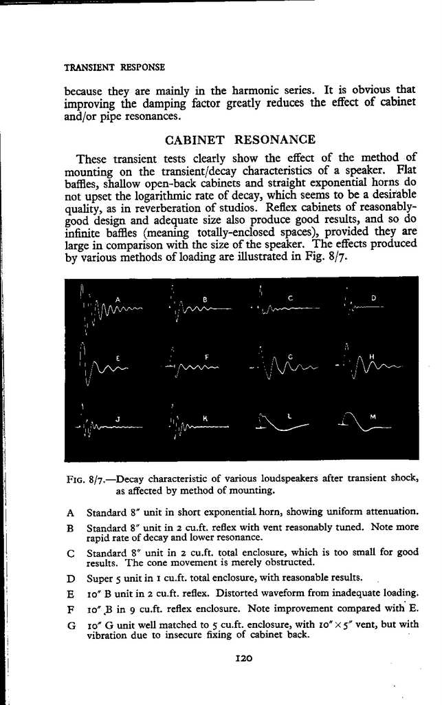

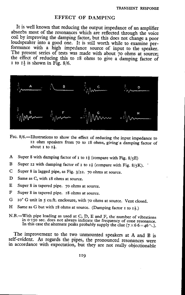

Amplifier and speaker Damping
Some practical examples of the effect of Amplifier and speaker damping from the 1950’s, “Sound reproduction” BY GA Briggs.
Speaker damping is affected by magnet size and quality, design of the voice coil and type of box.
Very long speaker wires will also have some affect.
Some people love the Bass Bloom you get by using low damping factor Tube amps and poor speaker damping. Nothing wrong with that!!
