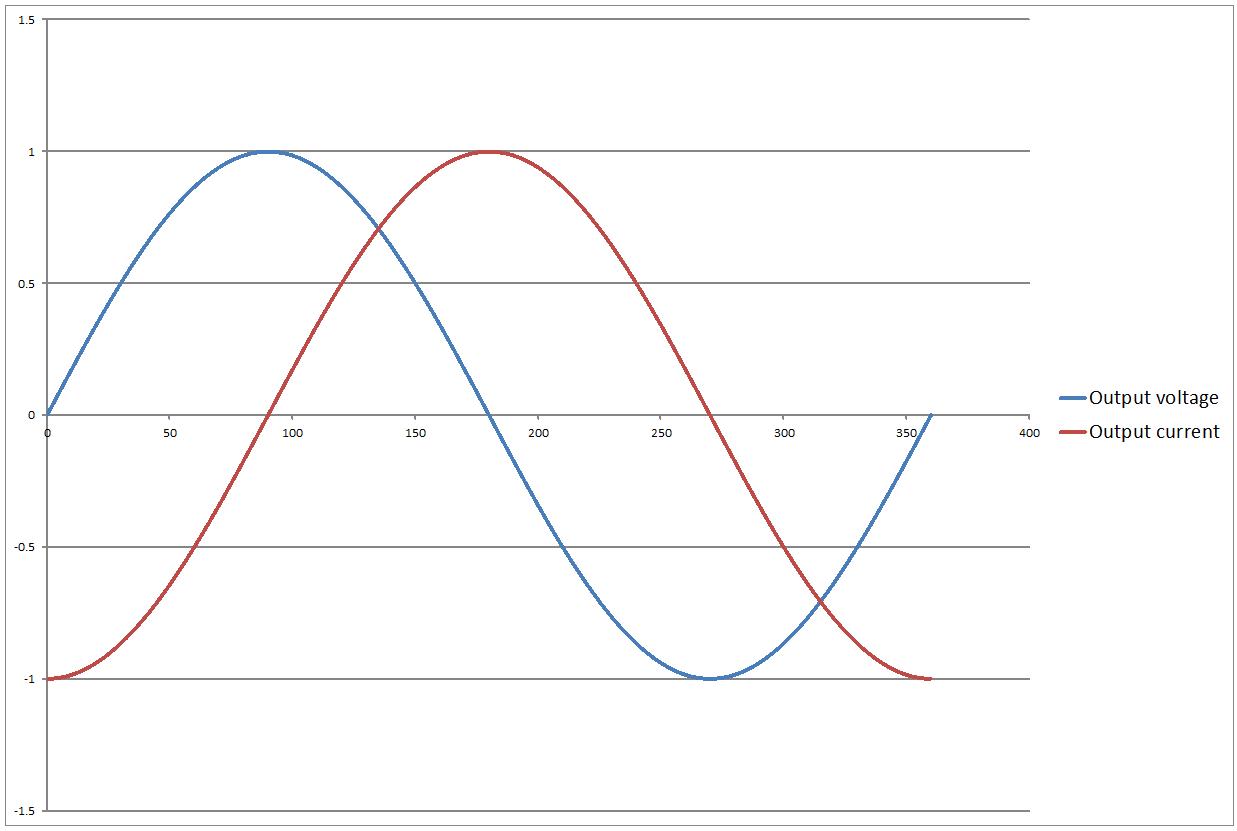

Second try, man that excel beat me up...
Here is the basis for my discussion of damping factor vs quadrant of operation.
The time graphs are all normalized with +/- 1 as levels, the timebase is 360 degrees wide.
First is a time diagram of an inductor driven by AC. We all know ELI the ICE man, note that the voltage (E) leads current (I). Note that this is a steady state representation, NOT starting at zero, but continuing through zero.

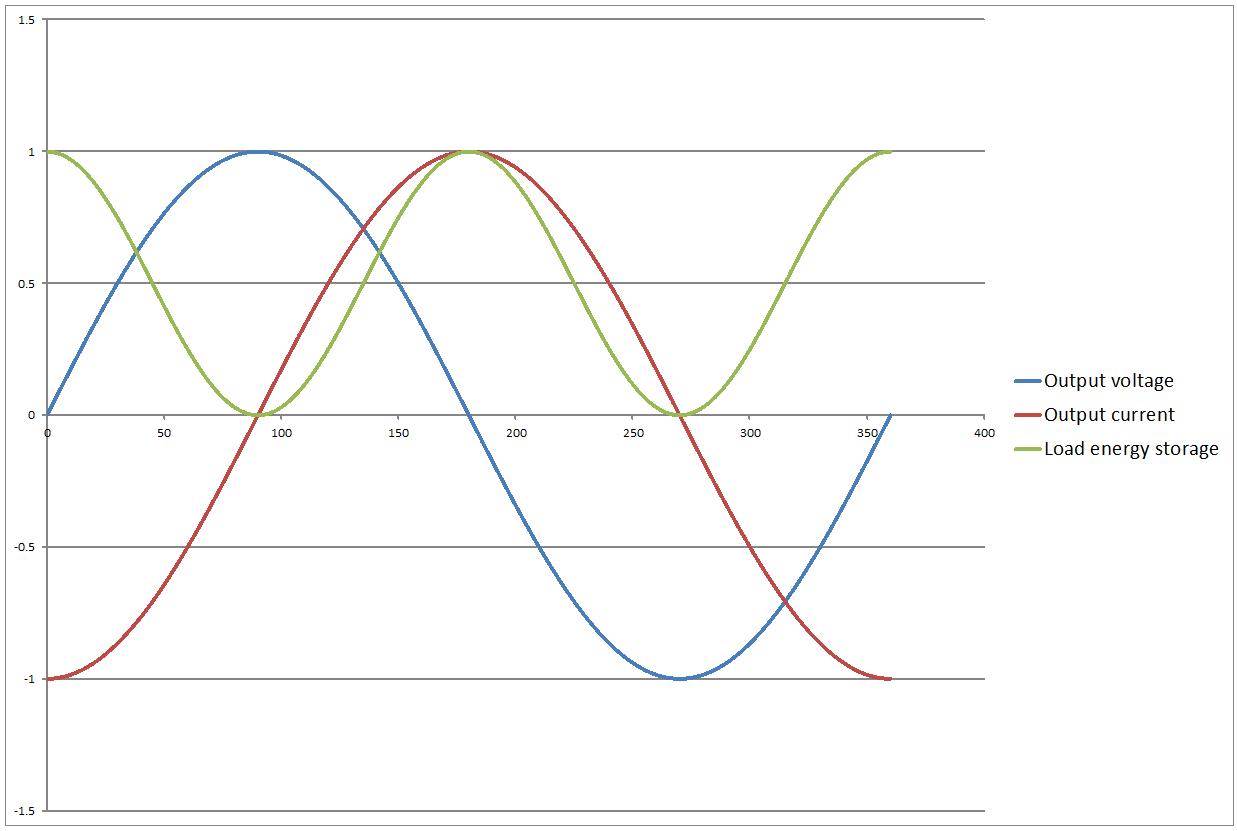

The second shows the energy storage within the inductor. The energy within an inductor is E = 1/2 L I(squared), so shows as twice the frequency (note that I simply squared the current, so energy only goes to 1 max, current and frequency are scaled accordingly with relevant L and F included.) The nature of the beast is that the energy returns to the line when it is driven off the wall socket for example. A power supply transformer does exactly this, and one will find that there is current driving it. Note also that EMF is driving the energy back into line from the inductance, non linearity is NOT required for EMF.

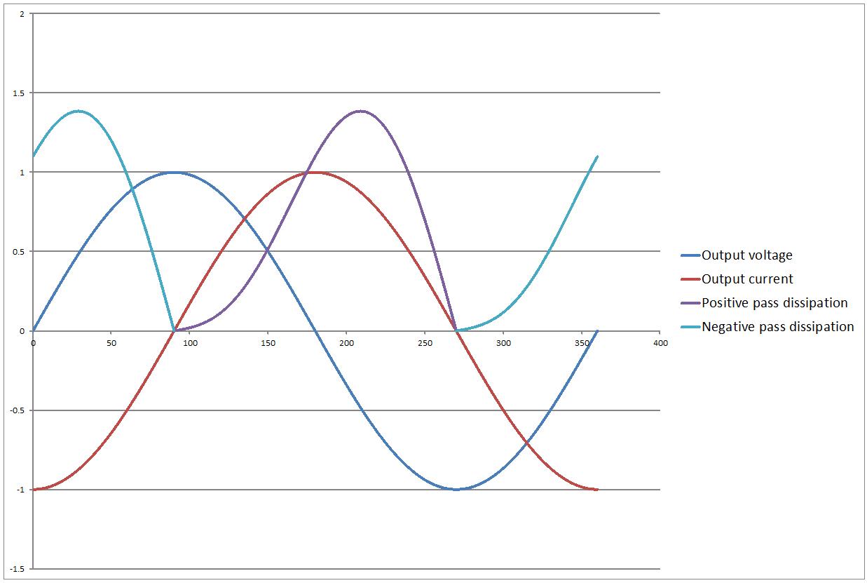

The third shows the pass element dissipation as a consequence of an inductive load. I normalized the rail voltage to 1.1 as a reasonable guess. I separated out the plus and minus pass elements as light blue and violet. When current is positive, the positive pass elements are the ones supporting it, and neg current requires the negative pass elements. Note the two dissipation lobes are zero when the current passes through zero. Note also that the dissipation is maximum at a point that is not concurrent with maximum voltage OR maximum current.

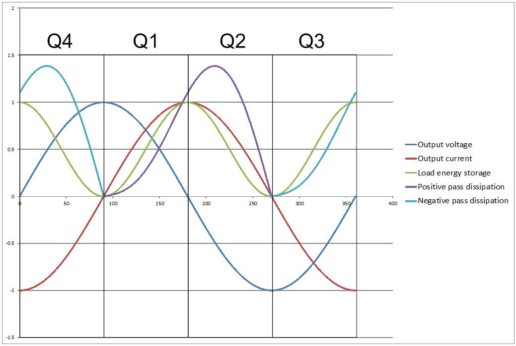

The fourth puts all the curves together. Quadrants have been labelled, see below... Of note here is the fact that maximum pass element dissipation occurs during the discharge of the inductive storage. We spoke a bit of this earlier, in that the amp dissipates in trying to keep the output node at zero, and the load is responsible for dissipation of it's own stored energy. Since this is a graph depiction of an inductor with no resistance, no consideration of the load dissipation has been included.

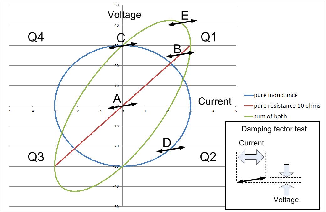

The fifth is the VI graph. The blue is a pure inductance, the red is a pure resistance, and the green is the sum of the two.
I also labelled the quadrants (be careful, I changed the numbering to CW increase from 1 to 4, I previously went CCW in my last description. This direction (CW numbering) will be the convention I use from now on.
edit: The question becomes: is the damping factor as measured through the origin with current driven signals the same as measured anywhere along the red resistive line? And, is it the same if measured anywhere along the ellipse cause when reactance is included as part of the load?

Here is the VI graph with several points of interest attached.
Damping factor is measured by forcing current into the output node and measuring the resultant voltage deviation.
At point A, the amp is on but quiet.
B; the amp is pushing into a resistive load, and is then prodded with the measurement current. This can be forcing the amp with a DC signal, or using a LF drive with the damping drive at a second higher frequency, perhaps consistent with a midrange frequency.
C is measured when the output voltage is maximum yet the output current is zero.
D is somewhere in the middle of reactive region, somewhere near maximum pass element dissipation.
E is peak VI product in the resistive quadrant.
I am unaware of any damping factor discussion or test which considers these entities, there may be some out there.. However, to assume that the damping factor everywhere in the VI space being exercised is the same, well I've not seen anything to support that assertion.

As a first pass, I'd try for a resistive one superimposed on a complex output signal.
Set the amp output at some DC value. In the prev pic, set the output at -22 volts. (location "D")
Push or pull current from the output node with a current sink. In the example pic, pull the out towards the negative rail with 2 amperes. (not to ground, that's just what everybody would expect..)
Drive a hf signal into the output node with a current controlled device.
Measure the hi freq amplitude of the output voltage ripple. As well, spectra of that ripple may prove interesting (or, it may not)..
By varying the DC out and the current pulled, one can test the entire amplifier output space.
Of course, ya hafta use realistic numbers for the amplifier being tested. My pic uses 50 volt rails, pulling 2 amperes with an output setpoint of -22 volts will drop 144 watts dissipation into the positive pass devices..
