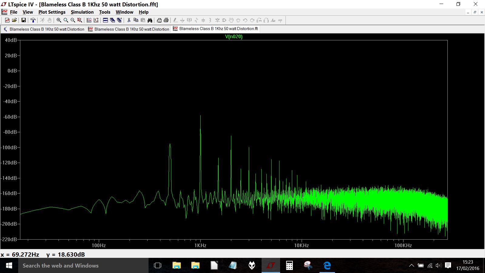

My reaction is that a current fed back into the amplifier node does infiltrate the nfb loop. A speaker is generating all kinds of uncorrelated signals in response to the audio stimulus around it.
No. The effect of a voltage applied to the amp output is fully described by the amp's output impedance.
Lets take an amp we all know, the classic 'blameless'. I've added a 500Hz sinusoidal current source of just 10ma feeding back into the output node. That 500Hz is clearly present throughout the whole amplifier. What is more, that 10ma current source is in series with a 10 ohm resistor. You would expect the damping factor of the amp to 'sink' the unwanted signal to a minuscule residual but apparently it does not.
This shows the FFT as measured at base of the VAS stage. The 500Hz unwanted signal is clearly present 'within' the loop.

Yes. This is how feedback works. What did you expect to see?Mooly said:The 500Hz unwanted signal is clearly present 'within' the loop.
I would not expect that. What is the output impedance? I would expect to see 10mA x Zout at the speaker terminal, less at the feedback summing point and then whatever is needed within the loop to command the output stage to sink 10mA.You would expect the damping factor of the amp to 'sink' the unwanted signal to a minuscule residual but apparently it does not.
Of course it is present within the loop. That is so that the feedback can do it's job, which is just to generate a compensating output signal. The important question is whether it is present at the output.

Honestly... well I expected to see a fair bit lower than it apparently was... OK, that's my fault for shooting from the hip and not thinking the numbers through.
It is present in the output.
In fact if the simulation is in the right ballpark, then the residual of an 11kHz 10 ma injected current is now the (dominant) unwanted feature in the FFT (main wanted signal referenced at 2.83 volts @ 1kHz 8 ohm)
Mooly said...You would expect the damping factor of the amp to 'sink' the unwanted signal to a minuscule residual but apparently it does not.
