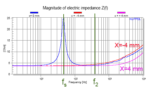

Quote from PRR:
"Distortion will be unchanged. Voltage, current, same thing just factored by impedance."
This would only be true if the loudspeaker had a perfectly linear relationship between voltage and current, which it has not, for the reasons explained in one of my previous posts and further clarified by Dimitri.

I've been away a bit... I don't know if I agree with the following, PRR:
Acoustic output is not a function of cone velocity per se. It is a function of cone displacement which is proportional to net force, which is determined by coil current, which results in a net acceleration a=F/m. At no time does the oscillating diaphragm possess velocity in the constant sense. Unless you mean angular velocity...
And impedance characteristics varying as they do wrt frequency, I repeat my perception that current drive of a speaker appears more natural/logical...
The relationship between applied voltage and flowing current is not linear in a speaker. This being so, it is *only* the current in the coil which generates flux and thence force. The voltage which caused the current is irrelevant.Velocity is proportional to voltage, and for cone speakers the acoustic output is mostly a function of velocity, not force.
