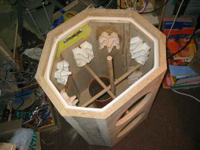

I must admit that I have never taken a definite aproach to the stuffing of the box, for industrial speakers I tend to use fiberglass, at home a mix of polyester and open cell foam, preferably pointy egg crate style which I place a small amount directly behind the driver on the back wall, the rest of the surfaces polyester stapled.
My main aim has been to try as many different materials as possible and I vary materials for different sounding rooms.
Most of my foam has been bought from Clark Rubber stores, and they have a range of different styles, my favorite is the yellow matress underlay, followed by the gray coloured cut to order one.
I find the pointy ones great for improving the clarity of the woofer in a standard style of box, so that it sounds a bit more like a better shaped box, ie 7 or 11 sided box, but without the effort.
well thats my 2 cents worth, all I can say is enjoy the difference that this can make🙂
