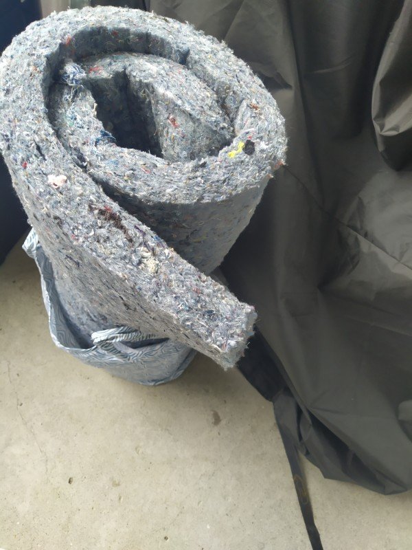

I just bought some damping material to play with. Bought it in a big hardware/construction store. They sell it in big quantities, though they were willing to sell me just one sheet, for about 5 euro.
Looks like some recycled wool, sort of. Doesn't look pretty, but it may be good enough.

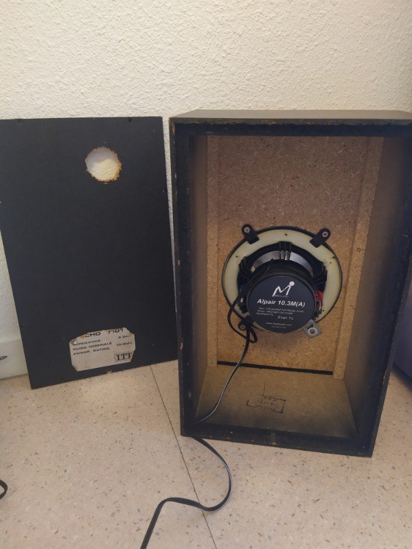

Btw, for no apparent reason, I am playing with some old/recycled boxes, and their cutout happened to match Alpair 10.3. So...why not. Though they are a bit small, around 10 L...
(if vented doesn't work, I can always drill many small holes on the back of the box, and make it aperiodic 😀 )
