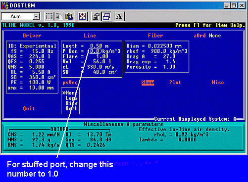

The imaginary speaker I used has:
Fs = 15 Hz
Qts = 0.24
Vas = 224 liters
SPL = 86.8 dB @ 1Meter/1Watt
The box is 56 liters tuned to 30 Hz.
Here are the Thiele-Small listings and screen shot of the Bullock-White Transmission Line Box Modelling Program, version 1.3. Shown is how to model between stuffed and unstuffed ports for the same box.
Fs = 15 Hz
Qts = 0.24
Vas = 224 liters

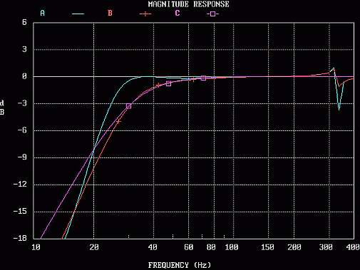

Here is the frequency response charts for the identical box with both a stuffed line and an unstuffed line.
Unstuffed line in Light Blue.
Stuffed Line in Red.
Sealed Box with a different woofer and larger enclosure, with a Qtc of 0.7, and a response and F3 identical to the stuffed line in Purple. This is for comparisons with cone excursion.

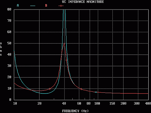

Impedance chart for stuffed and unstuffed port. Note how the stuffed port moves the resonance frequency down slightly. Remember the speakers and enclosures are identical except for the stuffing in the ports.
The unstuffed port resonance means the box is tuned to around 27 Hz, not 30 Hz as I stated earlier.
Note how the stuffed port also has a lower impedance at the high resonance peak. In other words, it is making the speaker act a little more like a closed box.

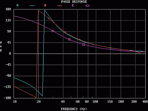

Here, on the impedance phase, we see that the stuffed port acts very much like the unstuffed port.
The purple line is the closed box with the frequency response identical to the speaker with the stuffed port. Very, very different.
Unlike the impedance plot, there is little evidence the stuffed port makes the speaker act more like a closed box at all in this measurement.

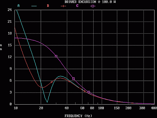

Here we see the notch in the cone excursion is lessened in the stuffed port box, but it still gives substantial relief to the woofer.
The stuffed port speaker only has to move about half as much as the closed box speaker with identical passband response at 30 Hz, which is F3. The stuffed port box only has to move about 75% as the closed box speaker one half octave above F3-which is 42 Hz.
Again:
The unstuffed port is in Light Blue
The stuffed port is in Red
The closed box with frequency response identical, (down to F3) to the stuffed port is in Purple.
So here we see some evidence that the stuffed port acts somwhat like a closed box, but still retains most of the characteristics of the bass reflex.
