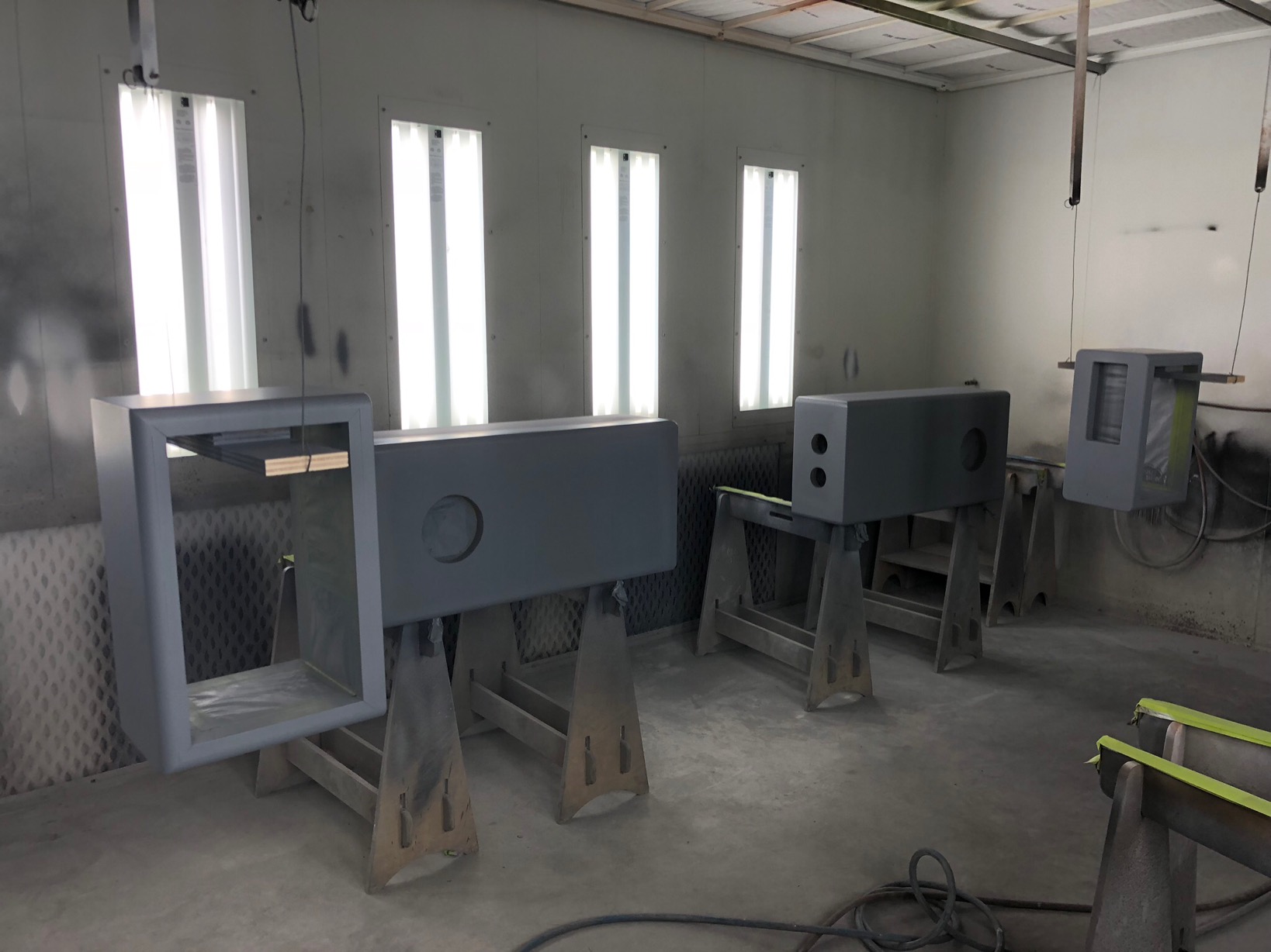

Last weekend I ran the router and shaper around the speaker cabs and the matching cases for the F5 Turbo v3’s. Cut out for the drivers, ports, rear panel and venting on the amp cases.
Today, after a little pre-sanding, I shot 3 medium wet coats of automotive primer. I’ve learned on previous projects it’s better to get the primer on before spreading any filler on joints and nail holes.

Since Presidents Day was a free day for me I spent the day prepping the cabinets for paint. Filled nail holes, wood seams and joints with Rage Gold body filler. After a good half hour sanded it and the primer with 400 grit using both a 3M short sanding block and a Snap On DA. Then 3 more coats of 2k primer. This was 8 hours.
Primer dries fast enough that I could prime and wait a bit, flip the cabinet and spray the last side. Not going to work with finish coat. Due to the weight of the speaker cabinets I couldn’t figure out a good way to suspend them like I did the amp cases. So this afternoon I final sanded the bottoms with 600 and sprayed 2 coats of paint. I’m using Nason Ful-than 2k urethane, single stage automotive paint.
If you notice in the pics I’m using a little trick on masking. If you stick the tape on the material, then pull back the edge your going to paint up to, you create a softer feathered edge, instead of having a tape line
Now this weekend I should be able to sand and spray out the balance with the cabinets standing upright.

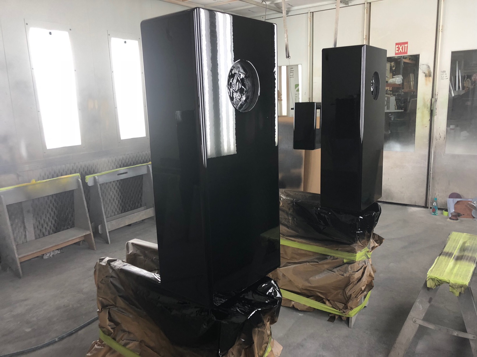

I worked all day today on the cabinets. The overall finish coat was pretty good. But since I’ll be looking at the front more critically I decided to color sand and buff just the fronts. 1000 grit, then 2000 grit, then 3 stages of polishing using 3M pads and matching compound system.

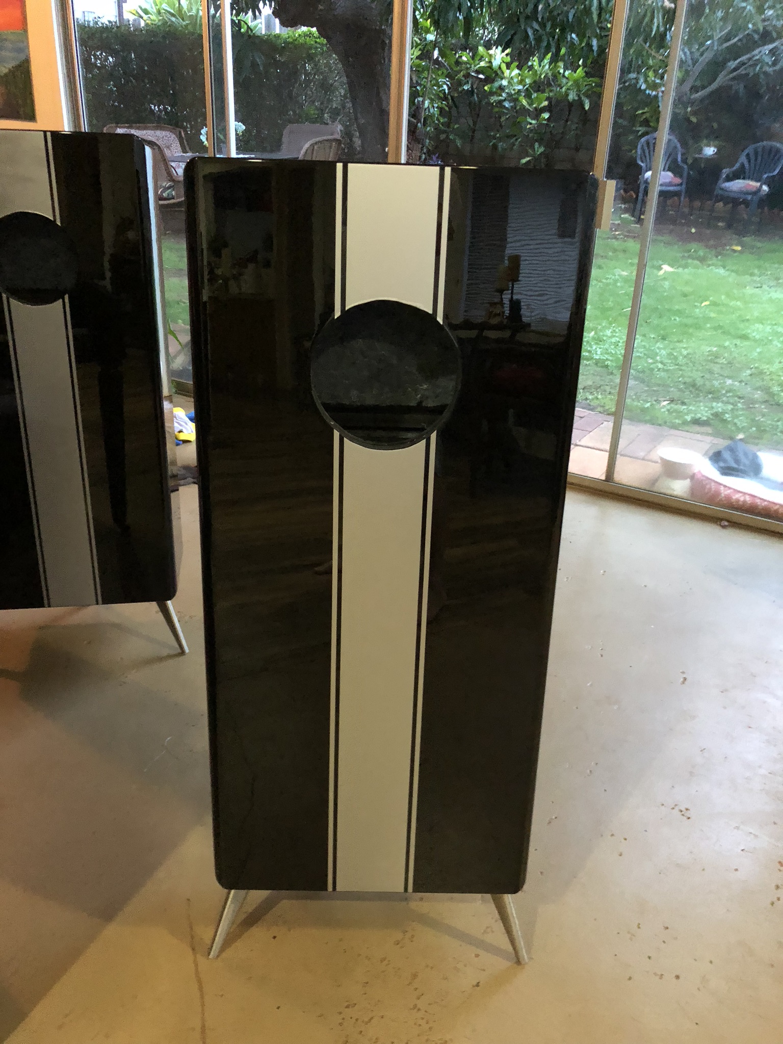

With such a nice automotive finish it has to have racing stripes!
Not easy to see in the pic but the rear center mounted leg is 3/8” shorter than the front two, makes about a 5% angle back.
Time permitting tomorrow I’ll try to install the drivers and binding posts and see how it sounds.
Some specs on the cabinets with the legs. They are 46 1/4” tall, 19 3/8” wide, 10 1/2” deep, the driver is 37” AFF. And without a driver they weigh 95 1/2 lbs, each!
… but the rear center mounted leg is 3/8” shorter than the front two, makes about a 5% angle back.

A single front foot with a pair in the back would be a little more stable with the tip back.Simiar to what we did on our Ellispa WAW, except, taking a hint from Triangle, 1 foot on th efront under the drivers and 2 on the back. Chris had to turn around the custom aluminum footer plate he had built for them.
dave
I have enough mass that it would take a good whack to tip these back though.
Stability isn’t the goal… giving the drive unit the best possiblr=e environment to function in, is.

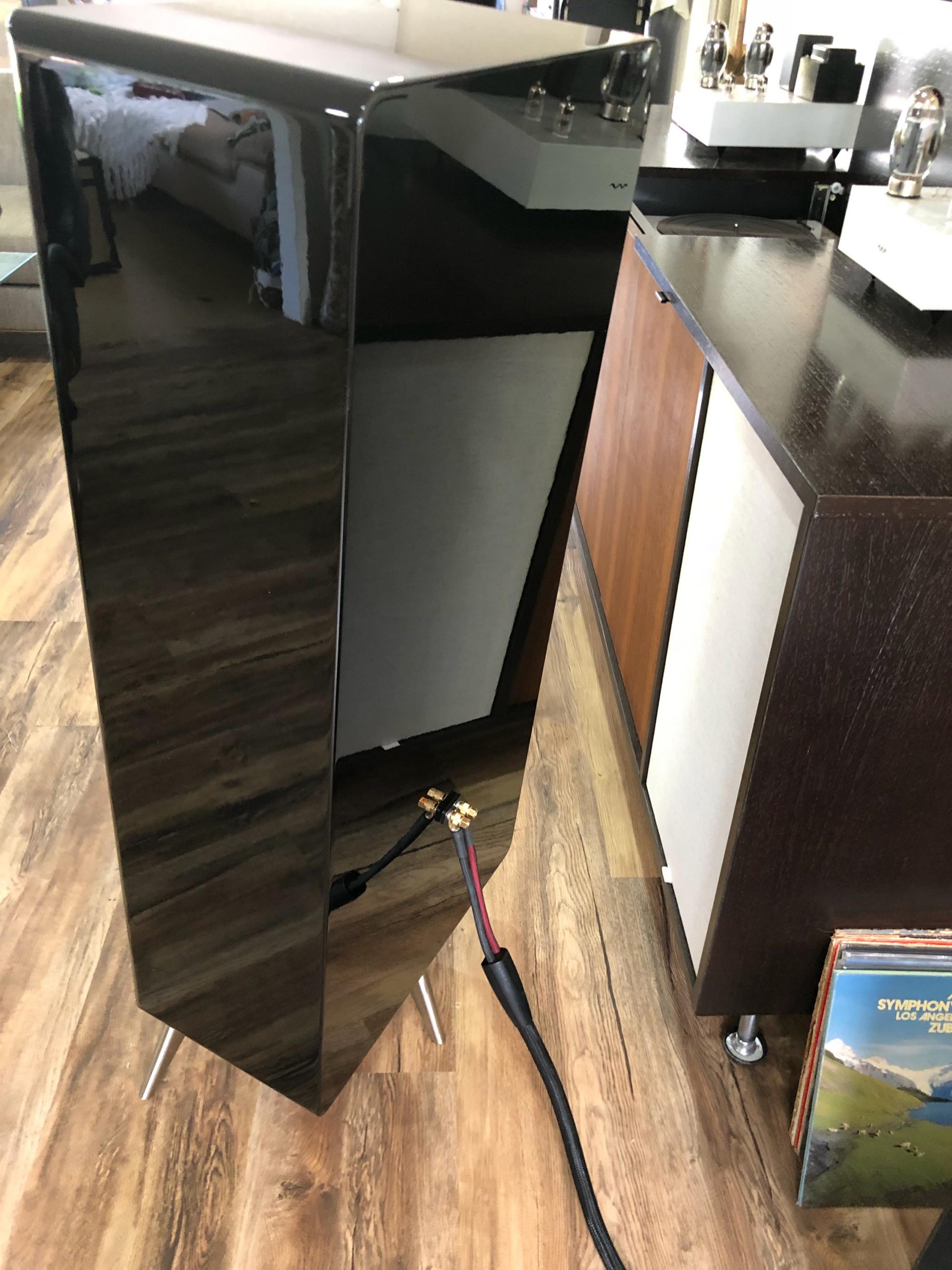

This morning, after installing the binding posts (Cardas), wire the driver, (12 ga wire from Transparent), and installing the drivers, hooked them up. I weighed the drivers, 7 lbs. that makes the total weight of each speaker over 102 lbs.
To try them out I hooked them up in my living room, pardon the mess, the Mano and amps don’t usually sit out on the console. Equipment was the Mano, the RAKK DAC, McIntosh C2300 pre, and SST-70/KT150 K&K Audio designed amps. Interconnects and speaker cable all Transparent Super.
Of course, since I’m prejudiced after spending my last few weekends building them, I’m going to say they sound good. In reality I really think they sound great! Actually a little surprised. I need to move them into my inside “shop” and play around with them now to really judge.
The ports are just the holes sized for the pair of 2” port tubes and the cabinets are over half filled with blue jean insulation. First round I left the pair of subs off and was surprised as to how much base. I angled the speakers to cross just in front of my listening position and the sweet spot was pretty large. Walking around the room the music sounded full. Even though the sweet spot was a better place to sit and listen I didn’t feel like I was missing everything not sitting there. I turned on the pair of subs and, as you can imagine, the music was fuller and deeper. My living room area is fairly large and open to an equally sized sunroom. So no normal sized speaker is going to gain much from the room.

They look like the solid copper ones, i had to use a pair of those once, don’t like tham at all.
Also the FR drivers do not use the current that the 12g can deliver, it behooves you to try some skinny (like 24g) solid wire and see if you like the difference.
