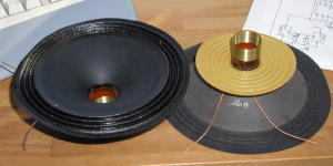

This afternoon , I was speaking with a technician at Focal. They don't supply any spare parts for drivers under 10 inch. The only answer is to return the driver at the factory, because the driver must be totally rebuilt with new process.

1. It would be cheaper (thanks to customs, shipping etc) for em to buy new drivers than return these for repairs.
2. I have emailed e44 but no news from them
3. I am more worried about getting recone kits for the Focals as there are 4 of them and they are heavier to ship and since they use edge wound flat coil it is difficult to get the wire here.
Thanks a lot anyway. If you can contact e44 (if it not a problem) maybe they will respond to a phone call. I can send you a copy of my email if need that.

Peter, does it make sense to use the recone kit for another Focal woofer that fits in the gap.
If so I would need to get the coil dia, gap, etc. of the 8N515s.
The Lvc is 16mm, the Hgap is 6mm and the Dvc I think is 25 or 40mm. Would Orca know and be able to help.

1. Given the fact that I cannot buy/import new driver what is the best solution?
2. the woofers are 8" Focal 8N515 with Neoflex cones. I dont think Focal uses Neoflex cone anymore. Although I got my drivers in 1987 I got these specs fro JMLAB / Focal on 17-Mar.-98.

I was talking to Mark from Orca at the folowing number 805-484-4355 and he just confirmed what was said before. Focal doesn't provide any cone kits for drivers below 10" diameter. Sorry.

he had the balance knob over to one side so that is why the second channel had no sound. When I set up the system I had told him not to touch anything but the volume knob....anyway now we have a different problem.
One channel is blown. That means of 4 Focal woofers 2 are ok 2 are not. Of 2 Audax mids 1 is ok 1 is not.
Now the question is if I can get the Audax recone kit. If I can get that I can junk one pair of Focal woofers and build a 2.5 way using 1 8" 1 6" and 1 tweeter per channel.
