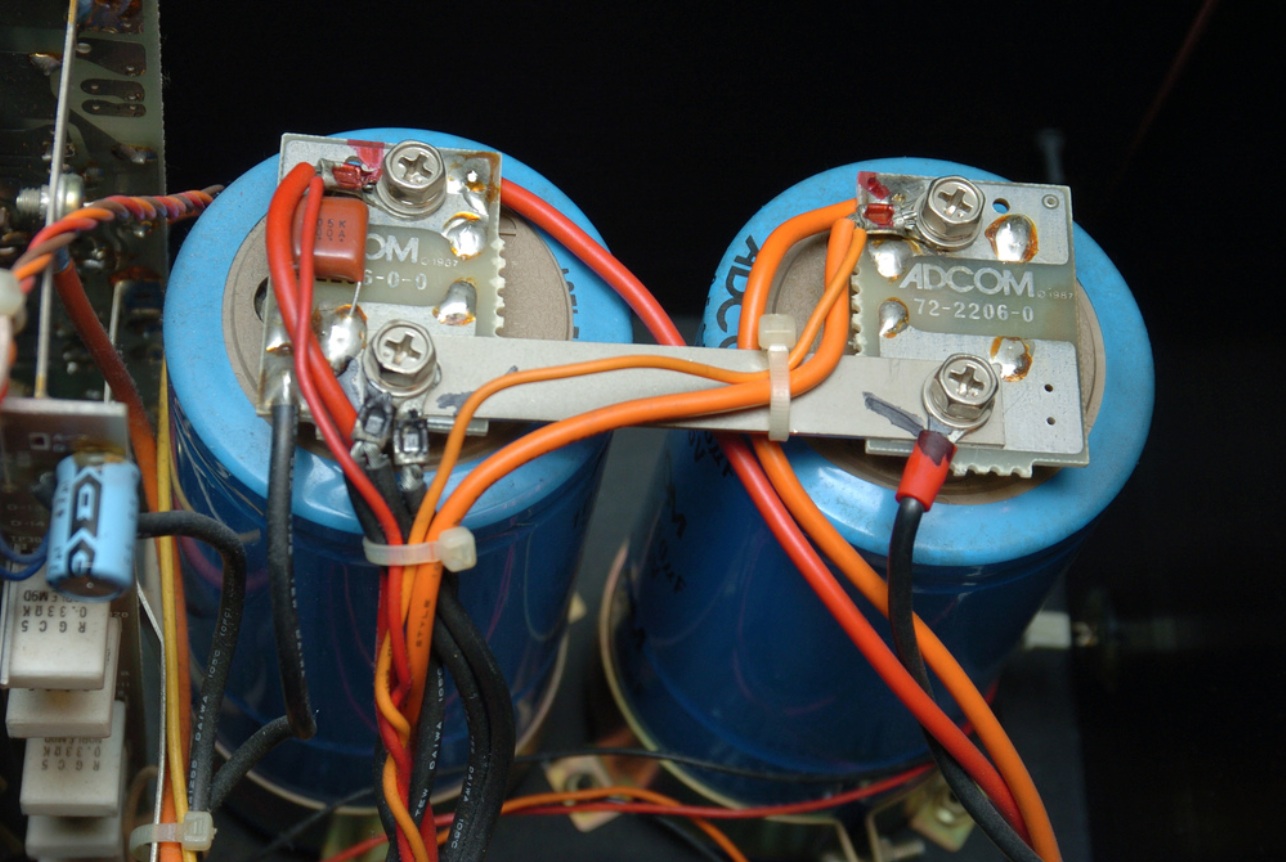

I noticed that in MJRs photo, and also on my amp, the 0.1 uF capacitors C803/804, and 8.2 K Ohm resistors R801/802 (the ones on the big filter cap boards) are missing. Is this a known improvement, or more work of the evil/stupid service tech?
The 1 uF/100 Ohm cap-resistor circuit is present on my system (and MJR's).
MJR's Photo:
MJR's Photo:
