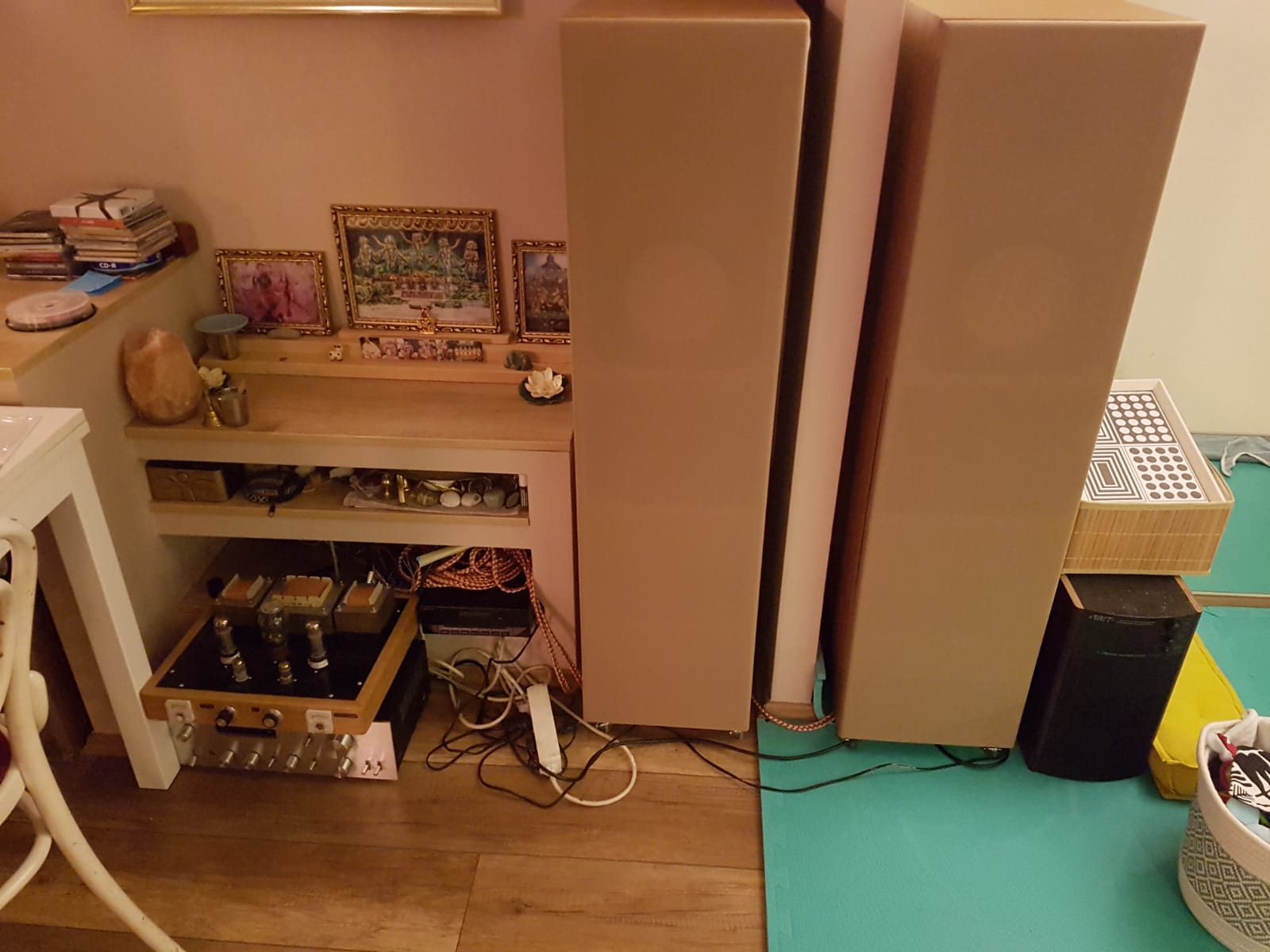

One of the nicest builds I've seen. Give them 200 hours of play and the bass will improve quite a bit.
Lovely,
I really like how they look like a standpoint from th eright angle, add the grill it turns into a boring (but pretty) monkey coffin.
I like teh traetment of the rear, with the additional external braces to sqaure the box up.
One question: You couldn’t get the tweeter closer to the FR?

Thx dave!
And big thx for help!
And yes,i could put tweeters closer to the FR...thats the biggest mistake i make...
I realize this when i put them to test them.
When i seat on couch,then i see how FR is directly in ear level,and tweeter in level with top of my head...then i hit that point of the head...hard
Its not so bad,because tweeter radiation angle is 45/45 so is more or less no diference when you sit 4m from speakers.
But you have good eye,it would be better if i put them lower,closer to FR.
At least 6,7 cm closer to FR is still enough space to put them...probably even closer...

And yes,grill take away all nectar of the speakers,but,whit small unpredictable kinds around them,grill is the only way i will have pieceful mind when im not home🙂
And what are you think about improvement on places where horn is folded?
It seems like it works great.

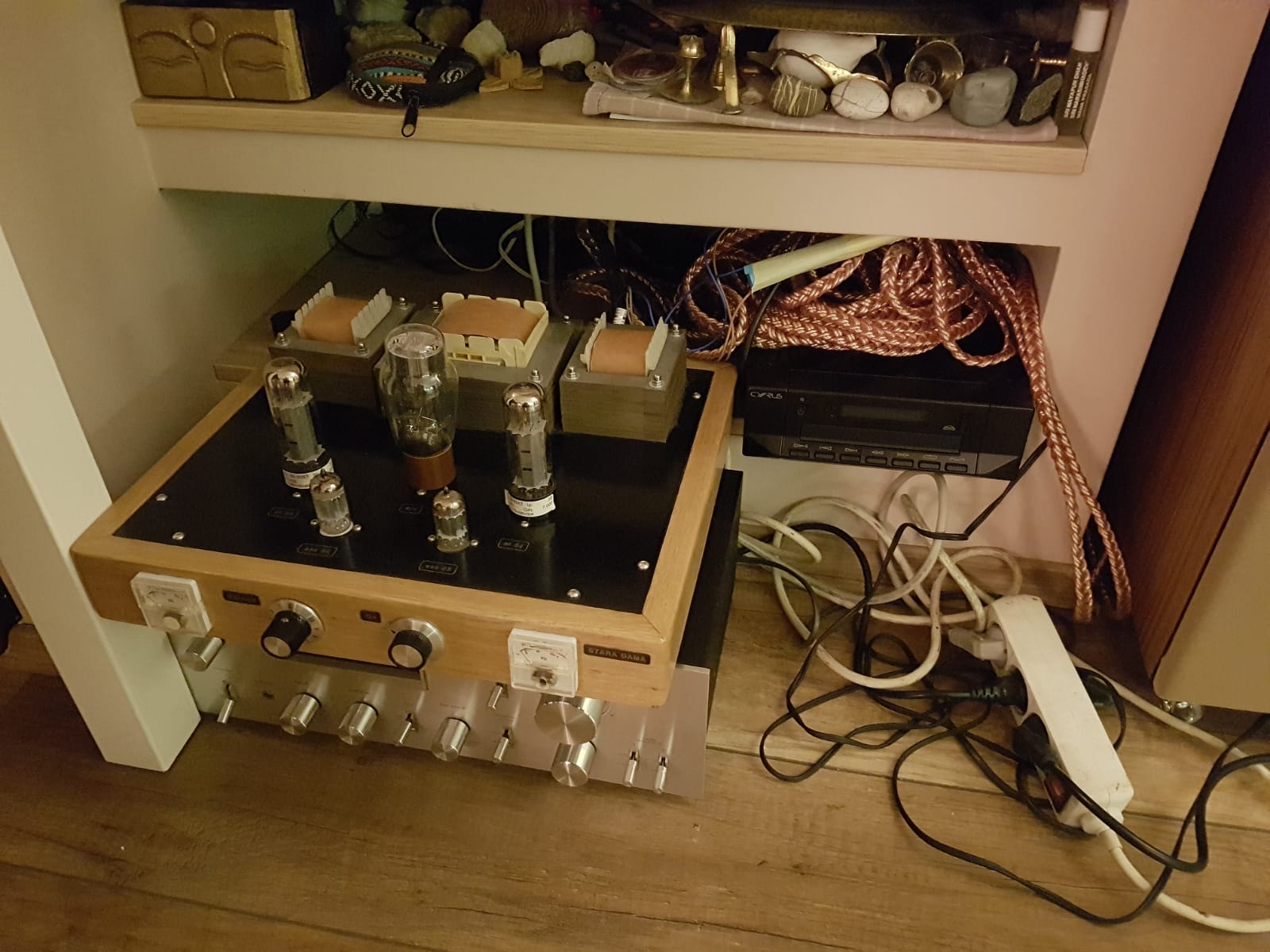

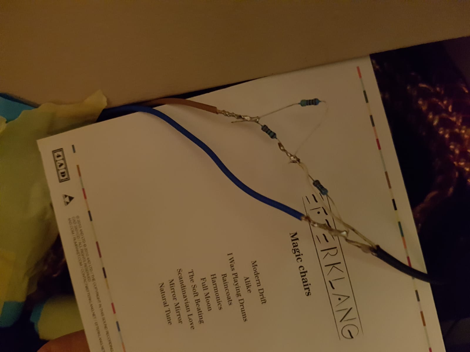

I wait enough for bass to increse to the level with which im satisfied,but,that didnt happen.
Bass improve nicely,but still not enough for my 15 years bass playing ears.
So i decide to try with subwoofer.
Cheep sub,it have 2 drivers inside,mount in 45 degrees,and box is cca 30l.
I conect it from speaker output.
I have to make cable to convert singnal from speaker to line becuose sub dont have high level input.
After testing i find the right resistor value so the sub level can be at min so i have no distorsion of sound,and volume of sub i regulate on master volume control of sub amp.
I put the volume of sub as Phil from PS audio suggest,so you cant hear that there is sub in setup,it sounds like Dallas have very deep response.

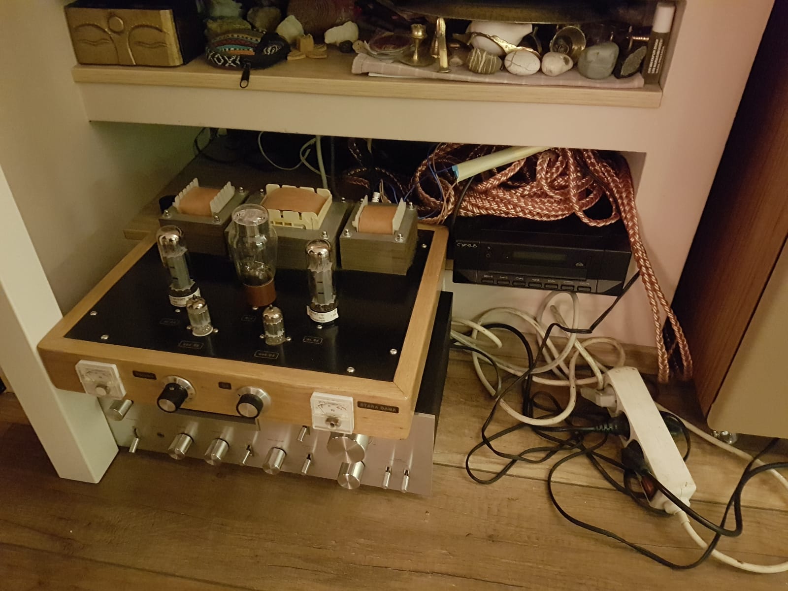

And in combinaton with EL34 SE amp,it sounds like heaven.
So clean,the hole spectrum is there,and is clean,pure,realistic,unbeliveble.
In final setup it will be KT88 SE amp.
I gonna make some better photos and video when we move,now we are still in small apartment,so no much space to put the sistem.
