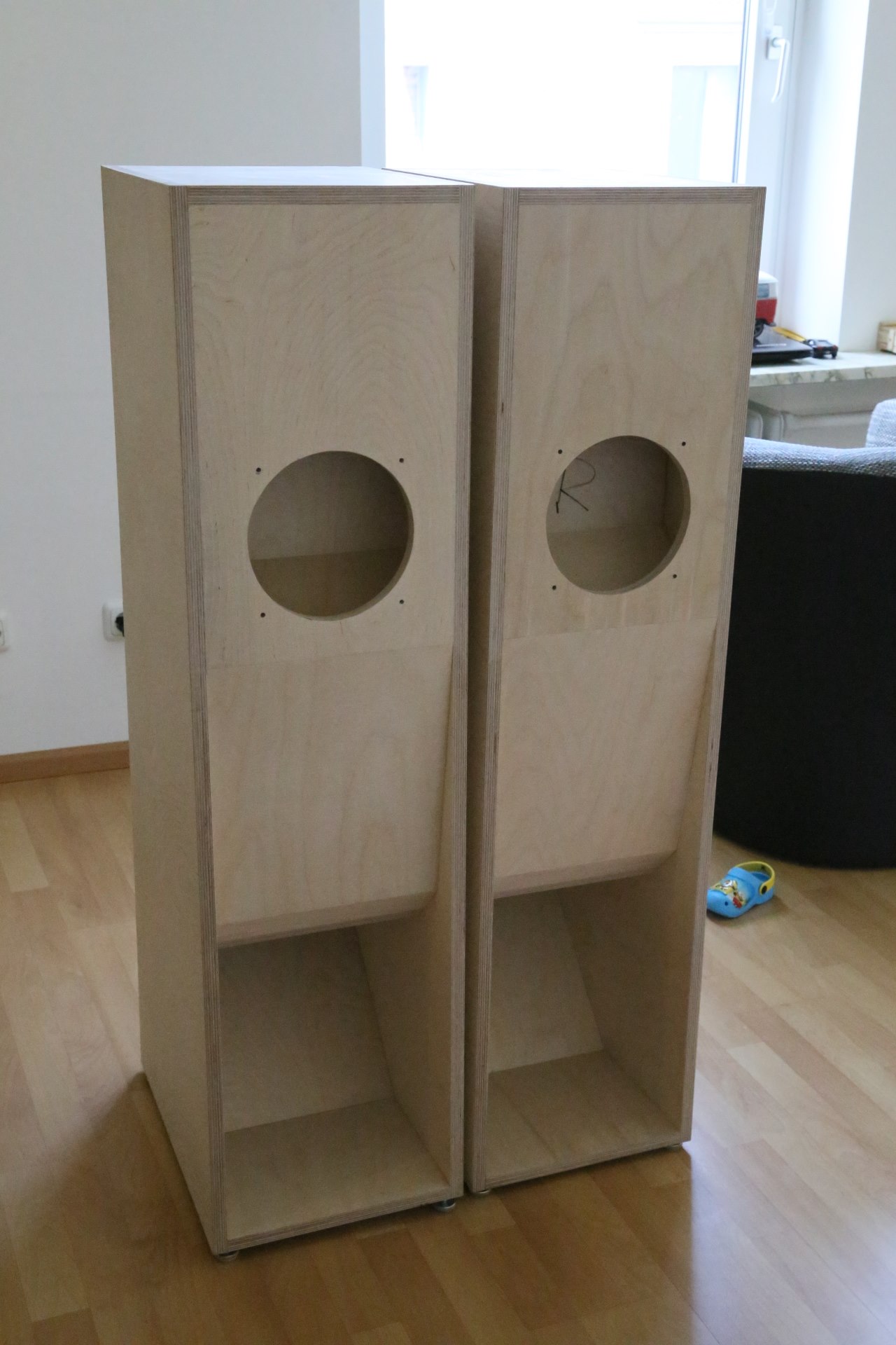

Did you modify the Dallas plans for the en version of 206's? They were designed for an earlier driver?
Nice clean looking builds by the way.
Cheers
No modification was done on the plans, I think the En and E are quite similar and compatible.
The speakers you mean? They were too complex for me to do them myself, and I had professional help. 18mm Marine Baltic Birch inside and outside.
They're a work of art!

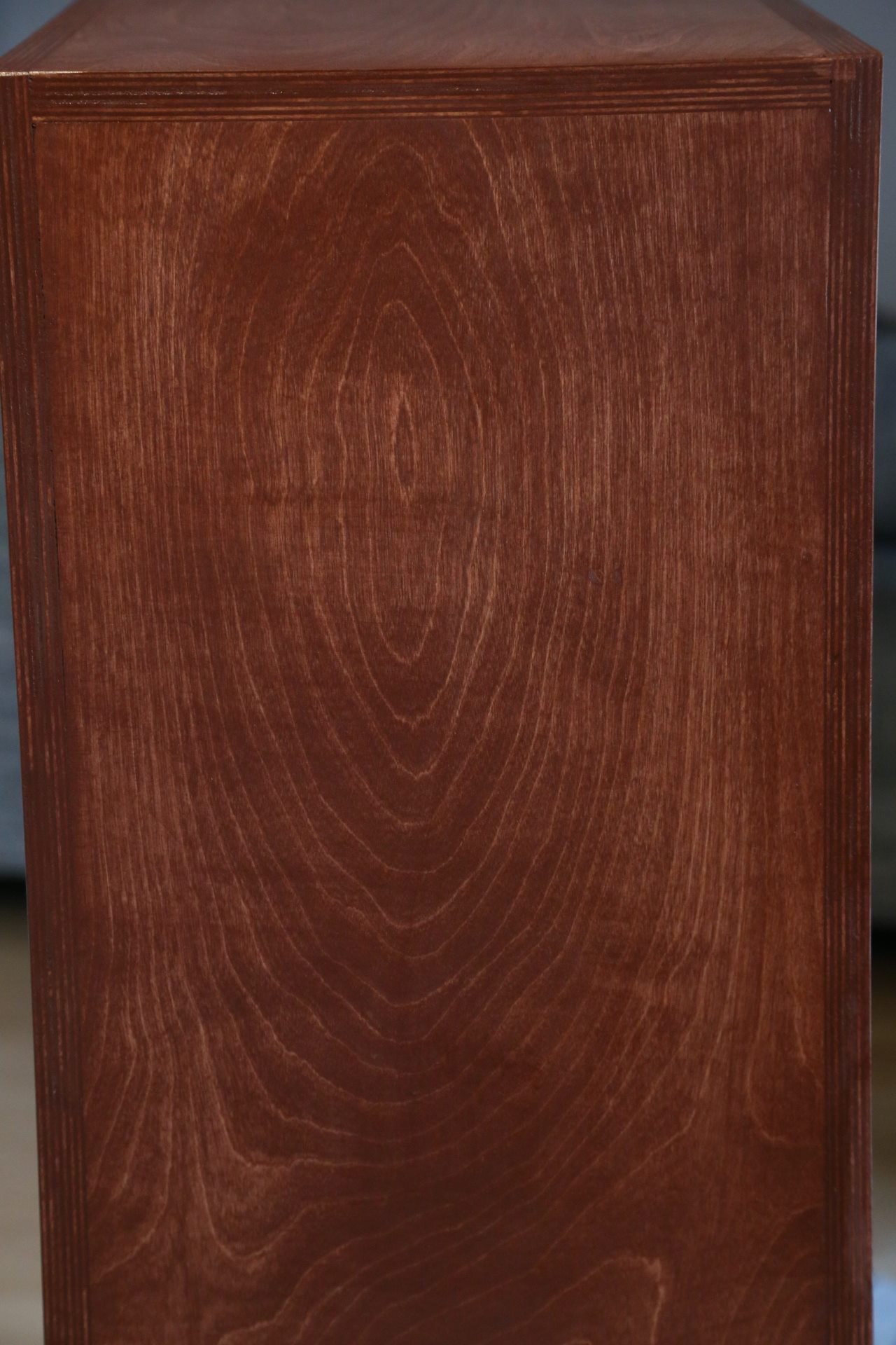

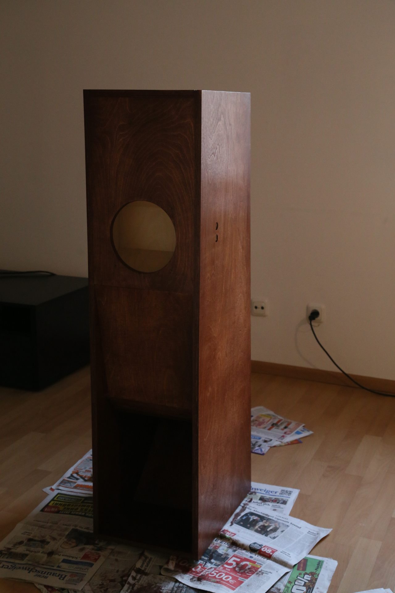

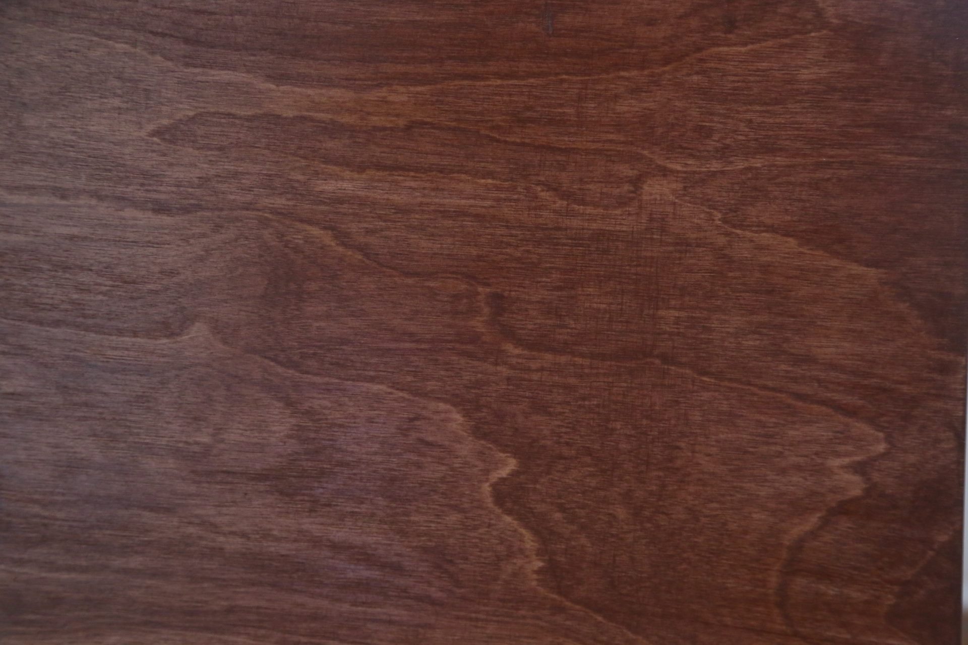

Finally got the time to stain them 🙂 . Pictures show the left one after the first and the second application. I used Osmo Oil Mahogany (recommendable, all natural, almost smell less staining oil). They ended up much better than I expected, with a very deep 3D sheen and nice patterning.

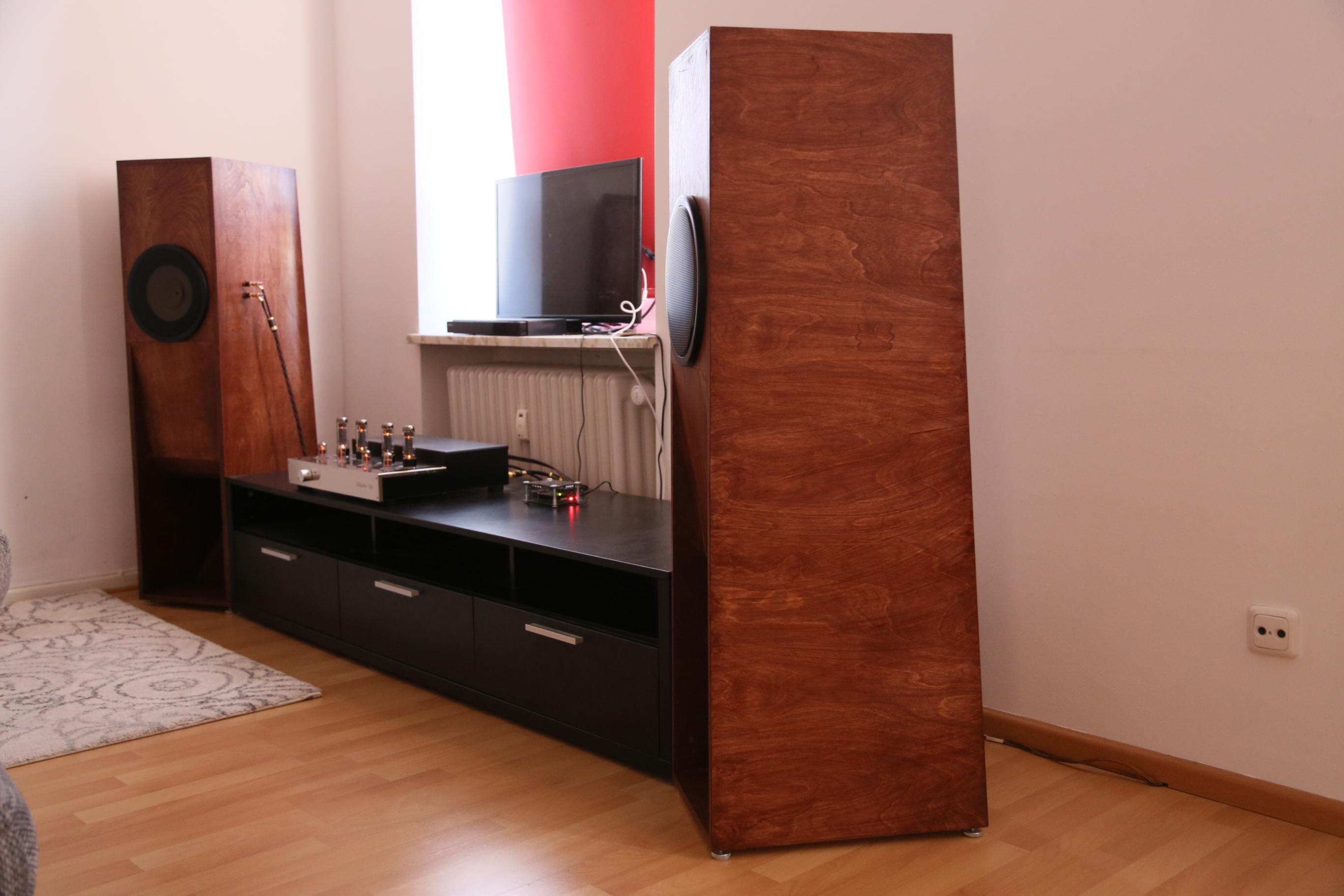

...and everything is installed back and playing. Their natural birch colour was nice, but this shade of mahogany is difficult to beat, they look professionally made now 🙂 .
PS: 🙂 In true audiophile fashion, I should now be bragging about how much of an improvement this oil stain has made on the quality of the output sound, and how much clearer everything is now.... That would be a lie, they sound EXACTLY as before.

You have a dark stain and the insides of the ports are painted black - are you sure that your sound is not darker/mellower than before? 😀
They're stained in the same colour, and only seem black because of the lacking light... nope, I cleaned my ears, warmed up the amp, treated the flac files with anti-static, done the voodoo, but still, can't hear one bit of difference. 😉 Damn, Ι need a 2000 USD power cable, for sure...
