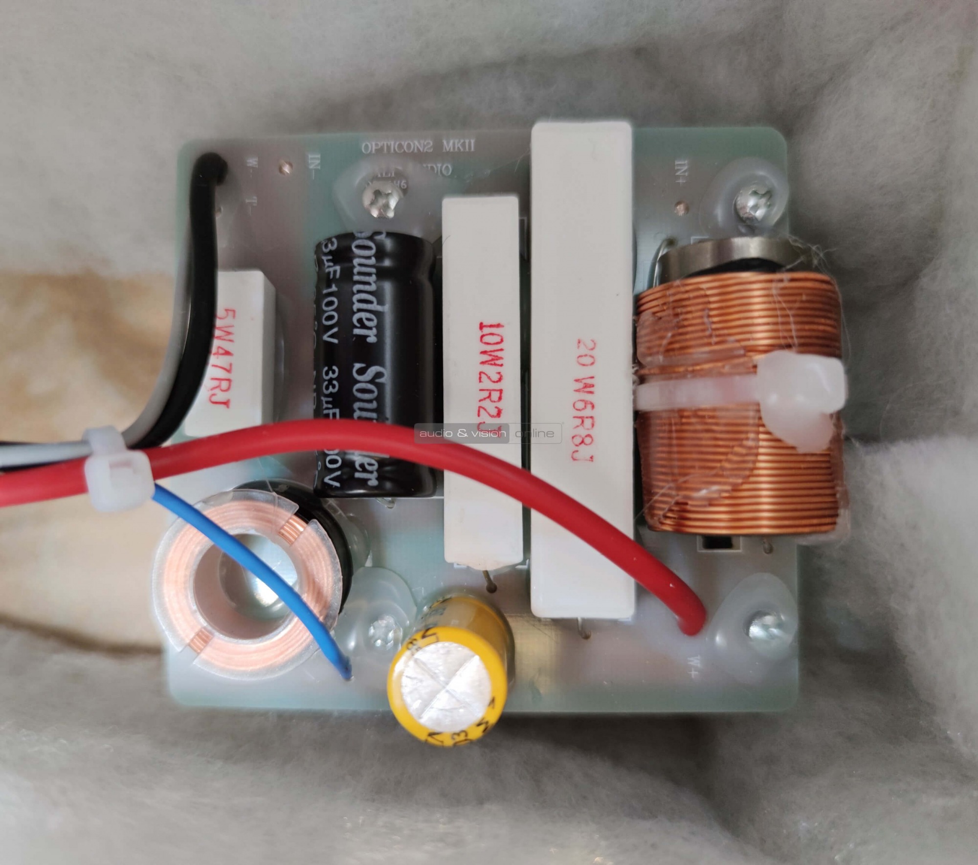

Attached is an image of the Opticon 2 MK2 crossover. I don't know much about it, but the biggest inductor I think is related to the woofer, and I also think it's of the ironcore type (and given the price range I can understand).
The small inductor instead, presumably of the tweeter, seems to me to be air core.
Now I kindly ask someone if they can confirm this.
If confirmed, I'd like to know exactly what to measure of the ironcore inductor in order to identify an alternative air core, which keeps the characteristics of the crossover unchanged.
In this sense, with the same inductance, is it possible to find an air core with the same resistance?

Welcome to the forum!
Yes, the bottom left inductor is an air core and will be associated with the tweeter.
As you indicate, you would have to measure the inductance and DC resistance of the iron core inductor in order to source a suitable air core replacement.
An air core replacement with the same parameters would be much more bulky as it would have to use many more turns of thicker copper wire.
The thicker copper wire is required to keep the resistance low.

If you think that Dali speakers are well developed, do not change anything in the x-over. Nothing you can improve with limited knowledge and no measuring equipment.
Usually the core inductors are dimensioned in a way they suit the load capacity maximum. So do not expect any improvement at normal listening levels.
If you listen very loud, the distortion from the chassis will be much more audible than the ones induced from the iron core.
Usualy a waste of money you should save and spend on better speakers.
If you really want to improve the sound, better replace the cheap capacitor in line with the tweeter. It may be audible if you install a 4$ film cap. The ones I see in the x-over are 8 Cent versions.
About this pulverized magnet soup, nothing to write home about. Just some marketing BS as usual.
That'll be the yellow one!
P.S. I agree with Turbo's analysis.

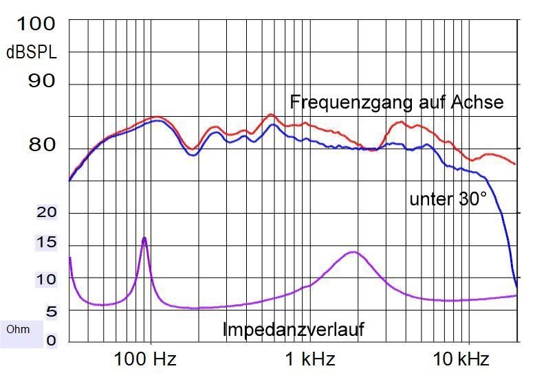

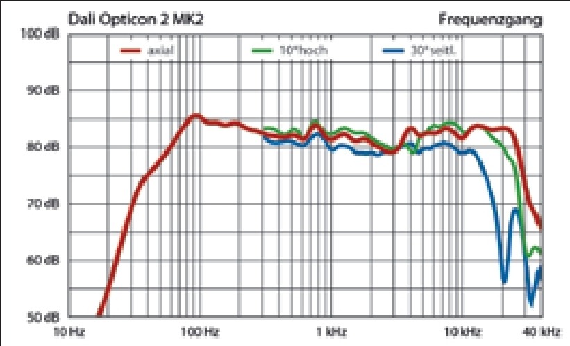

Curiously I found this one on audio.de
I believe that without the indication of the smoothing applied, nor of the setup/measurement environment, these graphs should be taken with a grain of salt.
However, directivity information is not given, so the frequency response alone says little about what it actually sounds like.

Now probably need to take it out and measure dcr and inductance.
Maybe the new inductor will change the bass system tuning by its increased volume 😉

Volume increase might be something to consider actually, I hadn't thought of that.

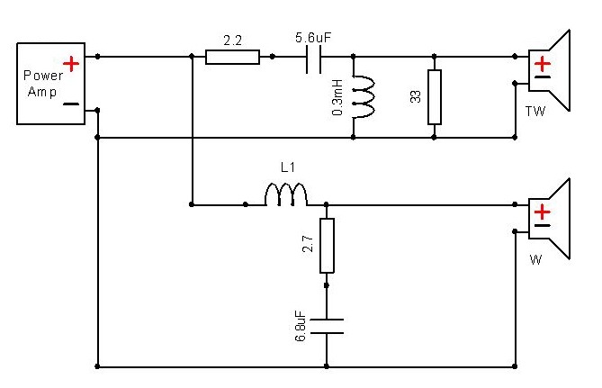

Another question. Are the 3 resistors of the crossover attached to the first post used to adjust the level?
There may be some response shaping going on as well as level setting.
The crossover is likely similar to the Dali Zensor 1 one attached.
By comparing the resistor values on the Zensor crossover schematic with those on your Opticon crossover board, you may deduce the likely resistor positions.
