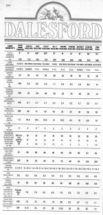

I know I've attached this list before somewhere, but here's the data on the Dalesford range, which was used by Chartwell in the PM200 and Fried amongst others. Hope you can read it. Crossover about 3kHz to a soft dome tweeter. You'd probably use a Zobel on the bass:
Impedance Equalization (L-Pad) Circuit Designer / Calculator
As you may know, 0.7 Qts is closed box type, Qts around 0.4 is reflex suitable.
