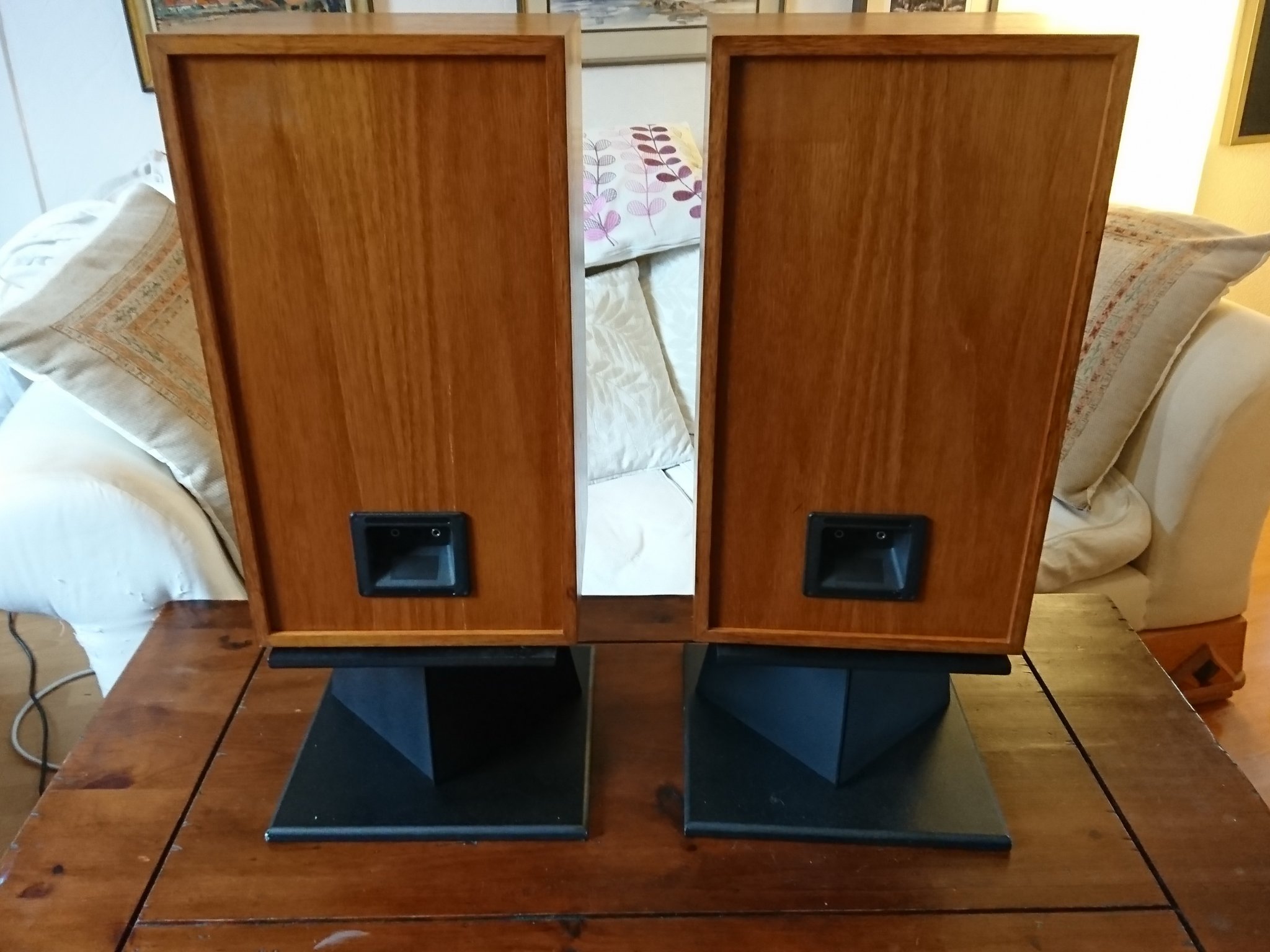

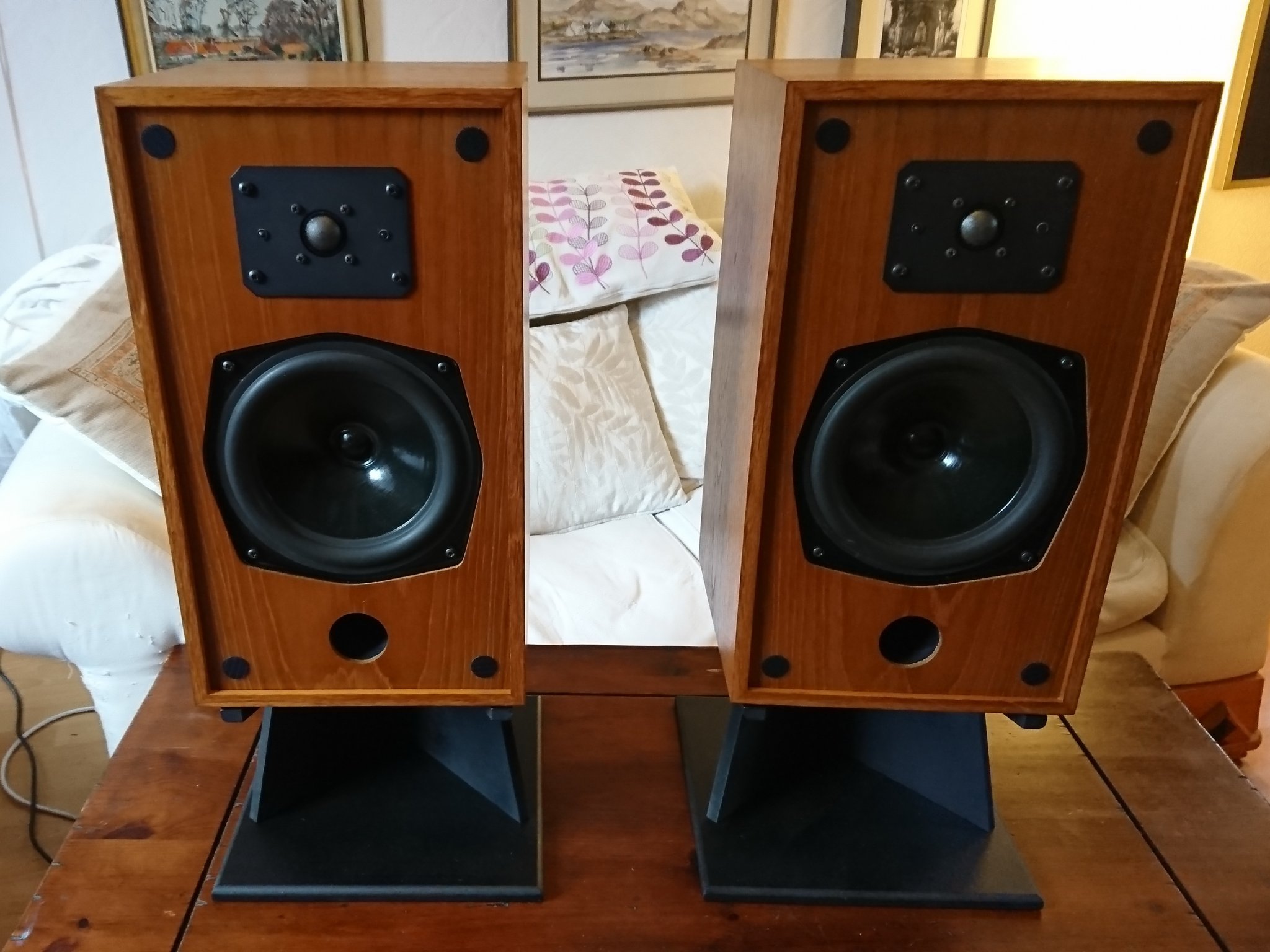

Hi Peter,
I came to this thread via a random Google as I was interested in in exactly this issue although I'm coming from a post-restoration perspective having replaced a pair of Dalesford D50/200s already and was wondering if I'd made the correct choice. I thought I'd post as even if you've moved the project forward it might be useful to someone in the same position in the future.
First off congratulations on the RAMs - an absolute steal and a great pair of speakers. I hope you managed to coax them back to life. I love vintage speakers from the golden era of small manufacturers (especially the three-way "BBC" lineage) and recently had a pair of Keesonic KRFs restored. These are wonderful monitors with a fantastic mid-range which used a pair of Dalesford D50/200s as woofers much like most vintage RAM models. In this design they're paired with a Peerless mid-range and silk-dome tweeter.

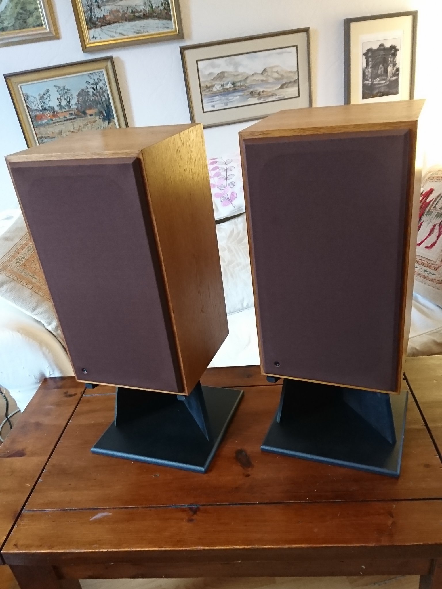

In the end I opted for the Monacor drivers - they sound fantastic and it's hard to imagine anything sounding any better they're so smoothly integrated. My reasoning was that although not an exact match they are close enough and as close as any of the KEF equivalents (which, by purely looking at the specs on paper, I agree the small magnet type would be closer fit to me, not to disrespect your previous advice which may come from experience) while also being very competitively priced and subject to modern quality assurance rather than gambling on a vintage pair.
Hope you made the restoration and found a happy match - if anyone else needs to find a replacement i'd recommend the Monacor units in a heartbeat but do check over the T/S parameters above as each speaker design will have different tolerances.
Finally - a couple pics of the restored KRFs which are sounding terrific and in daily service.
