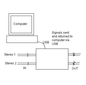

How would i go about daisy chaining two PCM2902's on a PCB, so as they only use one USB connection? is this possible?
I know u can daisy chain upto 127 USB devices, i'm thinking of more of a hard wired solution, if u get what i mean.
Basically i want to end up with 2 PCM2902's in a box, giving me 2 stereo in's and 2 stereo out's, but using only one USB connection.
cheers

I would like to build an external USB device, which will enable me to input 2 separate stereo analogue signals into my computer, manipulate them on my computer, with plugins etc. then output the manipulated signals again separately on 2 stereo analog outputs.
See attached picture.

You need to add a USB hub, something like this:
http://www.smsc.com/main/catalog/usb2502.html
Attach one PCM2902 to each downstream PHY.
