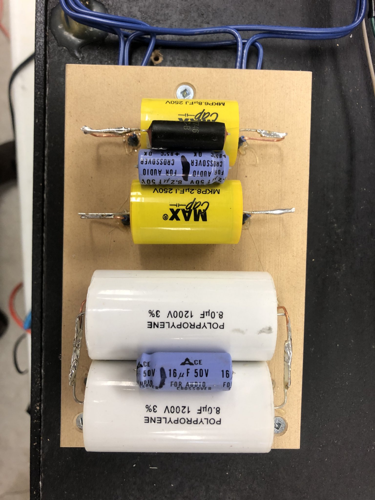

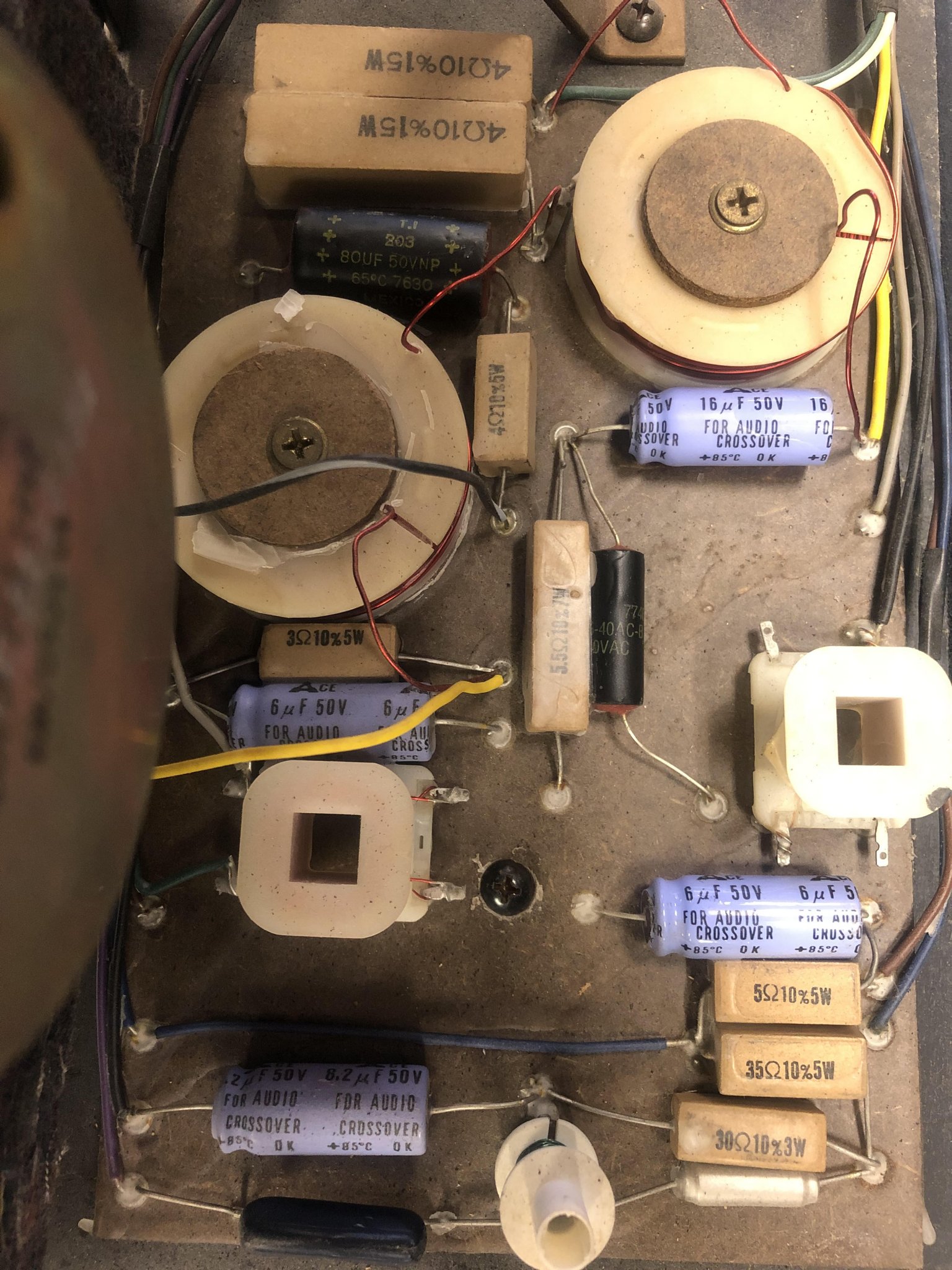

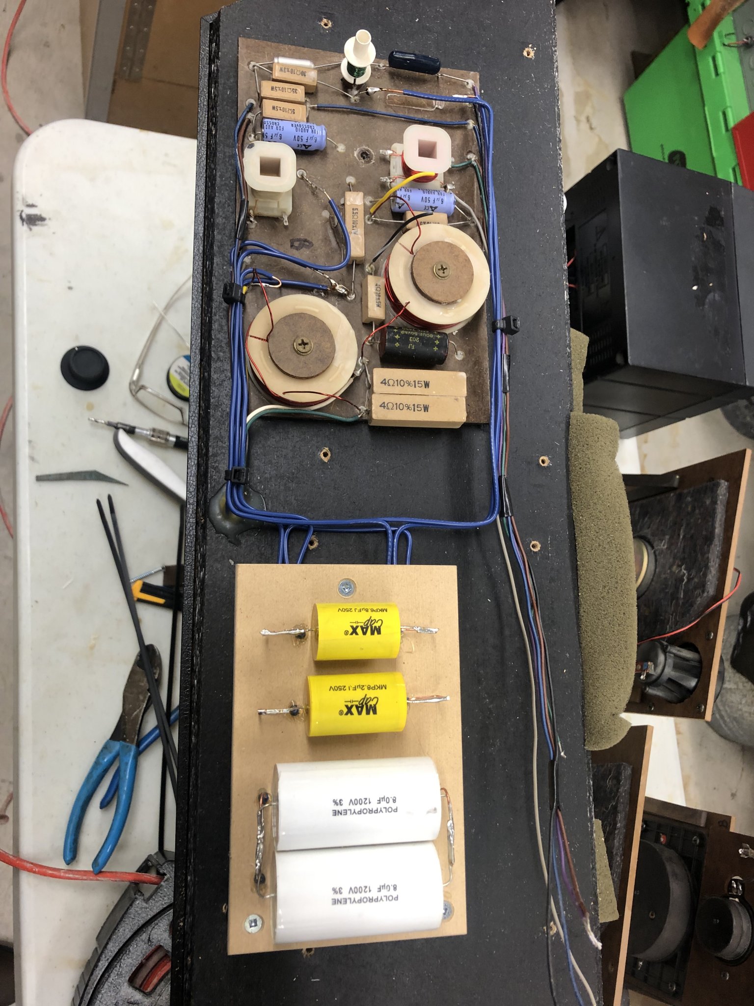

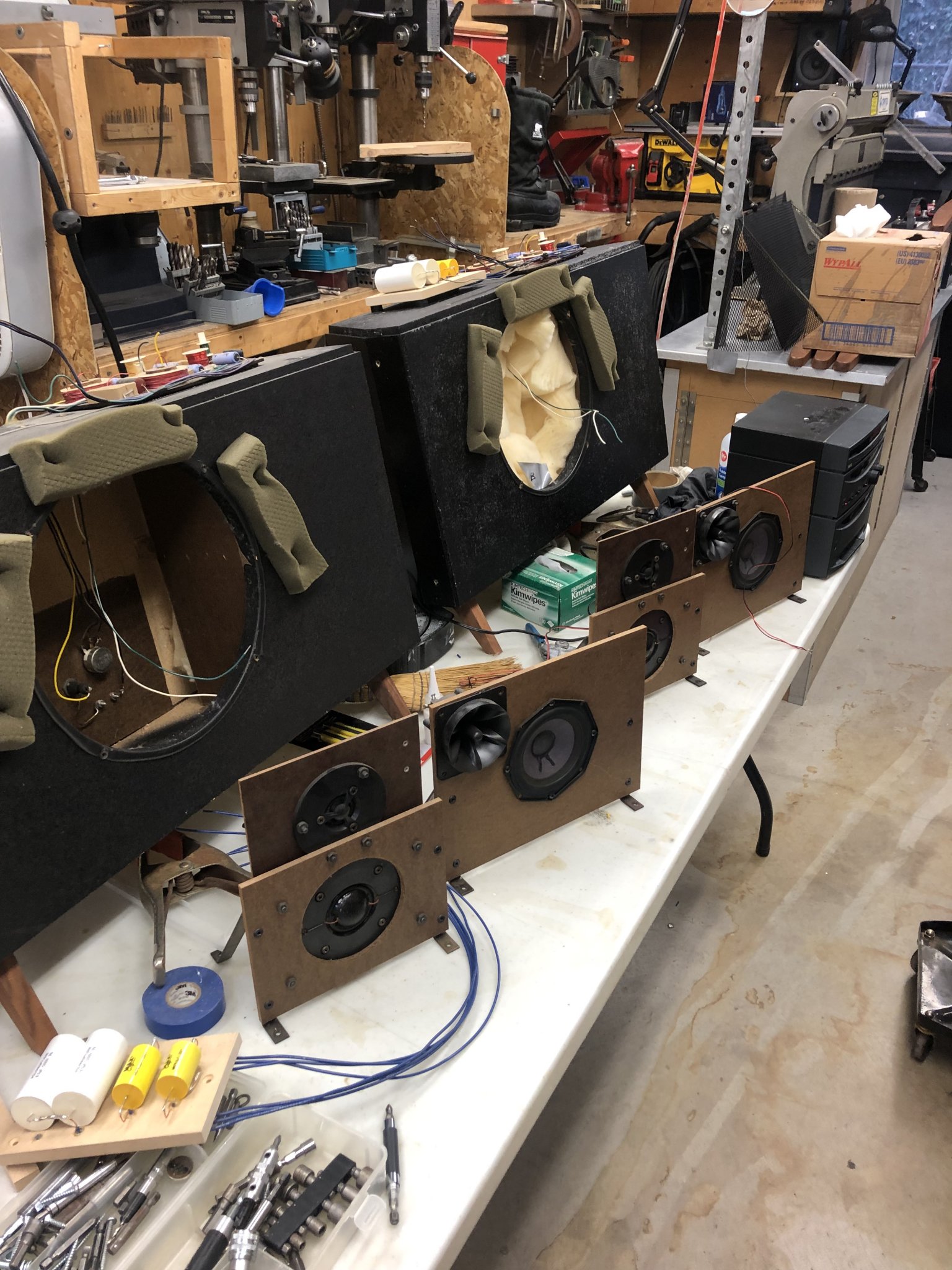

All right so despite the speaker repair guys best assurances you feel it is a good idea to replace the remaining caps 2 blue and one black with red ends, it's small potatoes for me I just hope I can find replacements that fit on the original boards. I bench tested all the drivers today and they all sound good so good to go there. Since you guys can't agree on the speaker cone treatment I am going to wait with respect to that mod as no-one else has weighed in either way. I would like to know what the mod is for the fuse holder if it is going to sound alright I wont bother. I would think ROXUL insulation would be far better for stuffing a woofer enclosure ( Roxul is naturally water- and fire-resistant and it is much denser than fibreglass ) I can get replacement Masonite from MICHAELS with the same density and dielectric properties as the old stuff. The rubber on the 5 inch driver is supple and free of defects it looks like new to be honest. Another member had mentioned getting excellent results from bracing the base cabinet however neglected to offer any pics or materials used or location of the bracing I am wondering if NO-RES would fit the bill and I can stick it everywhere a bare section of cabinet is the back of the base cabinet sounds like a toy drum it is so shitty.If I replaced a 16uF cap with two gigantic caps what the hell am I to replace an 80uF cap with? a four slice toaster ?what caps do you suggest and can I get away with lesser quality ones that replaced the 16uF cap Thanks for now I would like to finish these this weekend.
Yes. You're looking at electrolytic capacitors that are designed with a 10-15 year life expectancy now pushing near half a century in age. They don't hold up despite the bizarre belief that's very prevalent in vintage audio to not replace the caps until they go bad and break something else. (The old "if it ain't broke, don't fix it" fallacy that probably leads them to wondering why their car's engine burned up after 30,000 miles without an oil change.) They also weren't the greatest even when new, which is why Dahlquist introduced a crossover revamp at serial number 22,000 replacing everything but the 80µF with metallized polyester capacitors OEMed from Texas Instruments. It wasn't a cheap option (they had to increase the MSRP $50 in 1976 dollars to cover it), but it was worth it. They even sold a capacitor upgrade kit to DQ-10 owners so they could take advantage of it, though you're a little late to order it now. Anyways, yea, all the caps should be replaced excepting the 0.1µF and 0.15µF capacitors on the supertweeter, which were always metallized polyester caps and should either be good enough still or don't matter because the supertweeter doesn't do anything until 12.5kHz anyways. While new electrolytics would actually be smaller (hurrah for improvements in the material sciences), the metallized film capacitors you should go with will be larger. Fortunately, with the crossover board just sitting out in the air like that, you've all the room you need to make things fit even if you have to extend the leads a bit.
To which, I went ahead and took a few minutes to put together a shopping list of options for you if you so choose because it can be a bit overwhelming at first. I've opted for a couple of stores I know are reliable, Madisound and Parts Express, and given two options from each. For the former, I've put together a set of links for ClarityCap PXs (my preference just because I prefer their build quality) and Solens while for the second store I've put together their budget line of caps that are sufficient and another set for Solens. With each, there's an option to go film or electrolytic on the big cap to offer cost options. While the values aren't an exact match, the tolerances on these new caps are tighter, so they're actually more likely to be within the range they're supposed to be than those caps were new and especially where they're likely at now.

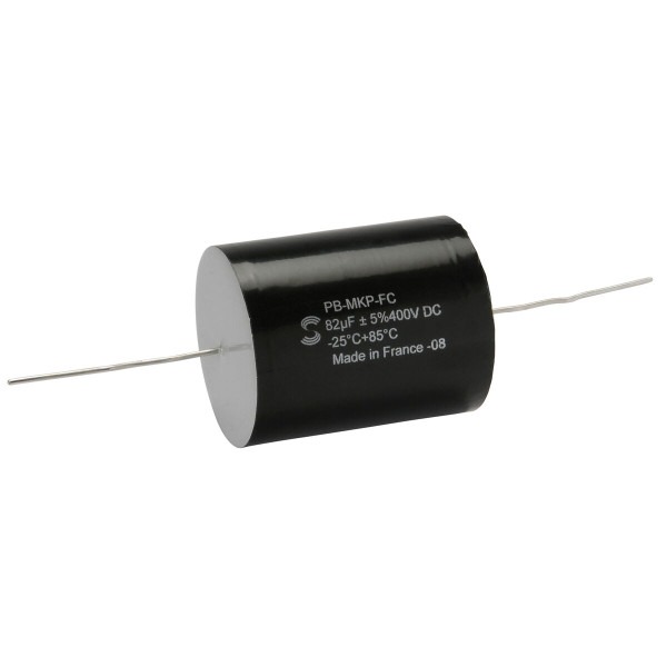

80µF
Film: https://www.parts-express.com/Audyn-Cap-Q4-82uF-400V-MKP-Foil-Capacitor-027-124

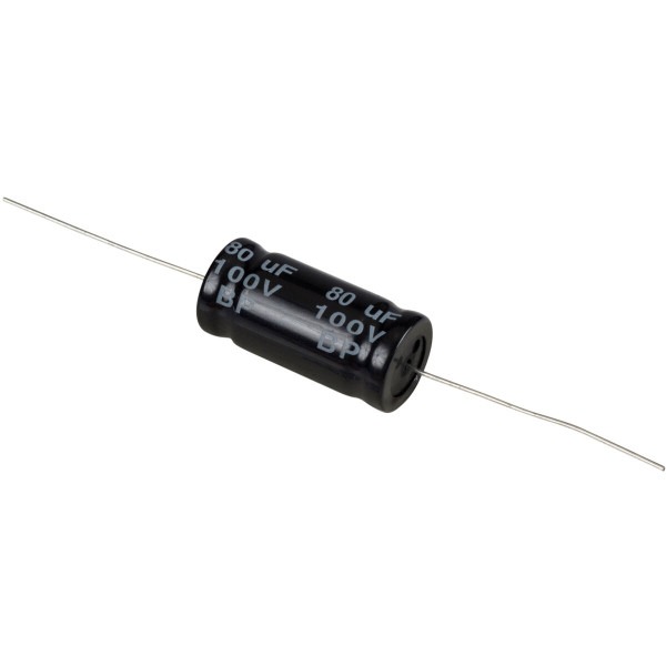

Electrolytic: https://www.parts-express.com/80uF-100V-Non-Polarized-Capacitor-027-358

80µF:
Film: https://www.parts-express.com/Solen-82uF-400V-Polypropylene-Capacitor-027-612
Of course, you don't need all of them at this point since you've already done half the recapping, so pick and choose what you need.

It's easy to quickly get into beer can sized capacitor territory or larger when working with high value film types, though an 80µF film type is more large pill bottle sized. You can opt for a more affordable and much smaller non-polarized electrolytic capacitor in that role. While not as good as a film type, it'll be a whole lot better than the ancient electrolytic that's in there. The top three issues new DQ-10 owners find with their speakers are 1. foam rot on the woofer, 2. blown fuses on the tweeters (or blown tweeters because the fuses were replaced with too large a value) and 3. bad 80µF caps.

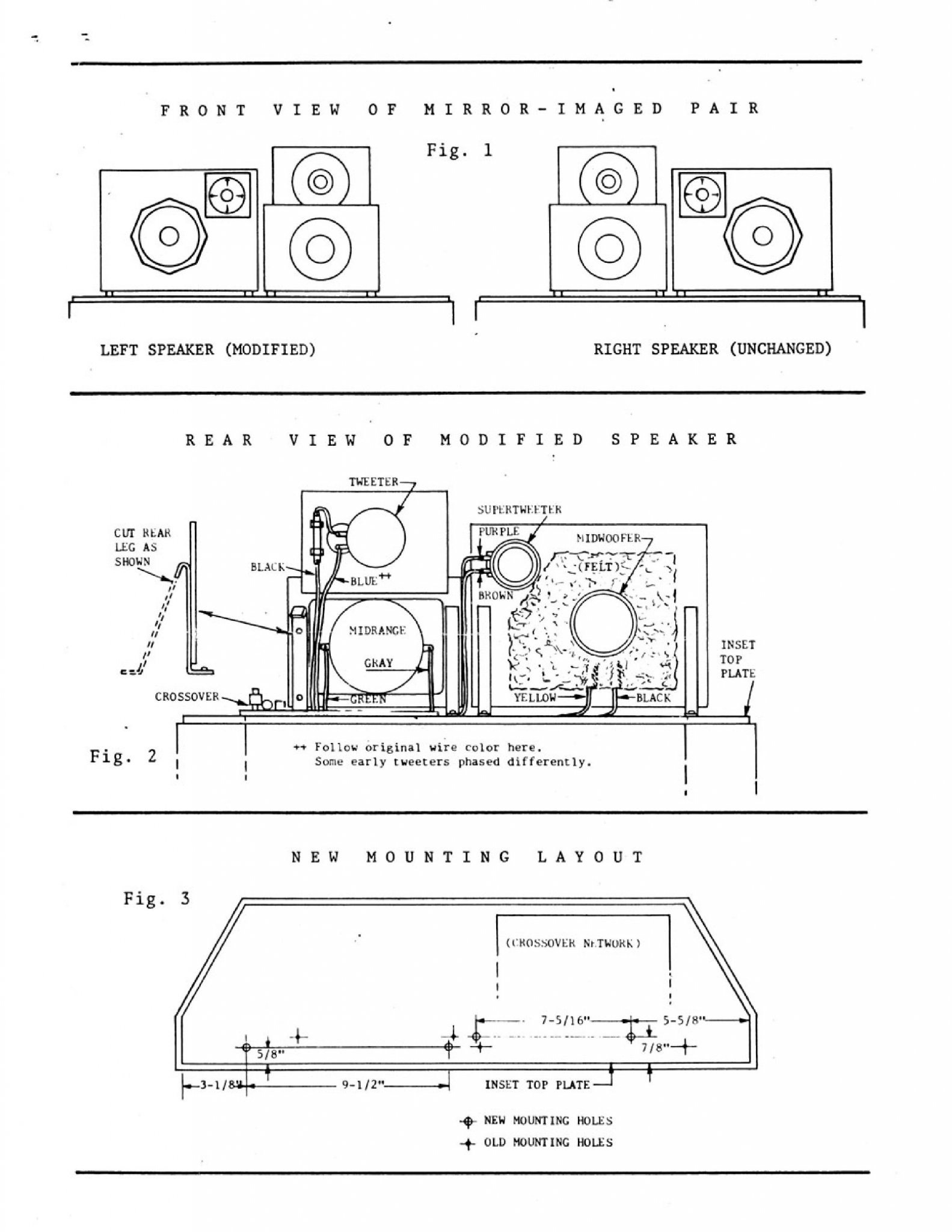

Dahlquist was at Harry Pearsons home (TAS Editor) a number of times in 1972-74, revising the DQ-10. He used the Marantz 500, Citation 11, and ARC D76 amps to design it on. ALso the ADC XLM, ARC SP3. The staff of TAS also got involved in feedback - even after the initial release, past when the change from the CTS woofer was made.
HP intimates in the watershed review in Spring 1974 that Dahlquist was trying to mimic the Quad ESL - the shape and the metal cage certainly were visual cues. The imaging and precise sound were also a paean to the Quad.
My father had a pair of Quads for 7 years, and I had the DQ-10 for 4 years. Listening to the Quad ESL 57 its clear that its more precise and pure then the DQ-10 with less lower bass, and top treble, and less ability to play loud. Take a look at the CSD plots and IM distortion of the Quad - not sure that any speaker made today is better than a 66 year old design in those ways. But the Quad is very short on dynamics - which the DQ-10 bettered, but not by that much.
Agreed on the woofer - do not vent the cabinet - if you must, you must model it carefully as a random hole and tube is going to get goodness knows what results.
I too had DQ10s, and quickly mirror imaged them. The scuttlebutt I heard at that time (I can't remember who to attribute it to) was that Jon and Saul were doing the NY area shows to demo the DQ10 and were using Luxman MB3045 (high power triode) amps. I bought a pair of the Luxmans and the match was indeed heavenly; they made my Marantz 8b's sound sick by comparison - but they ATE output tubes very quickly. Oh yeah, I also found the DQ10 bass underwhelming and added the Dalhquist active/passive crossover (that I still have) with a pair of Janis subwoofers and that fixed the bottom end nicely.

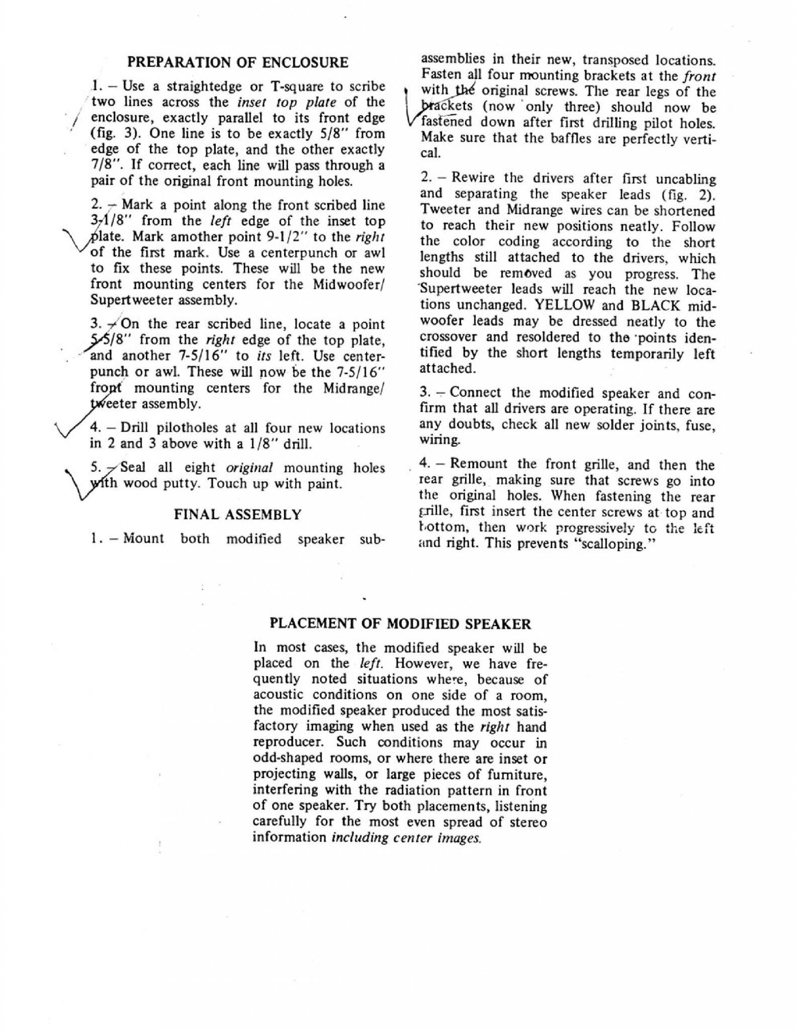

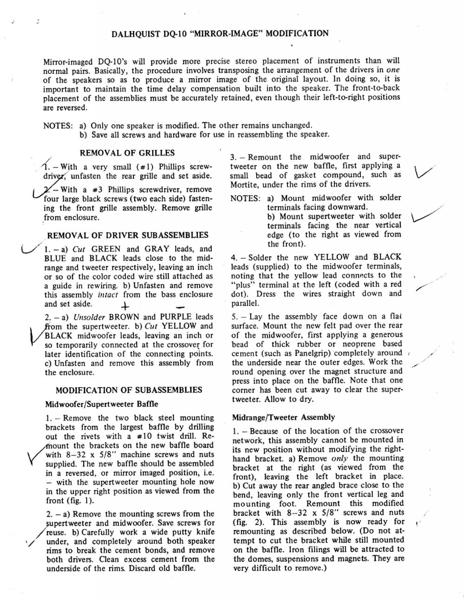

Before I forget to share these...again...these are Dahlquist's mirror-imaging instructions if you don't already have them. They work off the assumption that you'd have the kit with the new baffle board and wire extensions, but you can make do with what you have or make a new one if you've a router and circle jig to make the driver cut out. The handy part is the set of dimensions for where to modify the bass cabinet. The supertweeter's position isn't particularly important, but the felt for the midbass/lower midrange is. So, prioritize accordingly to keep it intact as best you can. If it gets torn up too much, the driver won't see enough acoustic resistance to behave properly.

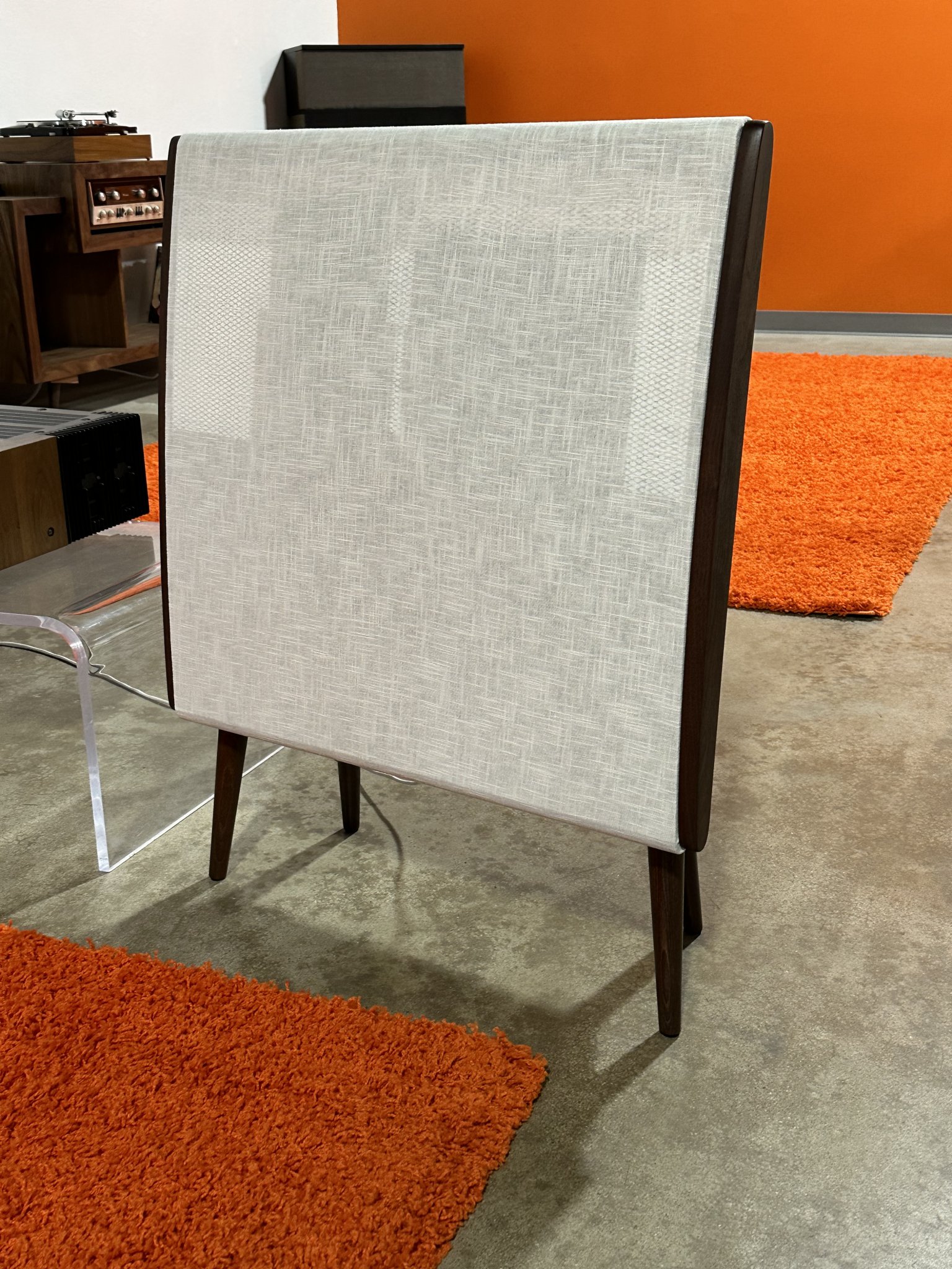

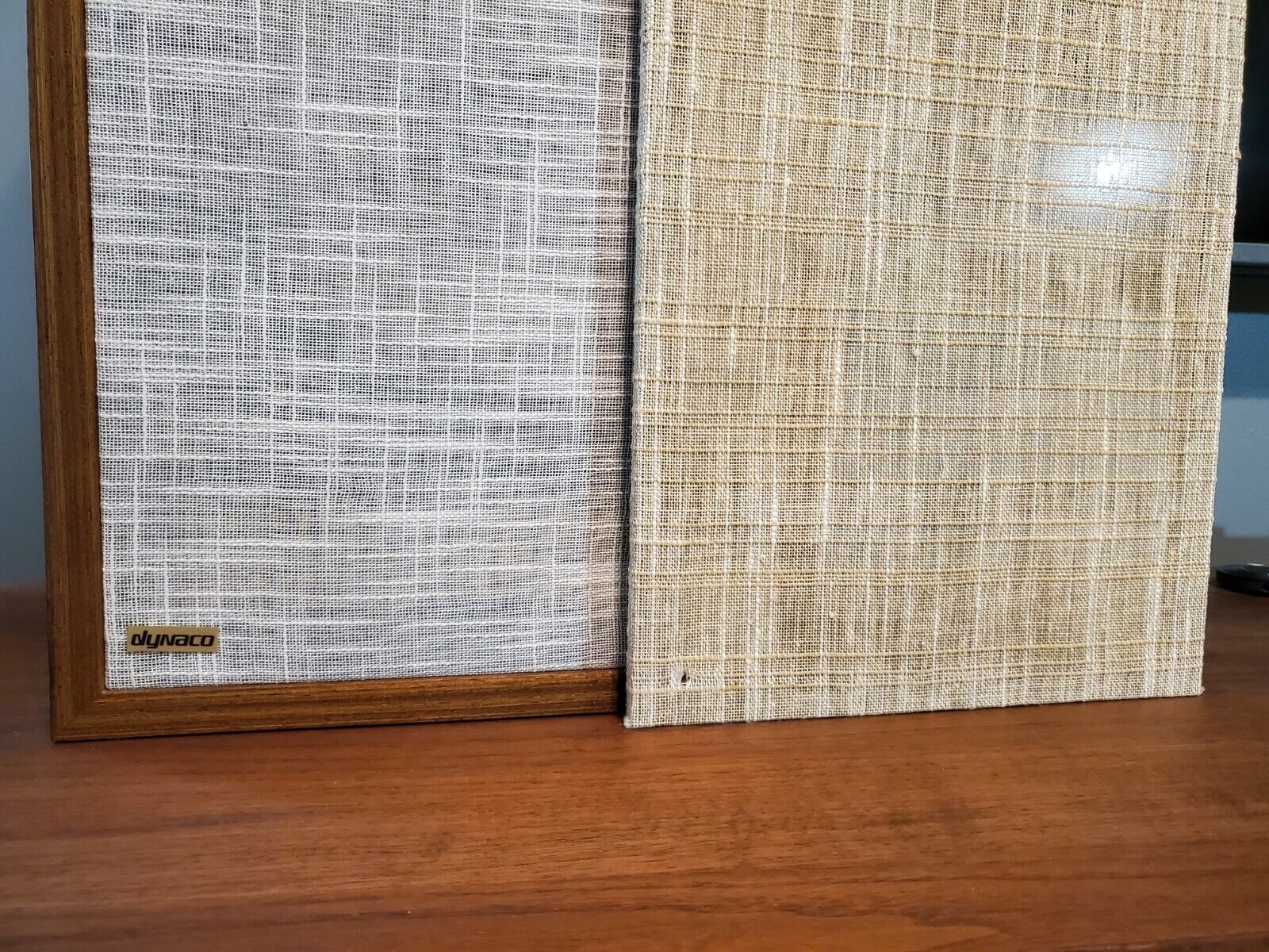

Also, here’s a photo of a great looking DQ-10 restoration that I saw recently. Beautiful!
This is when the aesthetics of a speaker becomes equal to or exceeds it's intended sonic function. I would pay a big chunk of change to have these pumping out music in my home as opposed to the millions of coffins out there. I am going to look for those old coffee table peg legs and already decided to go with a double cappuccino stain on all the woodwork along with several coats of varnish , you wouldn't happen to know where I could source that exact fabric would you it looks great with the woodwork really nice job, thanks for posting.
Go for it! Those speakers look way better for real than the photo.
No idea what the fabric is… but if you took your phone to a good fabric store and showed then the photo I’m sure somebody would know what that style fabric is called.
Oh wow this is a jackpot of information thank you for taking so much time to put this message together I am definitely ordering the remaining caps today, I will repack the woofer enclosure with the original materials, I have some kiln dried hickory in my shop I will use for bracing the back of the base enclosure, it is the worst so I will glue some strips in there, and I happened upon a piece of Masonite for the mirror imaging work and will be sure to keep the felt intact, I have been a master cutler for 20 years so I am very handy with pretty much any type of refurbishing I am confident the old speakers will look and sound great, thanks for your time.
No problem, glad to help. Sounds like you'll have them sounding great in no time.
Regarding that restored pair, the fabric looks to be the "open weave natural linen" type. It's sold for curtains and interior decor and a well-stocked fabric store or one of those bed and bath places that's a scented candle filled horror should have something similar. It's also more recently is being sold for vintage speaker repairs, specifically for Dynacos and KLHs that used a similar cloth originally. While not so budget friendly, that latter route is an option such as this: https://www.ebay.com/itm/304581201050

80uF 100V Electrolytic Non-Polarized Crossover Capacitor $2.43 each,,,,,,
Solen 82uF 400V Polypropylene Capacitor $50.00 each,,,,
Audyn Cap Q4 82uF 400V MKP Metalized Polypropylene Foil Crossover Capacitor $30.00 each
Considering the price differences here I have to ask, am I going to hear the difference between $3 cap and a $50 cap, the gentleman at the speaker shop I bought my caps at suggested these caps that are remaining ( see pic ) were sonically the least critical, now if he was mistaken would I hear a difference between the $3 cap and the $30 dollar cap? I attached a pic showing the original Xover and the unnamed.jpgmodifications that were made .
I found the legs online prefabbed and stained along with the mounting hardware the legs in the pic you attached according to my calculations are 8" so that's what I am ordering as for the fabric DIOGENES attached a link for a very similar product https://www.ebay.com/itm/304581201050 however the link wont let me select between the two fabrics shown and as well don't indicate the number of products you get with your purchase nor the dimensions of the fabric you are buying so can't pull the trigger yet.
BTW the link wont let me select between the two fabrics shown and as well don't indicate the number of products you get with your purchase nor the dimensions of the fabric you are buying so can't pull the trigger yet, now it could just be me as I am not savvy with online shopping however I can't seem to get those details sorted. Thanks again for the link I am going to snoop around and see if I can't get on the phone with someone and get the material ordered.
