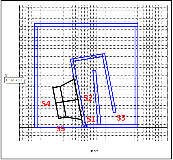

There are two diagrams, which I've attempted to recreate in SketchUp.
The biggest problem I'm having is the placement of the one individual panel that sticks out above the panel the driver is mounted to. The numbers imply it is nearly flat, horizontally, but apparently the angle is greater.

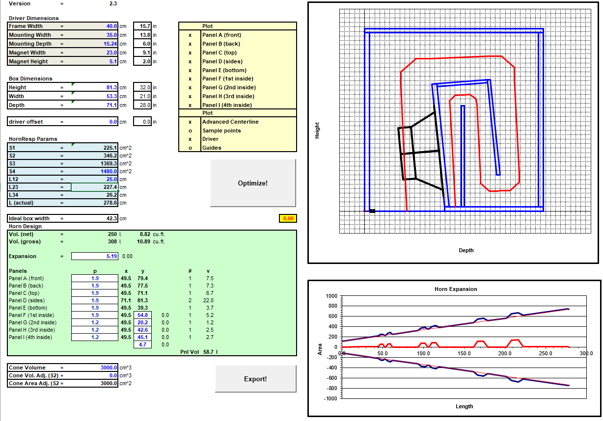

It looks like an MTH30 type of fold, which would require that horizontal panel be orthogonal to the panel that it's attached to. Based on the layout though ,it looks like the panel has to be angled about 1/3rd of the angle of the baffle panel for the driver, and this should be the same angle used for all of the other internal panels, which means that the bend at the top should have the panels joined at a right angle, not like how it's displayed in the section picture. That's just a guess though.
This is is something that I'd normally leave up to one of my workbook to work out 🙂.
When I have enough time, I'll check to see if my MTH workbook can be altered to support a dual expansion TH like that one.
Turns out my guess was wrong. The only way this appears to work with a smooth expansion is if the panel next to the driver is at an angle that's 1/2 that of the driver's baffle panel. Also, the three internal panels that are connected together (starting with the baffle) should be at right angles to each other. Only then can it be sim'd via Hornresp (see attachment). No, it's not optimized - I haven't finished that part of the workbook yet 🙂
This "dual fold" MTH30 layout does result however in a larger mouth and shorter path than the standard MTH30 layout though. The end result should be a narrower passband and higher cutoff frequency. Anyway, I'll finish up the workbook to see what it comes up with for the external dimensions of that 40 Hz TH design at the link you provided.
Well nope, that doesn't work either. Trying to get a dual-expansion working with that type of fold ends up with negative expansion, which is probably something to be avoided. Seems the only way this fold "works" is with a single expansion. In that case, you can use my MTH30 workbook to work out the internal panel dimensions and positions.

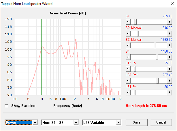

I did an MTH30 type sim'd fold for a TH using the LAB15, using the external dimensions of DAG's sub, and adjusted the mouth size until I got an Fb of 40 Hz. The resulting mouth is a bit smaller (another possible sign that the sim done for DAG's TH might be off - larger mouths = higher cutoff frequencies).
Anyway, here's the results. This doesn't strike me as a driver I'd use in a TH. Too much "ringing" around the ends of the passband. And this is with the "standard" model. Switch on the "Lossy Le" model and the response looks a lot worse. This is a driver that I'd try to use in a FLH or offset TL instead (depending on what I was aiming to accomplish).

FWIW, the sim I did is bog simple, so should be easy to fold with Brian's software and goes a little lower, smaller with all that implies, yet only a ~3 dB less output [120+ dB transient peaks/m/2.pi/~35 -115 Hz in lossy Le mode], so either can do 100 dB from the low 20s to mid 120s with 80-100 W and just a few watts from 40 Hz.
