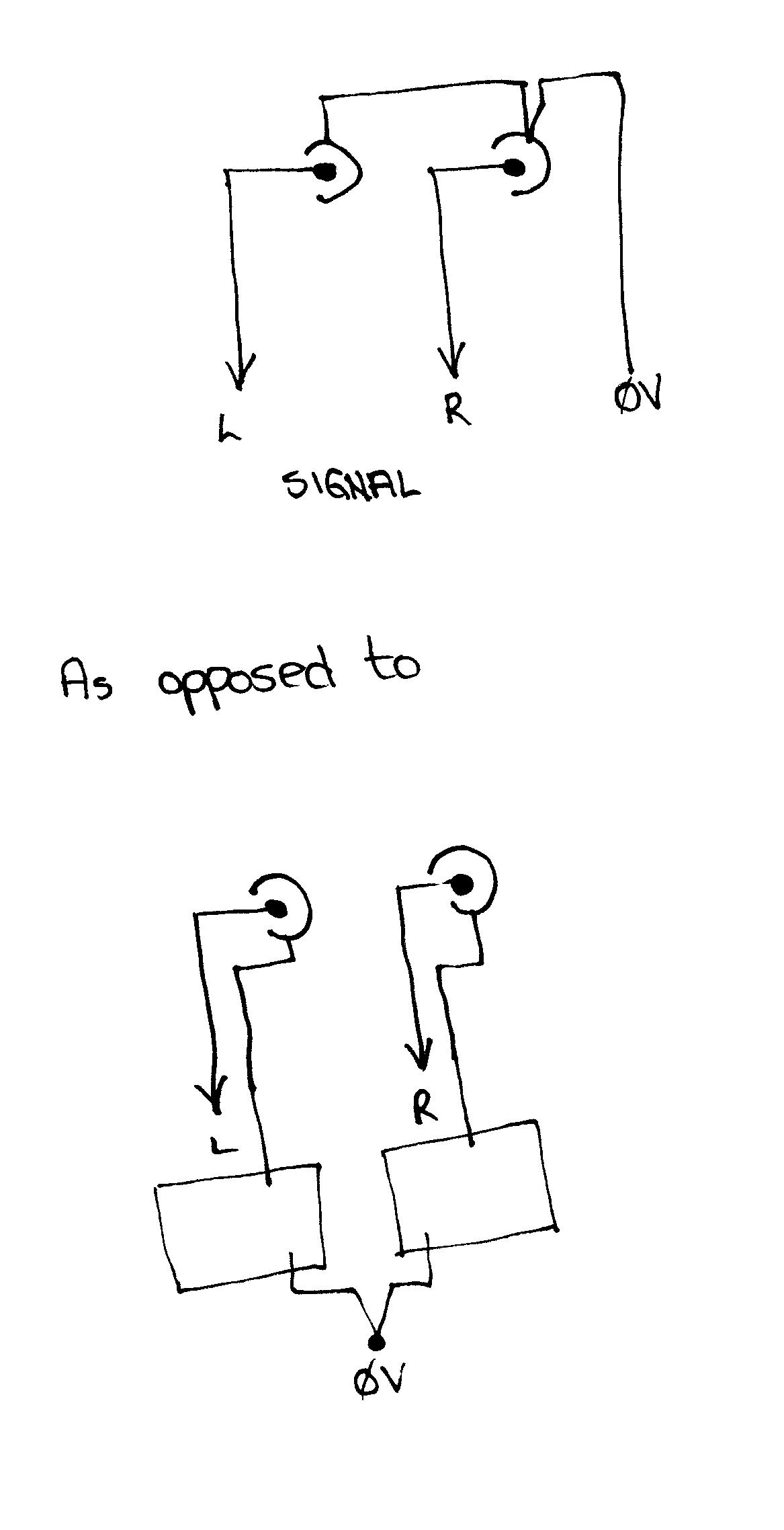

I would try disconnecting the ground on one input cable. Do not disconnect
the circuit's ground, or you will have trouble.

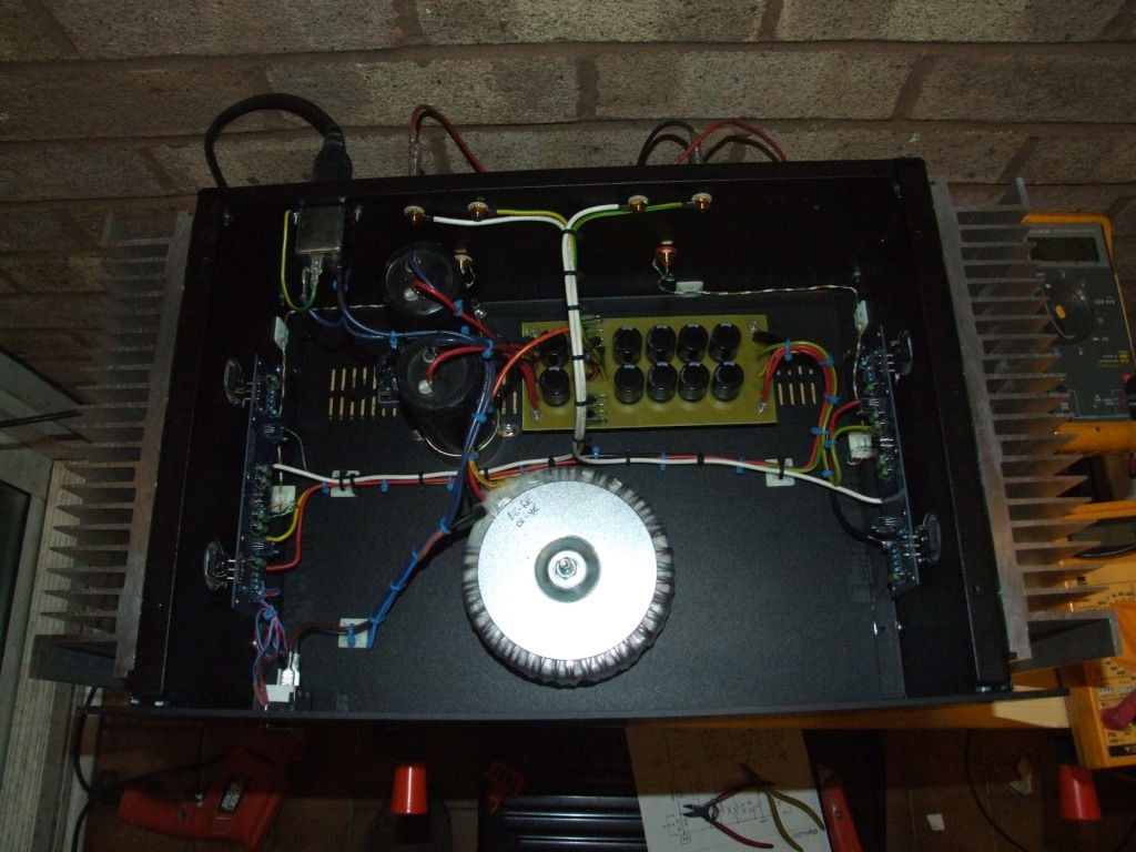

This might be a longshot, and if all else fails... from your photo I can only see one bridge rectifier. Is there just one rectifier or are there two, one for each rail? If there is one, might try hooking it up with two like the power supply in the Aleph J build thread (same power supply as yours, basically). Sometimes a hum comes from just the one bridge for both rails. If you do have two, then please ignore this post. I hope breaking the ground on one of the input grounds solves it for you because that is the easiest.
the single signal return wire (that you are calling ground) must be close coupled with the signal flow wire.
If you create a high loop area you will pick up interference.
The two signal wires and the their associated return/s MUST be close coupled.

Each signal wire is a twisted pair with its 0V connection.
Studying the diagram there is clearly a loop in the centre.
I can see that disconnecting 0V from one of the RCA sockets would break this loop - How though would that channel work in isolation if the other channel was disconnected ?
Certainly during testing you might have only one input connected.
You would effectively break the ground wire of one of the input cables.
The other cable will provide the ground for both.

Imo, assuming I am understanding, a not so great idea.
Removing the ground from one of the interconnects leaves it floating, in which case it is an invitation for vicious hum and noise, capable of trashing speakers and amplifiers - unless the grounded interconnect is connected first.
The problem would be worst case if the amp was on and not off.
I'd opt for the resistor to "ground" rather than the disconnected version, especially if this is sufficient.

It doesn't look like that's the case. They appear to be in parallel with
filtered supply lines.

I've fitted a dual pot.
The input ground is only connected to one channel, as is the output ground.
It still hums very quietly.

Also, unbolt the power transformer, rotate it 90 deg in the horizontal axis (turn it on its side). See if that does anything.
Look at the residual on a scope, see what it looks like and what freq it is. (clues)

how about the AC mains tied to the wires from first two supply filter caps ?
btw, was it this amp that blew, and was repaired ?
