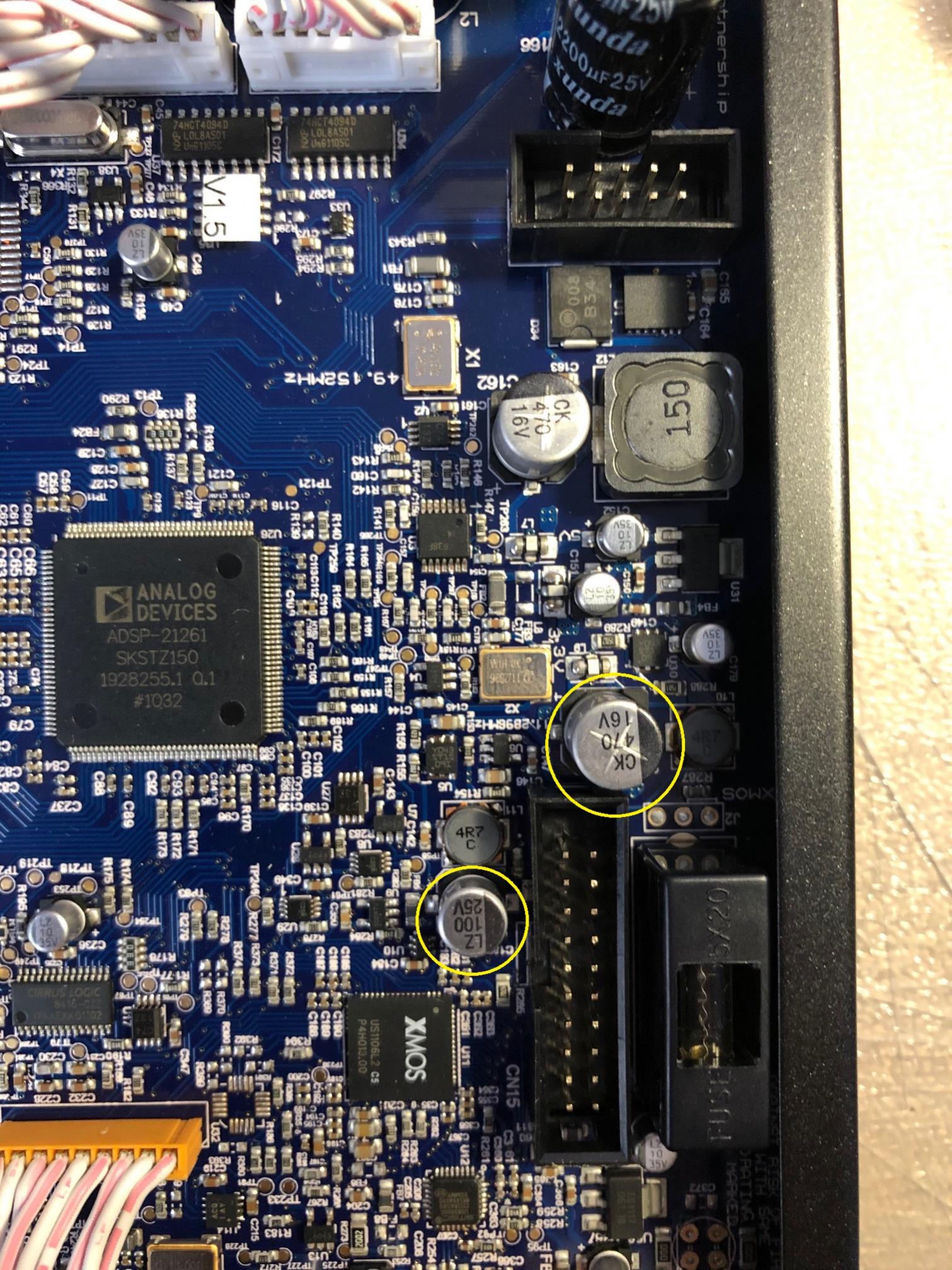

I had the same problem, I fixed it by replacing the capacitor C148 which is a SMD 16V 470uf, it is near the fuse. When I measured the voltage, it was only a little over 1V. I replaced it with a 6.3V 630uf since that is what I have.
I have the same issue but it only happens once in few weeks and only after I shut it off.
What is the voltage across this capacitor (C148) after the change?
I measured 1.2V and the same for the 100uf 25V C180 capcitor.
With - surprise! - a capacitor ESR meter. ;) Mind you, buying one of those would get you a whole bunch of caps, so unless you do this sort of stuff on a regular basis getting one may not be worth it.
You can try connecting a known-good similar cap in parallel for testing purposes, although that's generally easier to do with through-hole caps and may be a bit fiddly here, not to mention lead inductance. It's worth a shot.
1.2 V sounds like digital supply, maybe for the DSP and/or the XMOS chip nearby. High ESR on that would be likely to make the whole thing hiccup.

While I trying to desolder c148 I messed it up and broke the pad. Now I want to solder a cap by wire. So I need to know where does c148 connect. I try to check Dacmagic service manual and it doesnt belong to dacmagic+.
C148 of dacmagic+ is 470u 16V. Dacmagic has 6 capacitor valued as 470u 16v and all of them belongs to digital inputs. So I couldn't find a cap that I can relate to. How should I proceed?

Update: I scraped small piece from the back and soldered a jumper wire. Then I checked if the three dots on top of the board connected to the place I scraped and dmm beeped so it is connected. I checked negative side of 100u 25v cap and other 470u cap they all seem connected so I assume all three caps negative side connected to the ground.
So I replaced the c148 with new capacitor and powered it up. Failure. Dacmagic now doesnt show any input. Normally input selection leds cycles up 1-2 time at startup. Now it doesnt stop cycling. I don't know what does that mean. I checked voltage levels on caps. c148 show around 1.2V. Other 470uF cap shows around 5V. 100u cap shows 6mV. Something seems wrong with the 100u cap. I changed it as well with new one but nothing changed. If I remove caps and power device up same thing happens, led cycles forever.
