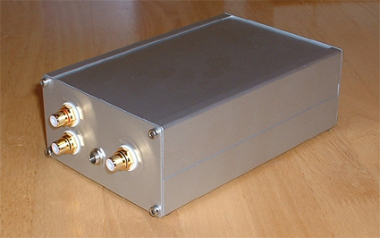

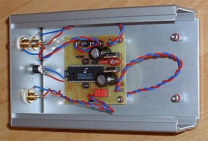

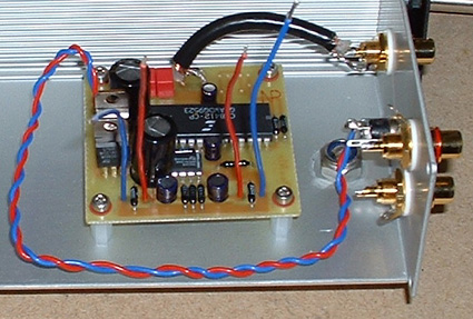

Success!!!
Scott, JP, Bequerel,
well, all advice taken and acted upon.
Success!!!:D
It was a dodgy joint on the 1.37K VRef resistor. I was measuring across the components to check the values, then from the next point along the circuit to check the joints. The 2.49K parts were testing fine with the negative probe on the ground track. The 1.37 wouldn't register. A quick bit of work with the Soldamop (and it was horrible stuff I mopped up!! :eek: ) and then a resolder with the Draper 60/40 (I started off trying to use the silver loaded stuff - I will use it on the gold connectors and silver wire in future, but not on the main board - What a PITA!!:angel: ).
Multimeter read spot on!!:) Plugged the bare board in and, hurrah!, it works!:D
Interestingly, the output is so powerful that the Arcam only needs to be cracked-open to get a decent sound. There was a bit of background hiss, but selecting "direct" to bypass the tone controls sorted most of this out.
Well, as you can guess, I am really pleased with the result.
A big thank you for all the advice and support. Especially to Scott who was generous with his advice even before I had started the project.
Well, eveyone is going to get a big surprise tomorrow!!:D
Thanks again!!
Jon:cool:
