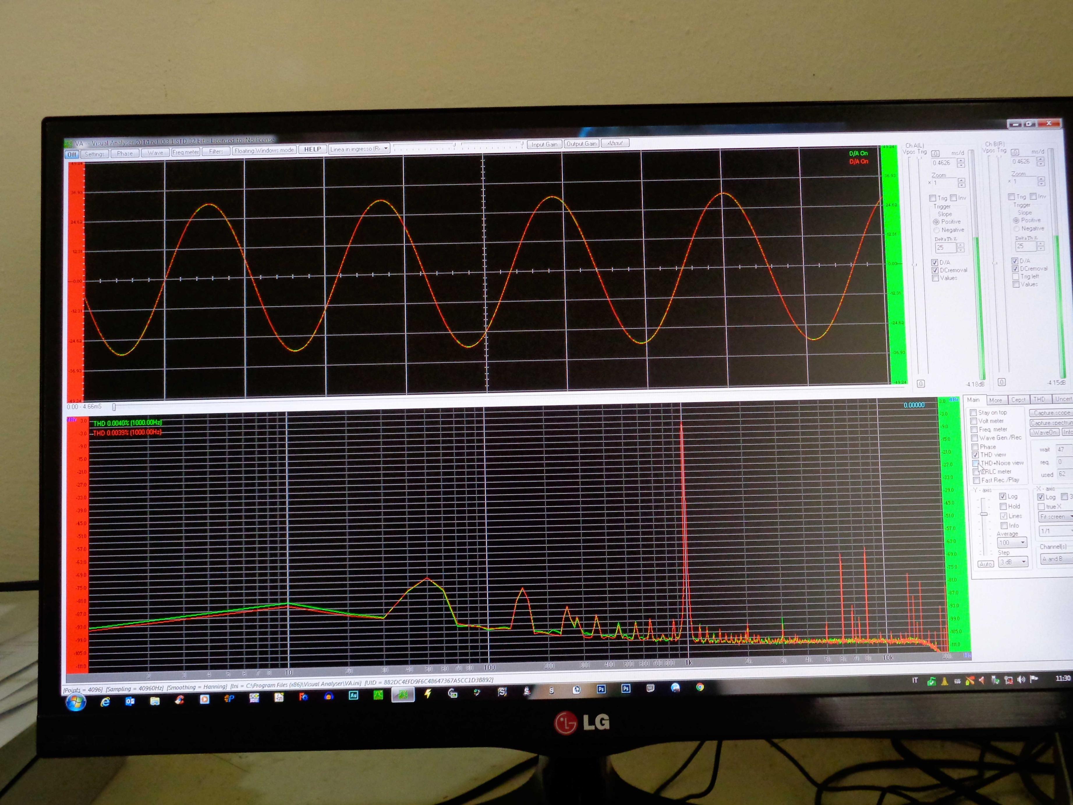

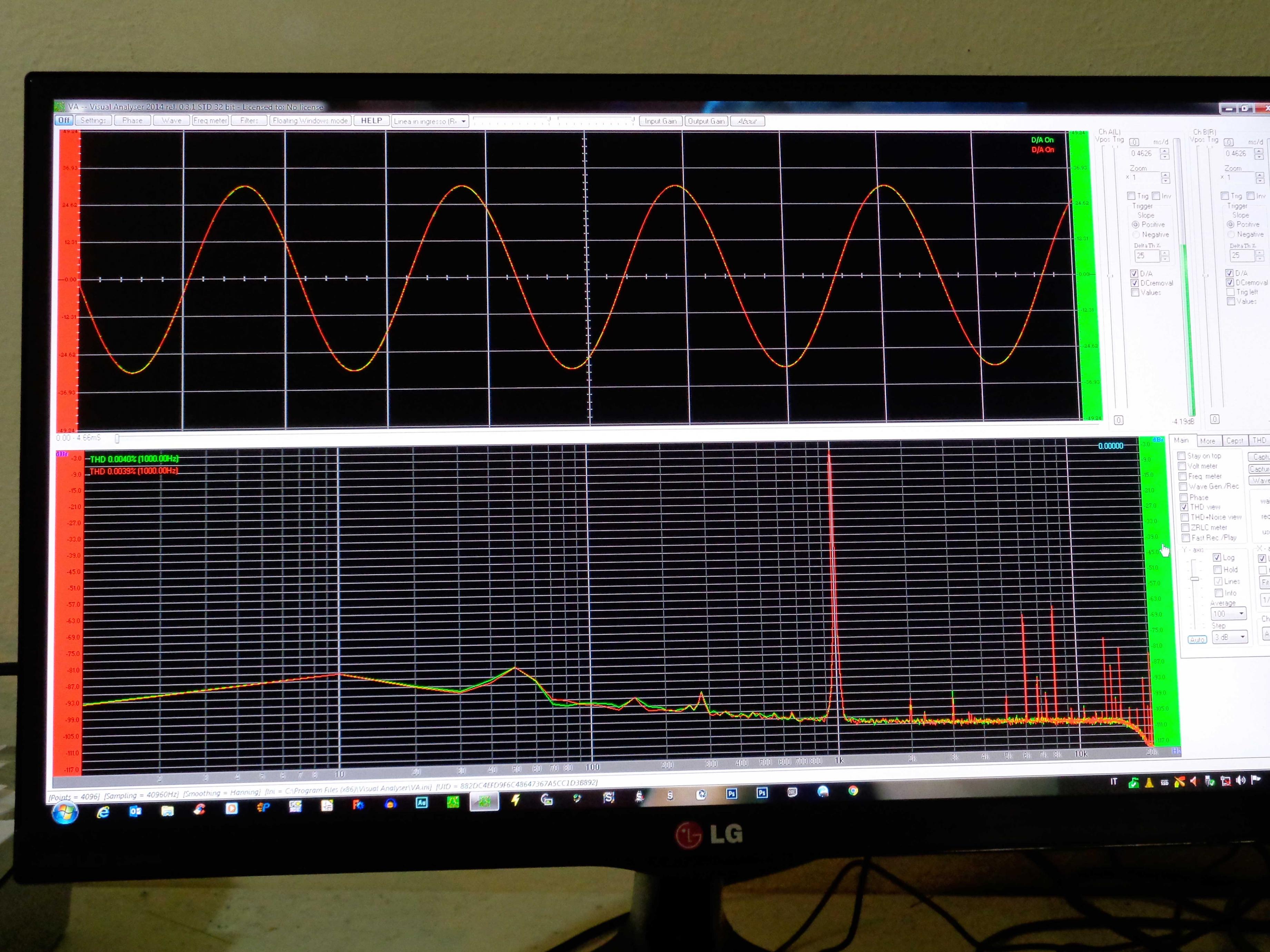

I accidentally analyzed the DAC-X6 of the audio FX, and I realized that its original power was to be thrown away in the toilet.
I bought an IRM 10-12 from digikey and almost nothing has changed, madly I wanted to try with the classic power supply consisting of transformer, bridge, electrolytic 470uF and things have changed not for the better but I would say that FX- X6 is reborn, needless to say, now it sounds with a power supply made with LDO.
what I ask is to know what can be done to eliminate the defects from the 10-12 Irm and also what is the best integrated to use to create 12Volt DC without harmonics.
as usual I ask you to help me.
I attach the photos of the spectrum of Irm 10-12 and also that of the bridge + 470UF.
however it seems to me that others have had the same problem, so how did you solve it?
