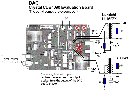

Hi audiorado, I think your using the LL1527. I will assume 1:1 Line level configuration ~ 800 Ohms primary. Take a multimeter set to low VDC. Measure the output pin of the DAC or DAC side of the electrolytic capacitor to ground. You may see anything from a Volt to mV's. If you get a few milliVolts's. It should be possible to use the transformer without the capacitor. Otherwise, I have used 10 uF Polypropylene capacitor with 10 K Ohm series resistor to the transformer. Good bass too. Let me know what you measure, check both channels. I can draw that up for you and post the wiring. Hope that helps. Dave

DAC CS4390+lundahl LL1527 passive output

...sorry for late response,I was on holydays and just came beck home.Thanks a lot for al your help.In the next days I will try the option with my lundahls LL1527 and TDA1543 and see what I get from this combo.Your instruction are verry verry helpful,and many thanks for your help.In the min time I have buy some lundahls LL1690 to.
So I will try the diference between the LL1527 and LL1690 to.
But becouse the LL1690 seems to be bether becouse thay have amorphos core I will try to sell the LL1527 tranys.
